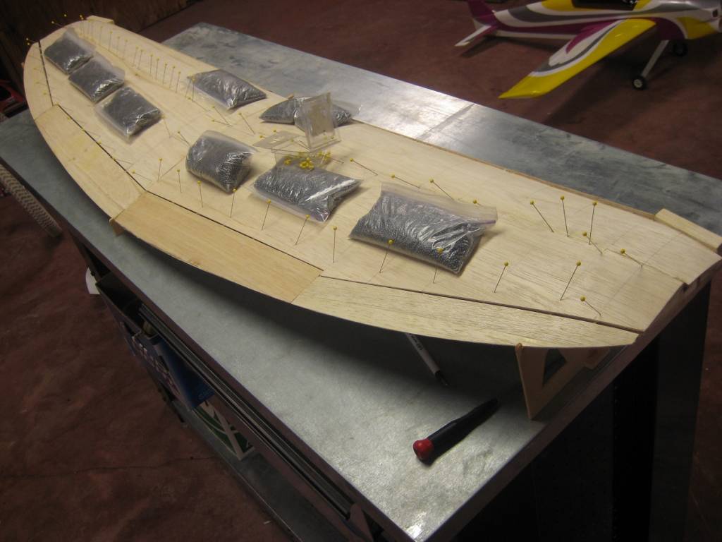

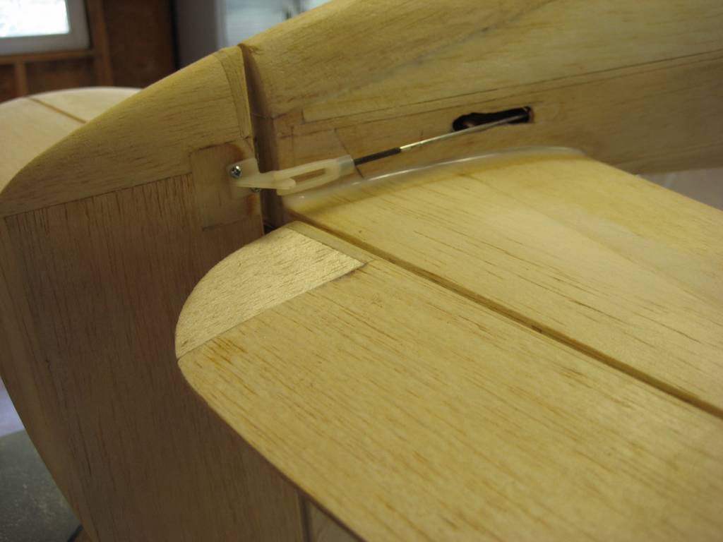

    RE: Topflite Gold kit P-47

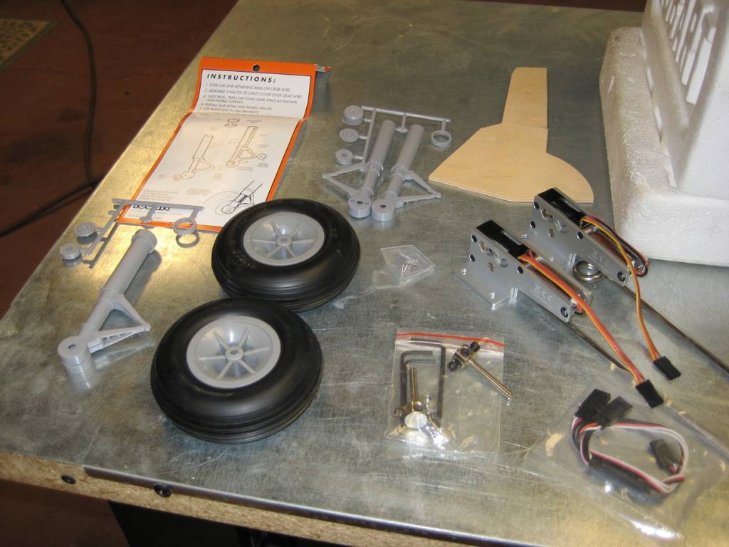

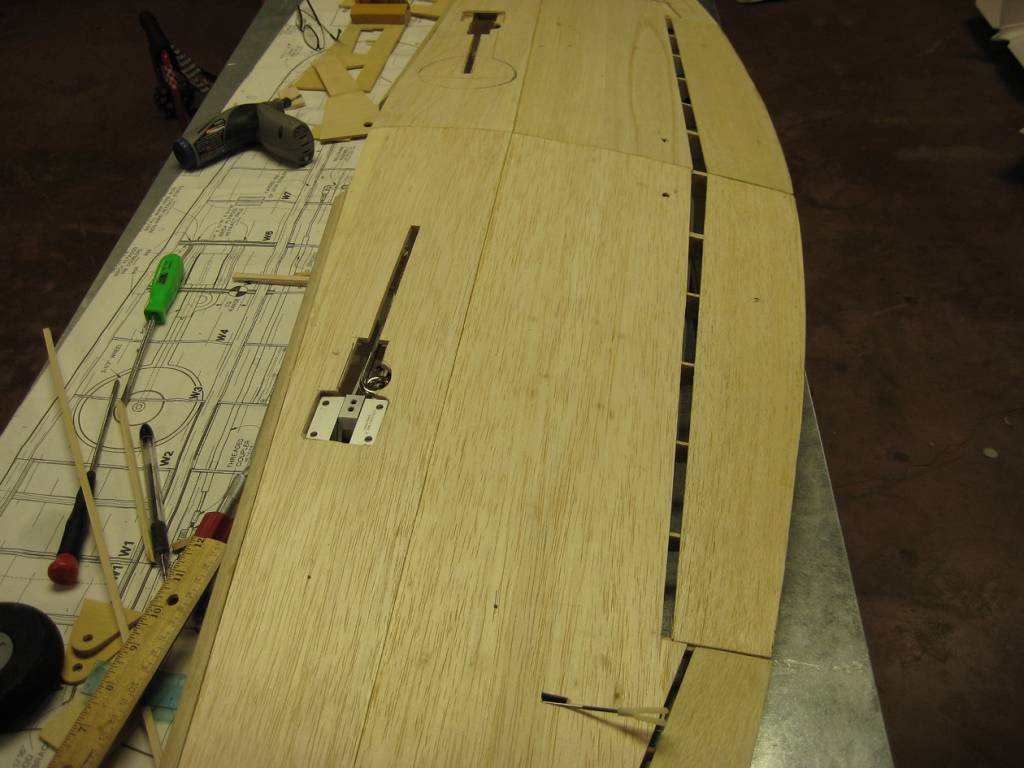

    Nice work Jordan, looks like she's ready for the sky!
    kiwibob, I think the straight struts are going to give you the most scale look.
    I got my E-flight retracts and they are very nice! Unfortunately they are not "drop in" like the Robarts as the kit is designed. They have given me some challenges, and I have had to rethink a few things. As Terry pointed out with the fixed gear, so too the mounting blocks for the retracts are not angled enough. I decided to rework the mounting area giving the blocks more of an angle. I have also decided to go with 3 1/4" wheels 7/8" wide as there isn't as much room in the wing as I thought. Probably have to trim W3 to get the tire to fit. The scale strut covers I have are a bit to bulky, so I'm doing a modification only using half of the strut cover. I finally did get the gear roughed in with the gear doors fitting pretty well too. I've decided to add the fixed gear ribs W5F and W6F for reinforcement as I had to take out quite a bit of material to get the retracts in.
    Here are some pics...
    Build well!
    Ben

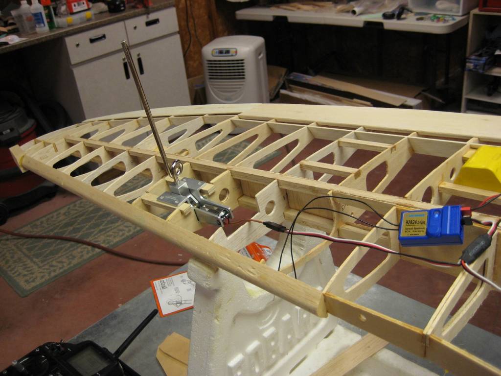

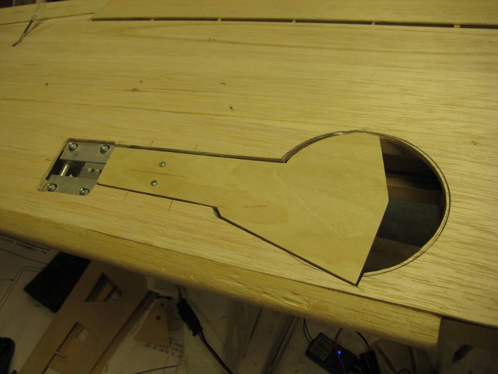

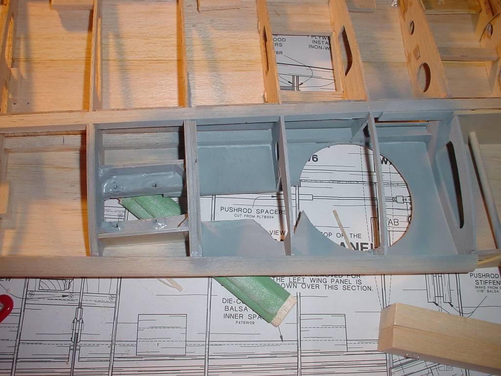

    here's what I did to beef up the gear area after the lower sheeting was in place I installed some light ply sheer webbing,I went with the century jet units and had to lower them into the wing per instructions.
    if you look closely I also installed blind nuts so I could use allen head cap screws instead of the standard wood screws it helps when pulling the gear in and out and I can get them nice and tight, I also managed to fit the 3 3/4 wheels in there as well

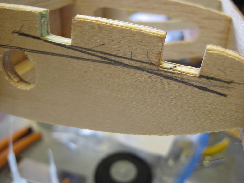

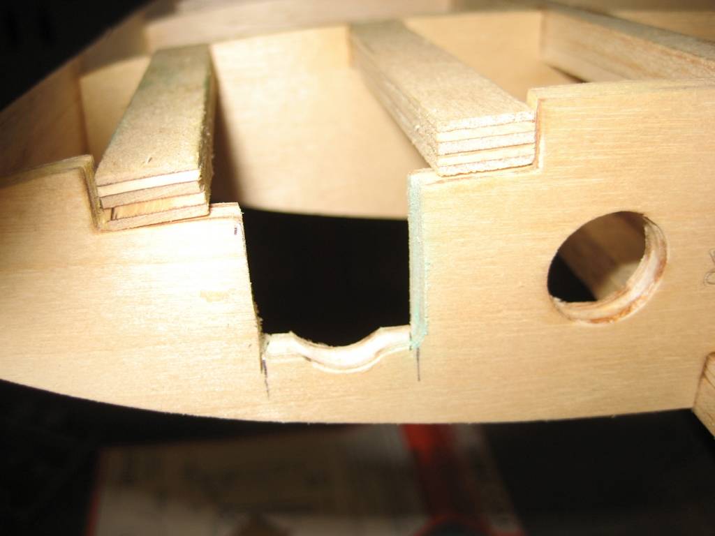

    CAUTION ! For those of you who are going to use the fixed gear provided with the kit. Make sure the axle for the tire is forward enough as drawn on the plans. My metal wire was bent to where the wheel was straight down from the torque block makeing the wheel axle 1,1/2" to far back for proper tire location. I bent the wire to re=set it forward..By leaving it back as bent, you will cause a nose over problem when taxiing or landing also can cause earily lift off on take off causing a stall..... get a good look at your plans for proper angles... very important for good ground handleing.....good luck!

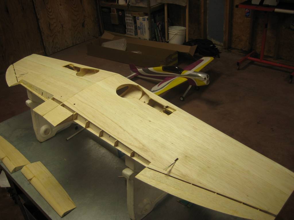

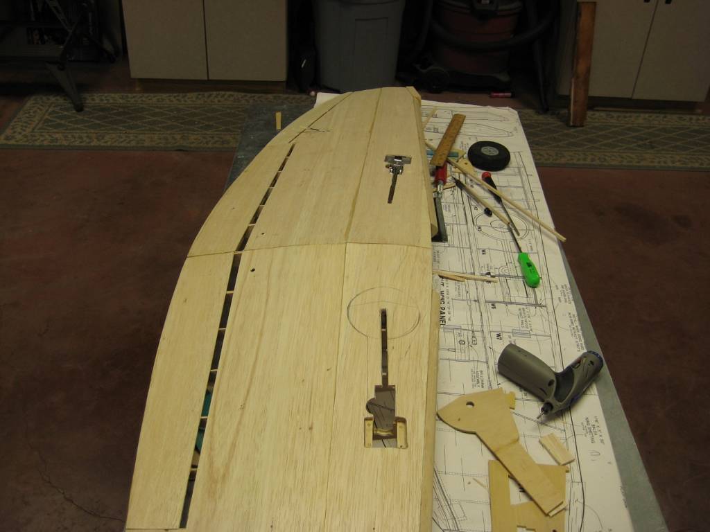

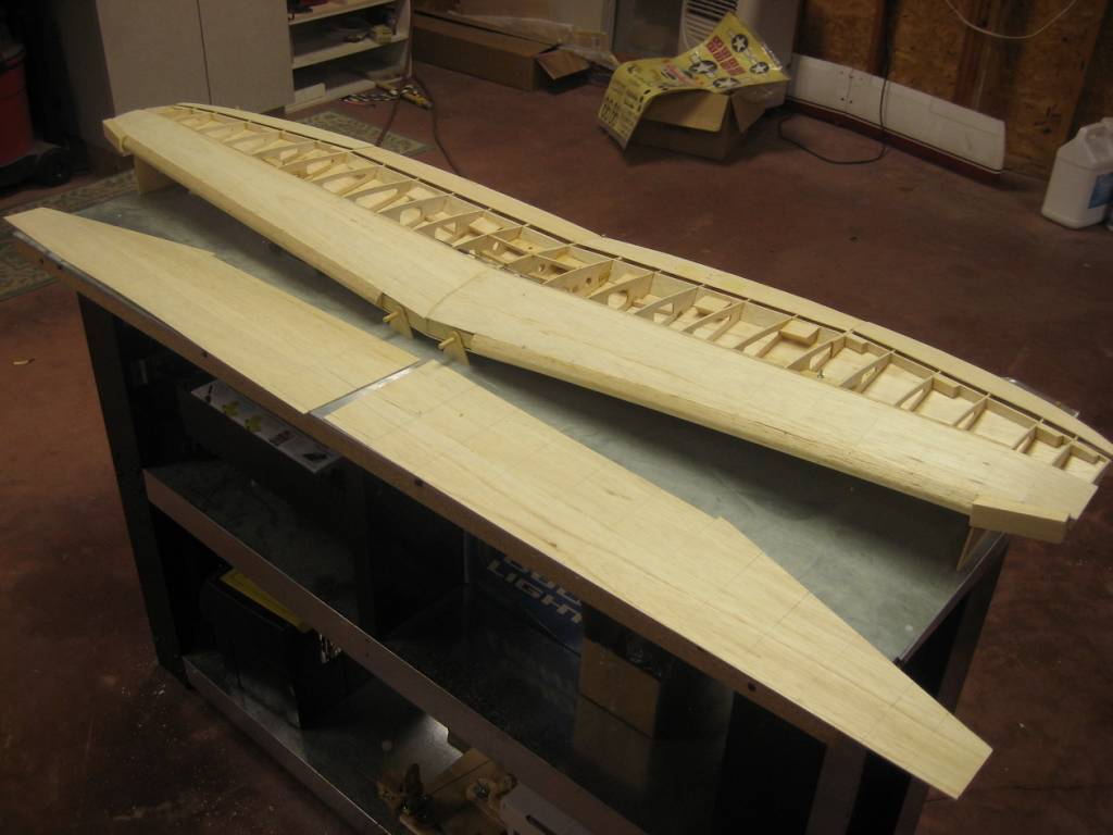

    Hey Guys...
    I managed to get the sheeting on the bottom of the wing, and have been working through final mounting and alignment of the retracts. I will use blind nuts and cap screws for attachment also, I have been able to get 3 1/2" tires to fit fine. I'm hoping I've got enough forward angle of the gear for proper ground handling. Thanks again Terry for the insight on the landing gear angle.
    Thanks to all for the input on the different ways to go about retract installation, very helpful...
    Hey Grumpy, Enjoy the P-47 build! I'll bet the AT-6 will give you some great flying experience, and I'm guessing that the Saito 1.25 will be a great engine for the plane.
    Build well!

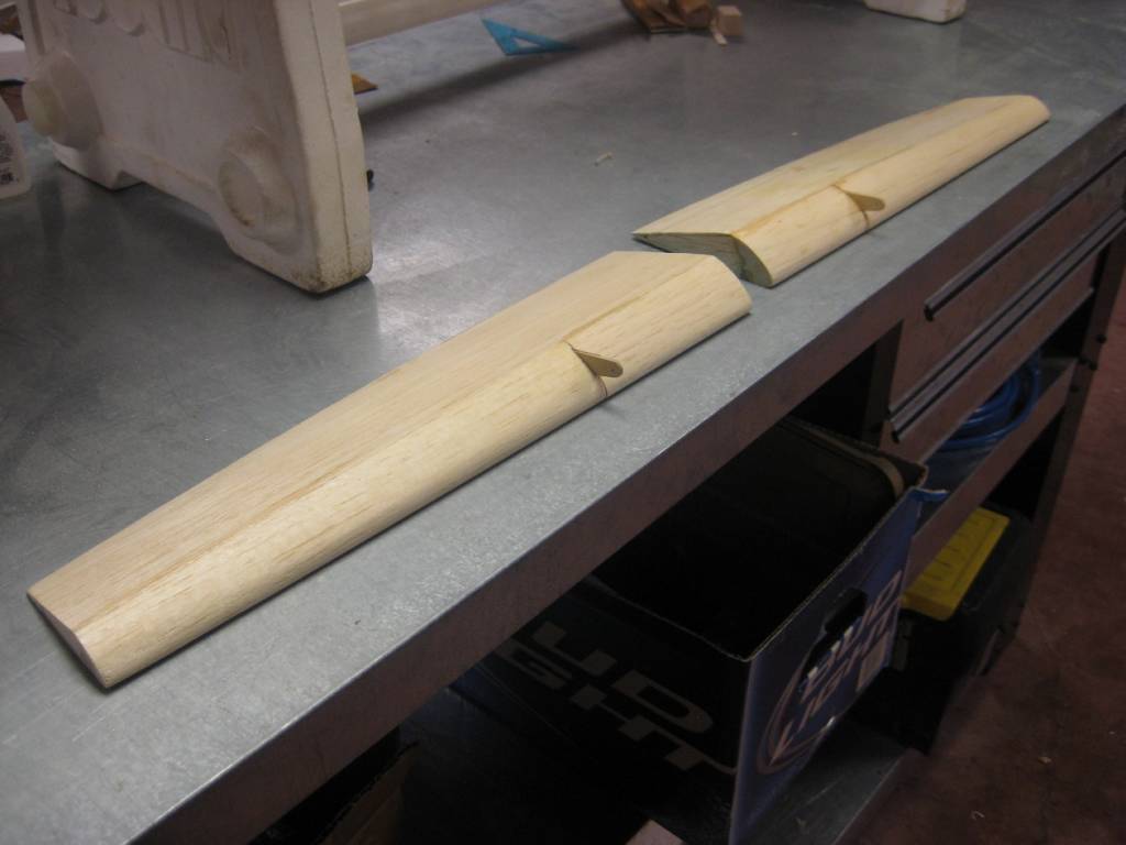

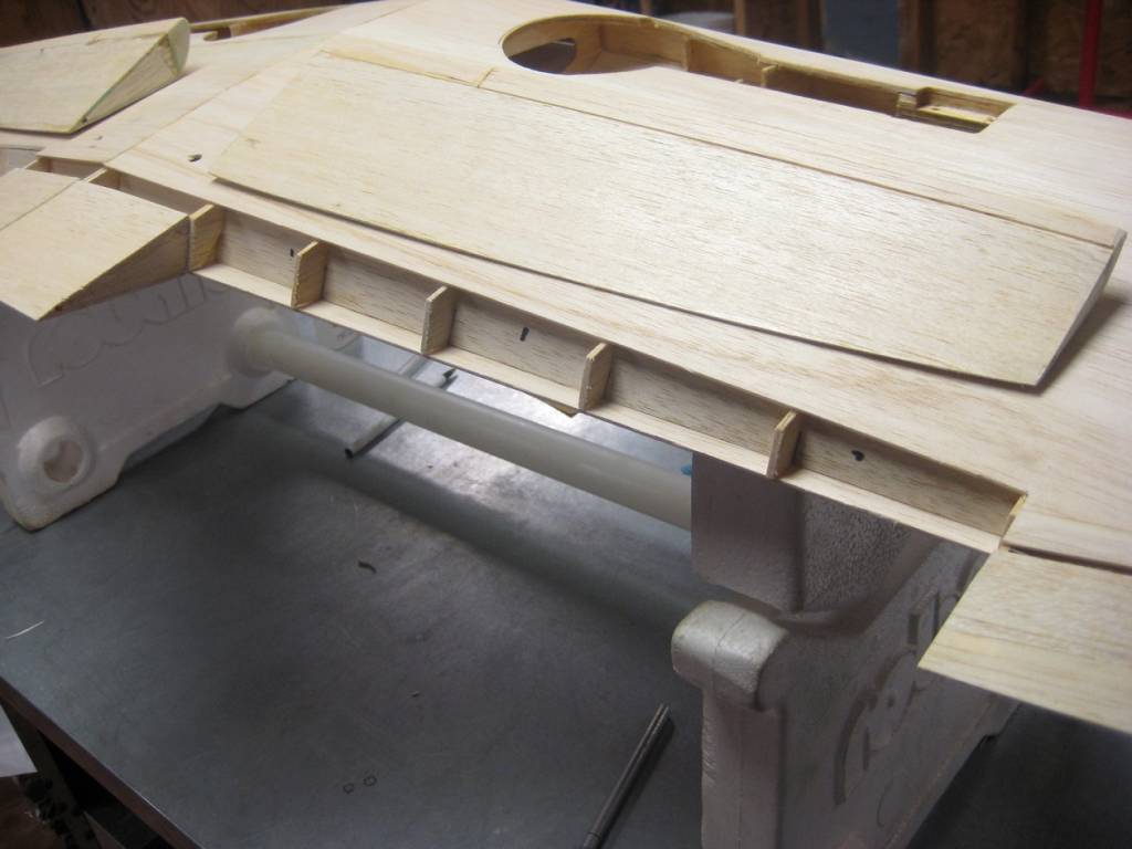

    Hey Jordan... Doesn't get any more frustrating than that[:@] Glad to hear everything came home in one piece! Maybe a dumb question, but did you convert your tank stopper and fuel lines to gasoline compatible? I tried to run a gasser with the nitro stuff and it was a big mess... Other than that I usually tighten the stopper until the rubber starts to bulge between the metal plate and the tank, not too tight though.
    I am getting the landing gear wrapped up and the gear doors fit onto the struts. Still have a little tweeking to do, but I'm almost ready to sheet the top of the wing...[8D]

    It's been awhile... I've finally got the top of the wing sheeted, the glue is drying as I type...[8D]
    Here are a few pics:
    Build well!
    Ben

    The wing looks pretty good! The jig was solid and kept everything straight and true. Starting the flaps now...
    A few pics...
    Build well,
    Ben
