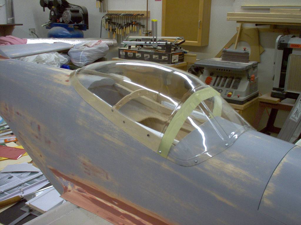

Nice looking bird. Can you post details of how you are going to do the sliding canopy?

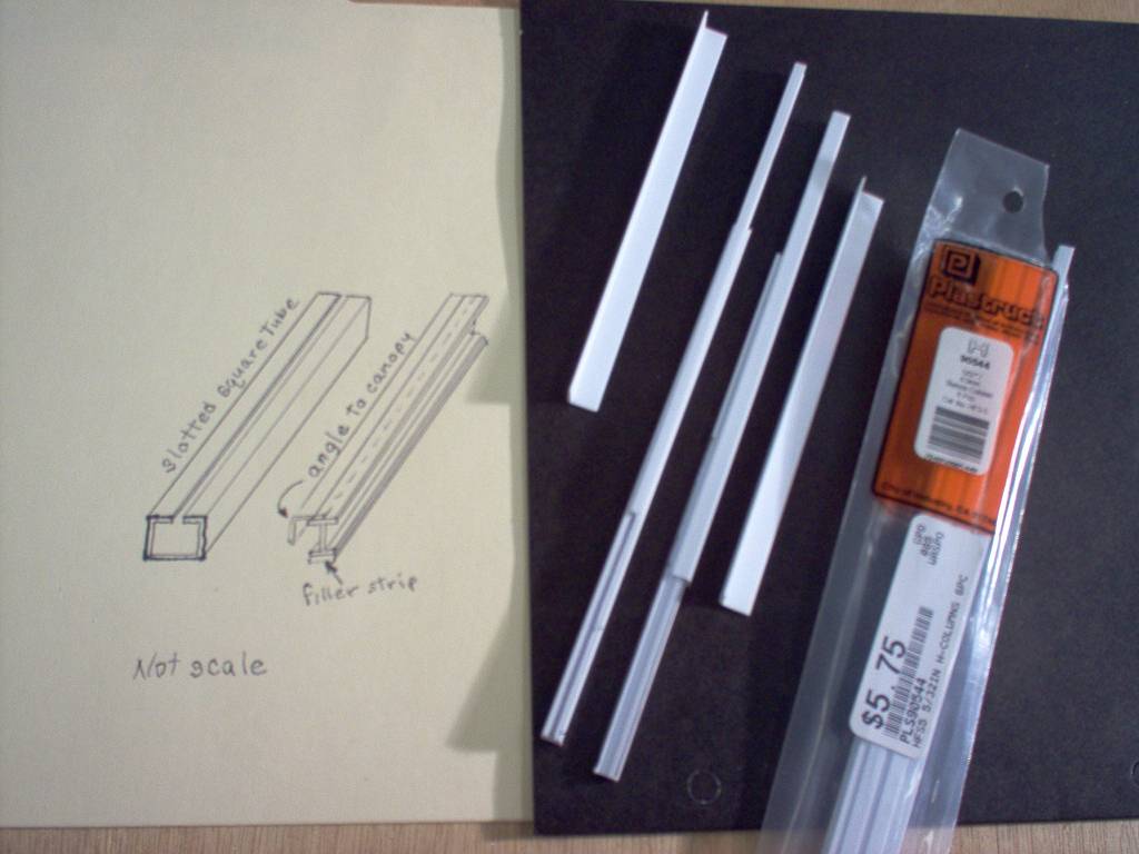

I bought some Plastistrut materials today to make the slide rails tor canopy. I was going to use brass tube but it's a bummer to split one side for inner tube to go through with the mounts sodered in it. I just said the heck with that approach. I'll be taking pictures as I go along and probably post a how to do sliding canopy. Alot of guys may have an intrest in that. I'll put some on your build site just because you asked.

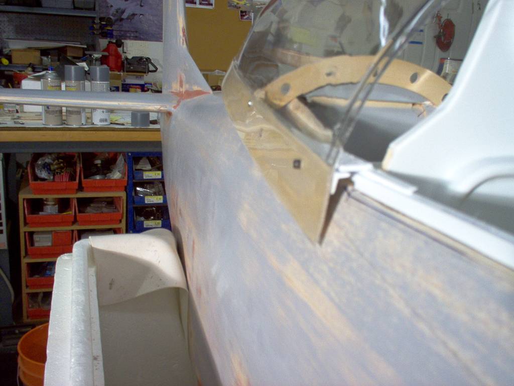

Well sebo I guess I'll do the slide for you. I made the rails today, reshaped the cockpit cut out to mount the guides on, they need to run paralle to center line of fuse and each other so canopy slides straight back, not at a upward slant. They also need to be square with each other and exact distance apart. Length of mine are 5"and 3/4" long and fit flush to instrument pannel and will slide 4". I'll explain more about that when I show them on plane with canopy seperated from wind screen and mounted. There are steps to follow in doing this. My canopy will be manually operated and will not incorporate a rear slide which could be added for actuaters. 2 hidden screws 1 ea. side midway will keep it shut, open is for static shows only and screws can be quickly removed. Personally I think the rear slide takes away from the fact the real plane dose'nt have a slot there. My tubes are only 3/16" square. I want it to look as real as possible.

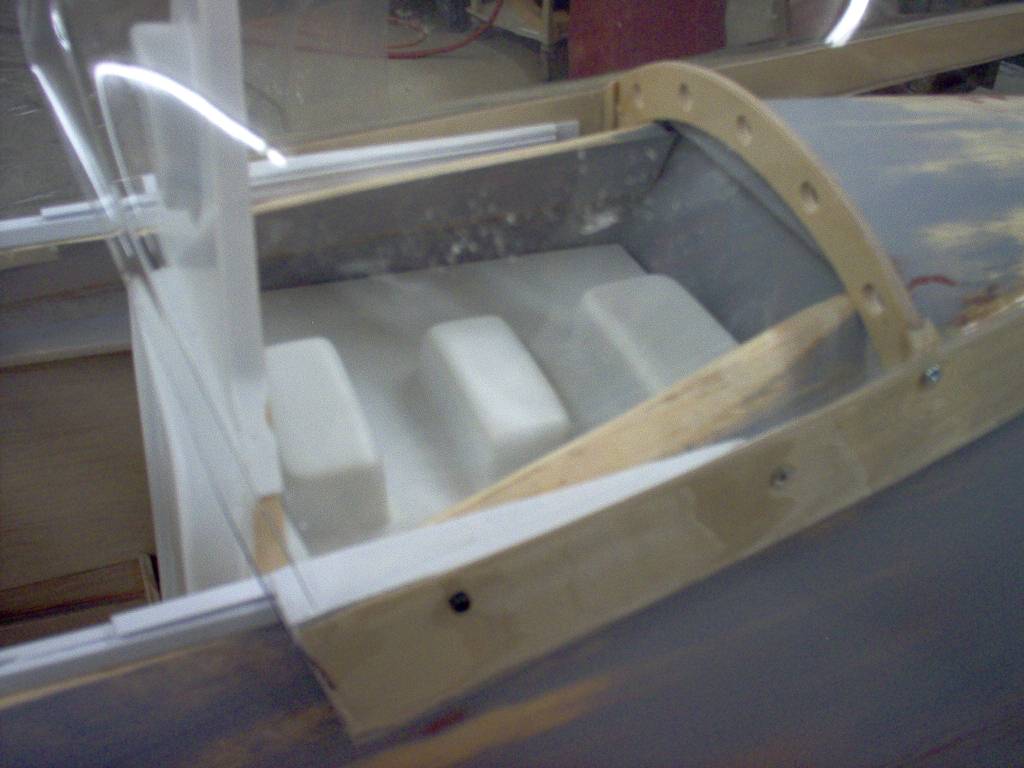

Sebo, I got something for you, my well thought out see if it works paid off. Bill you have so darn much experience it's hard to believe I could show you much, more like you could sure show me a thing or two.I have learned so much in the last 5 yr's, from so many of you I can't count ya all. Always more to learn, and do if your willing.
Well the canopy started out just an idea. Sure you can buy all kinds of stuff for your planes, sliding cockpit, gear doors, cockpit kit and much more, after all it's just money and money and more money. Enough to buy another plane in my case and I like building, gives me things to do.
I mounted the canopy slides were on body and location was marked. Wind screen is held on with 6 screws and you'll notice brace is mounted in canopy. Then canopy is seperated from wind screen. "Oops, I glued the canopy slide mount in first and waited 3 hrs for it to set up, then cut canopy. Then it did just what it's suppose to do. slide straight back. The beauty of the whole thing is it cost about $26.00 not $126.00. It slides very smooth. Just some minor things to do to finish it up. Really isn't that hard to do so figure if you guys are building scale and semi-scale kits and RTC & ARF's you allready have the skills to do this kind of work. Like I said , I've learned alot on RCU. Leroy
