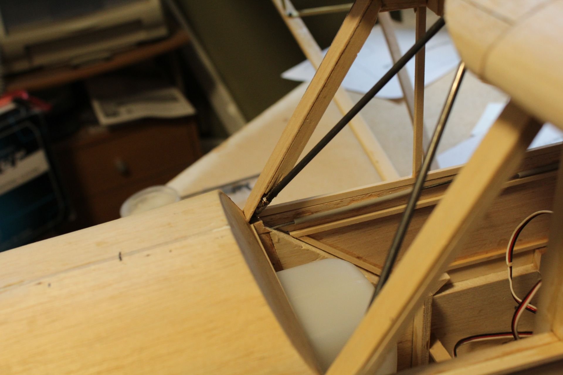

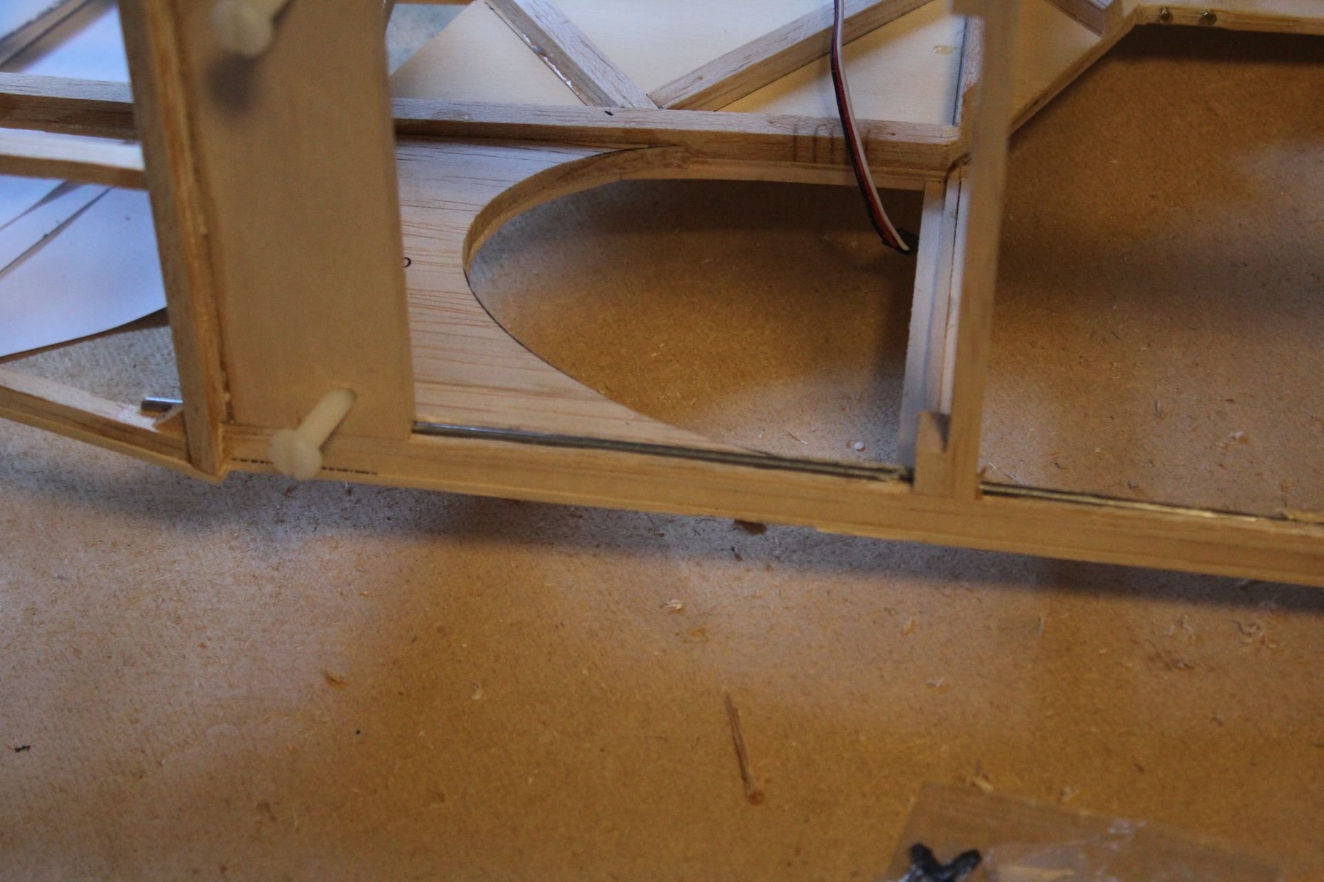

Originally Posted by Cub Man View Post
looking good. I feel the wire in the top adds a lot of strength to this setup. as always ask as many questions as you need to.
Thanks Cub Man!
I know there's been 1/4 Scale J-3 Cubs that's had the door & window cut out as an "afterthought". Once you do that your committed to completing the door/window modification. I have started doing the reinforcement, not sure if I understand all that the Cub Den has suggested doing, but I am going to try their suggestion, it's not going to be easy. Drilling along side the 5/32 wire, is almost imposable, I've tried. In fact, I'm thinking of soldering the reinforcement 1/8th piano wire to the 5/32 cabin wire. I'm not sure of doing that, but thinking of trying it. I'll take pictures as I go and post them here.
I would still like to hear from people that has done that or just any kind of reinforcing the area after cutting out the door/window area. Maybe some folks hasn't reinforced this area at all and the cub is still flying.
Let me know!
Gerry

Originally Posted by wetbird View Post
Hello Igoren, so the cubs you have, did you build them and if you did, did you build in the door & window as per the plans instructions or added the door & window after the fuselage was built, as I did? The Sig kit 1/4 scale J3 Cub, has the print of the door & window on the plans, but no mention or instructions on how to go about building the door/window. I cut the door & window out, knowing I would be cutting some important bracing for the wing. You're saying there's no reinforcing necessary after cutting through the plywood reinforcements and at the windscreen area? Without adding some reinforcements after cutting these pieces out, I would be afraid to do a loop, for fear of loosing the wing.
So, from the Balsa USA plans, no extra bracing required per plans. All the structure is made of spruce. I have seen a few fly per plans build and fly fine. Now a few words from the Cub Man. Without any reinforcement, you are depending on some but to but glue joins for strength. I would say most of the strength come from the front wire support in the center of the wing and where the top section connects to the back of the cabin. Adding the 1/8 inch music wire adds so much strength to this area. For me personally, flying without the wire and relying on some but glue joins is scary. I will say in the 20 years my scale cub has been flying, I have had a few accidents that I know if the wire had not been in the cabin, I would have had to rebuild that area.
Cub Man is offline
Reply With Quote
Old 12-05-2018, 12:03 PM
  #4264
wetbird
wetbird's Avatar
Join Date: Apr 2010
Location: Fresno, CA
Posts: 95
Gallery
My Gallery
Models
My Models
Ratings
My Feedback
May I be added to your group?
I'm 70 yrs. old, been building & flying kit airplanes since I was 12 yrs old, but in those days, they were U-control. After getting out of the military in 1970, I started building RCs. Just a little about my early years of RC flying & build. In the last 20 yrs, I've been flying GP 60 size J 3 Cubs on floats. My current build is the Sig 1/4 scale J-3 Cub. I'm limited in space for building large RC planes, but I've always wanted to build a 1/4 scale cub. This is when I came to you for a little help when adding a door & window to my already built fuselage.
I did want to install a 5/32 wire as suggested, but install a 1/8 piano wire instead, I wasn't able to drill a 5/32 hole along side the already installed 5/32 cabin wire. So using the 1/8 wire after sanding, I soldered it to the cabin wire. I think this will do the trick, I hope. I have photos to share. I'm so sorry the photos are so big. I did cut a grove along the top for the 1/8 wire. after sanding and installing the wire, I 30 min. epoxy the wire in place, then sheeted over the wire to hide it. When I finished the 1/8 wire reinforcement, it's hard to see the soldered wire.
Thank you for your help, it was greatly appreciated!

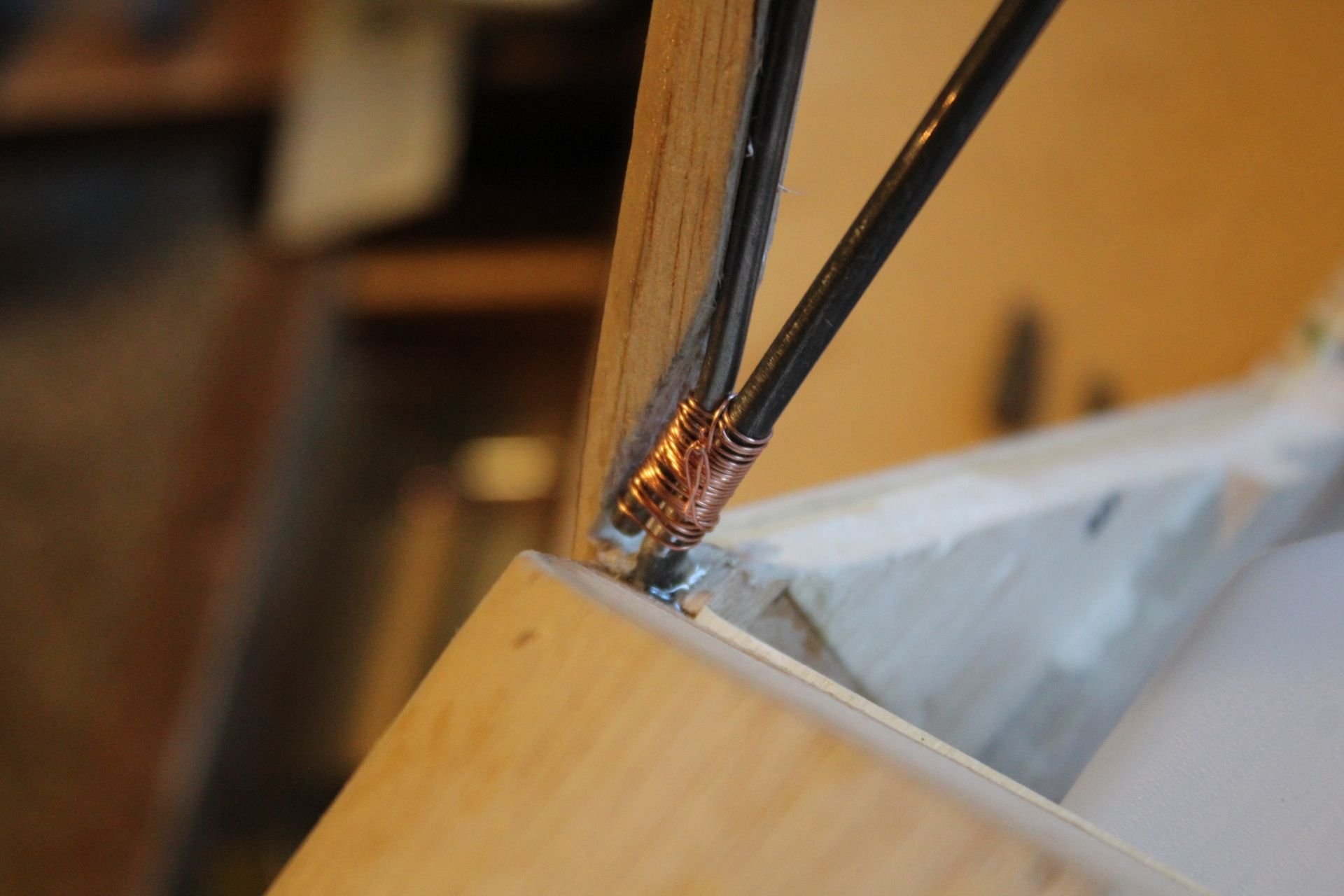

I didn't attach photo
of the 1/8 wire just after it was soldered to the 5/32 cabin wire. I used a torch to make sure it got hot enough for the solder to adhere to the wires.
Gerry
