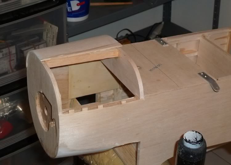

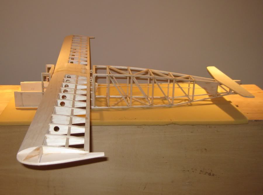

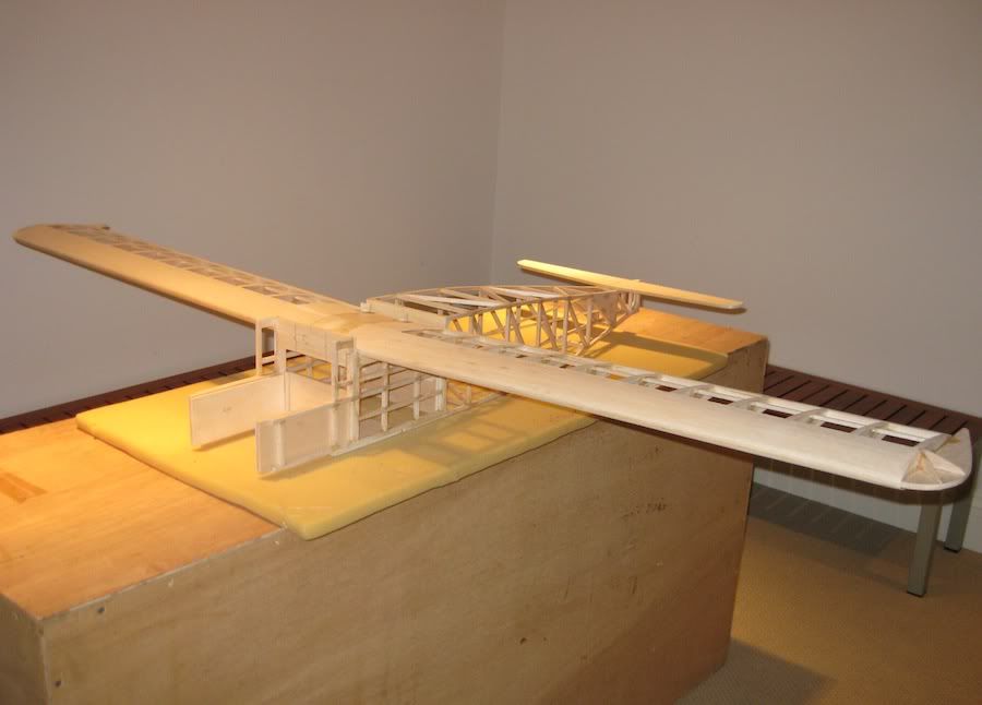

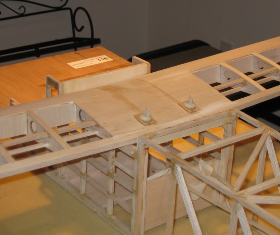

I'm framing up a Unionville 6' Otter for a club member and since it's not a commonly modeled subject, I thought I'd post some pics here.
The wood quality in the kit is very good, but this must be best described as a "builder's" kit, since very little is done for you. It's really more like scratch building with the ribs cut out for you. I also am making several mods to make the plane more reliable to operate and set up.
I sacrificed scale appearance in the stab mounting area in name of safety. The recommended method is failure-prone IMO.
The plans call for rubber bands, but the owner requested a bolt-on wing system
The wing is ready to cover minus the center section fairing, while the fuse still needs the firewall installed as well as all the bits that will give it a rounded shape.

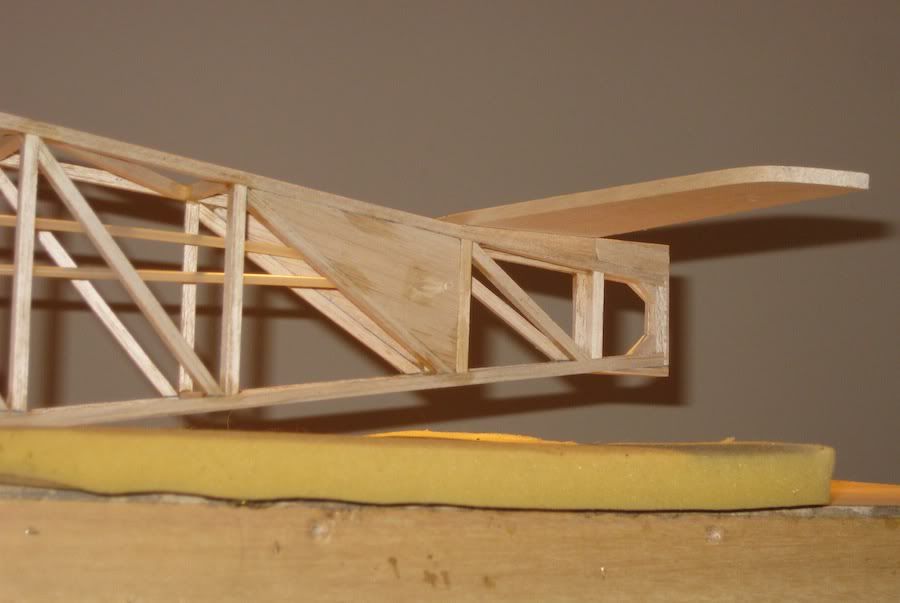

The construction of your Otter is typical for a kit built model of this type. I enjoy the process, myself.

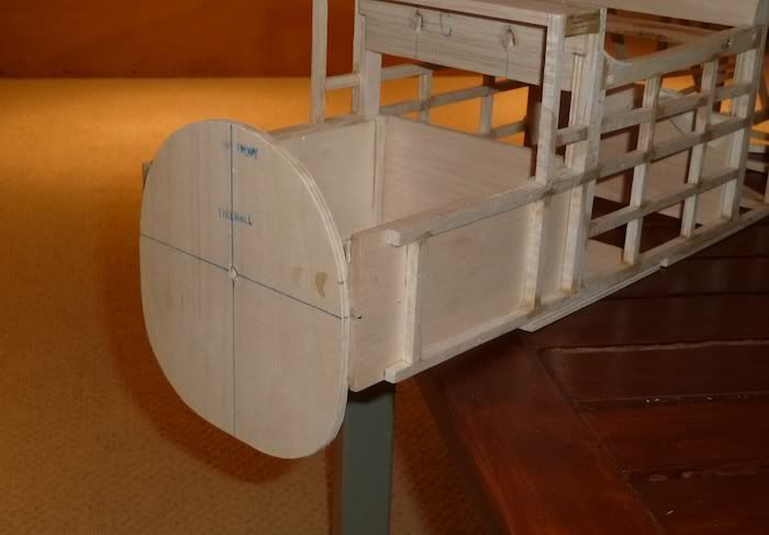

Here's an update: I mocked-up the fin/rudder. Boy the sucker is big, see standard size servo for scale.
Built the wing fairing to blend the wing to the fuse. A little fiddly to get right, but balsa is so forgiving. Mess up, glue another piece on and sand again to fit!
Firewall installed. This one had me head scratching for a while, because you have to figure out exactly where it should be placed. Using the plans, I marked the engine thrust line on the fuse sides and on the firewall. Once that was done, I had reference points to make sure everything lined-up as it should.

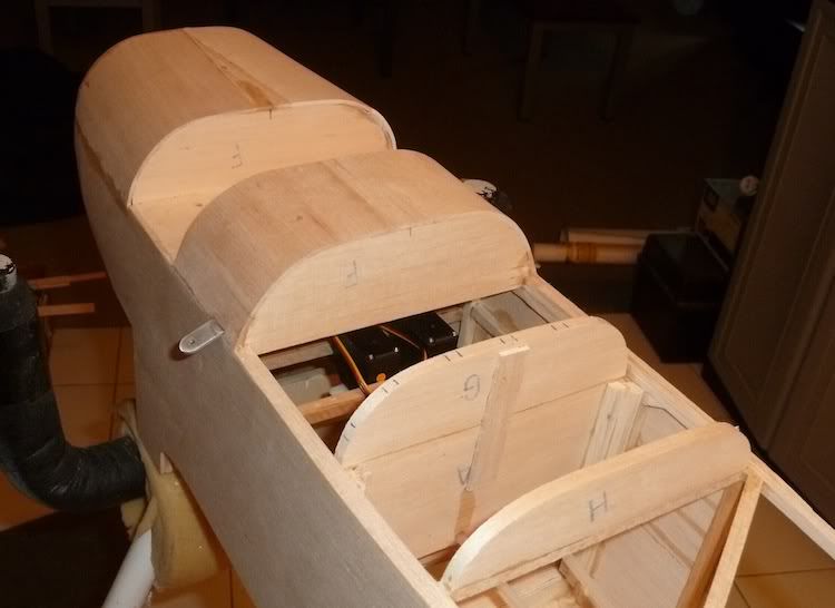

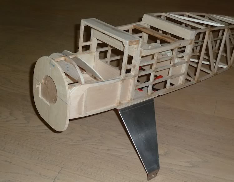

Not much apparent progress today. In a sense I actually moved "backwards" a little after determining that the supplied engine would never fit into the cowl with the stock firewall setup. The only solution I could see was to recess the engine mount which meant cutting into the freshly installed firewall.
The engine is mounted in a way to have the exhaust come out the bottom of the plane and position the cowl cut outs in a position that will be less conspicuous. I also cut away part of the engine mount to allow me to slide the engine back as far as possible. This setup will place the engine inside the cowl and have the prop about 1/4" past the nose.

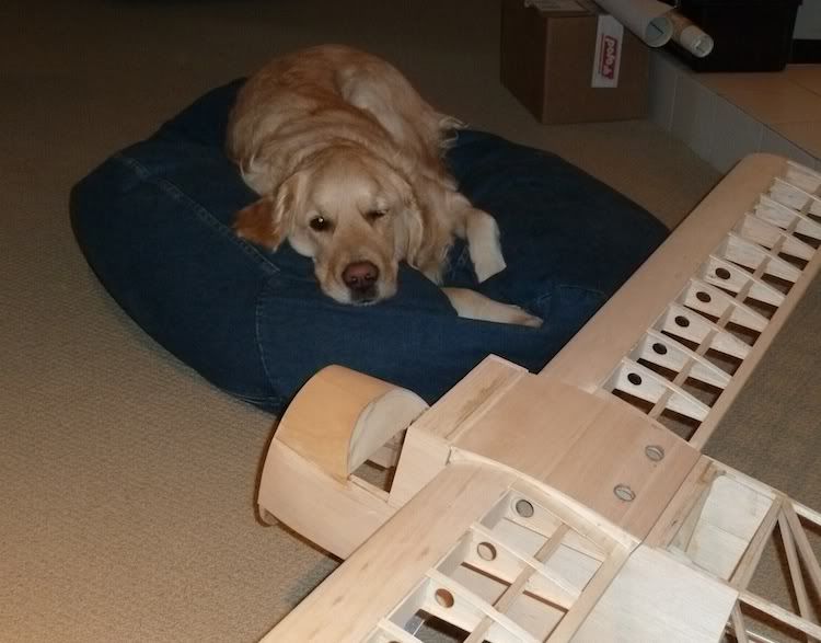

Made some progress last couple of days.
Carving and sanding then sheeting the nose section proved to be the most challenging part of the build so far. The sheeting conformed to the compound curve at the front once I had it soaked with water.
Pooch, however, is not impressed.

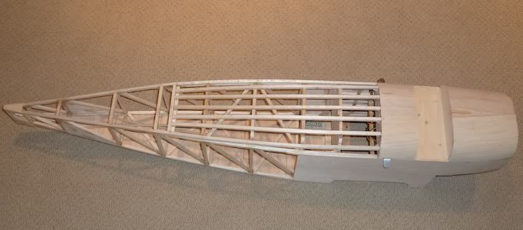

Thanks Prr6100, I got a fair bit done in last few days, the fuse is basically ready to cover.
Firts I assembled and test fitted the tail feathers, look at that rudder, boy is it BIG.
Next I started sheeting the bottom of the fuse, which was fairly strait forward. Note the use of small tabs to help locate the sheeting along fuse side.
Next, I started installing the formers running towards the back of the plane and here is where I encountered a slightly annoying problem:
The formers aren't sized correctly, so that in order to get the stringers to sit properly, they have to be ressessed into some formers, while over others, they have to be shimmed. Not difficult to do, but quite fiddly.
The end result was pretty good, I think.

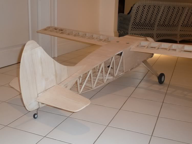

The request by the owner was for a frame-up job, and the plane is now ready to cover.
Here's the strut setup. In the close-up pic, note fiberglass applied to area where the strut meets the wing. This will make it more ding and scratch resistant.
And the completed OTTER in all its glory
Oh, one major deviation from the plans was the use of an aluminum landing gear. The kit comes with lengths of 5/32" and 3/32" music wire that you have to bend and solder yourself. It was a lot easier and quicker to source a aluminum unit.
