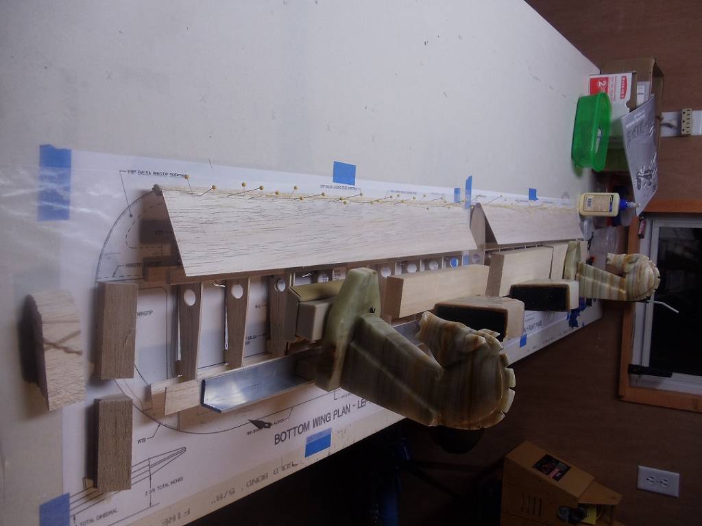

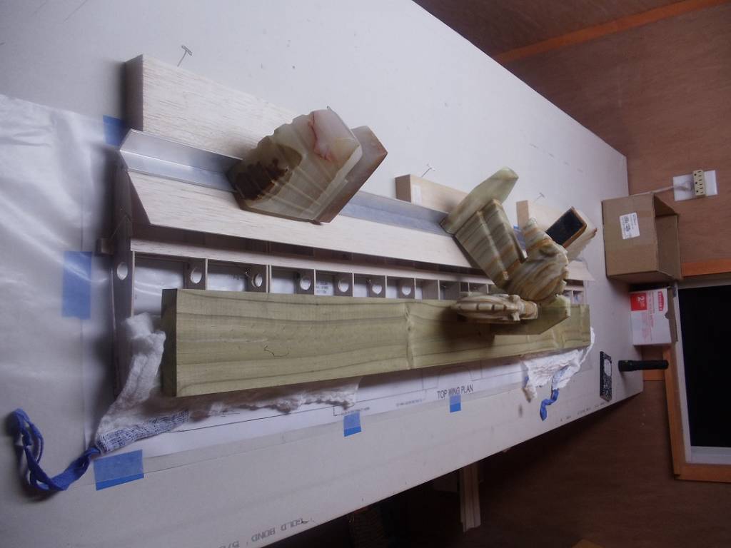

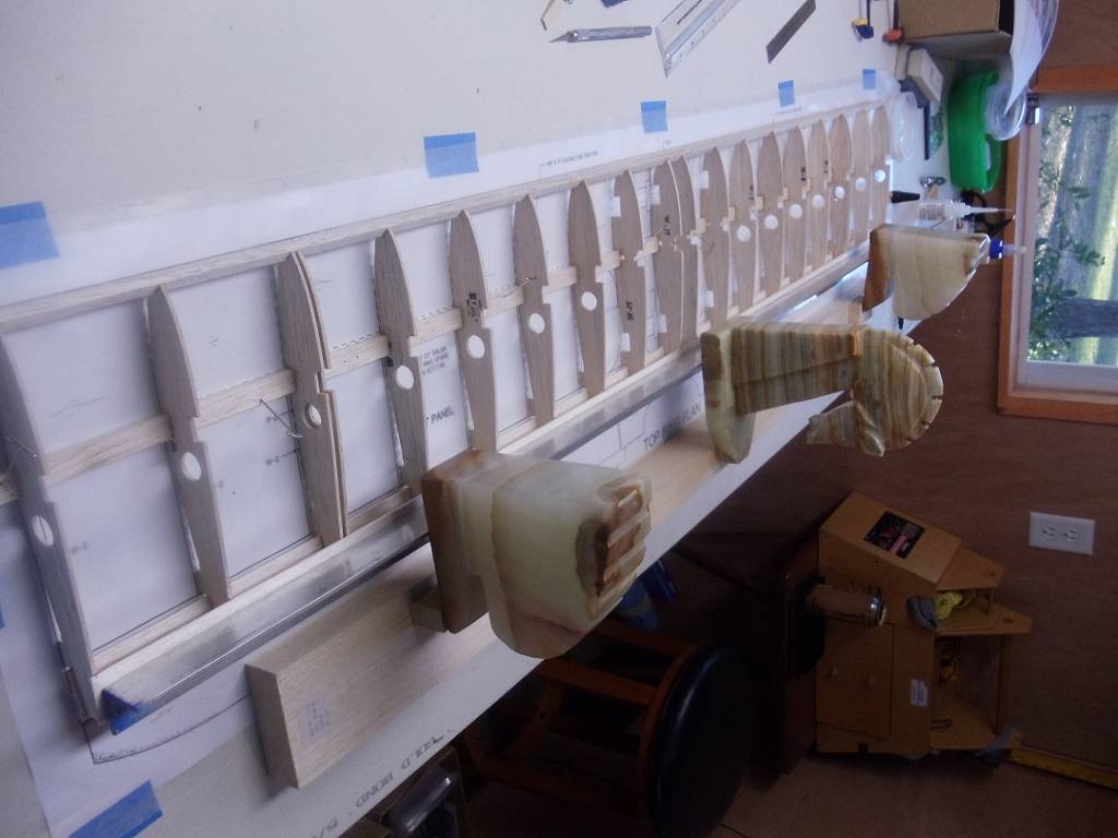

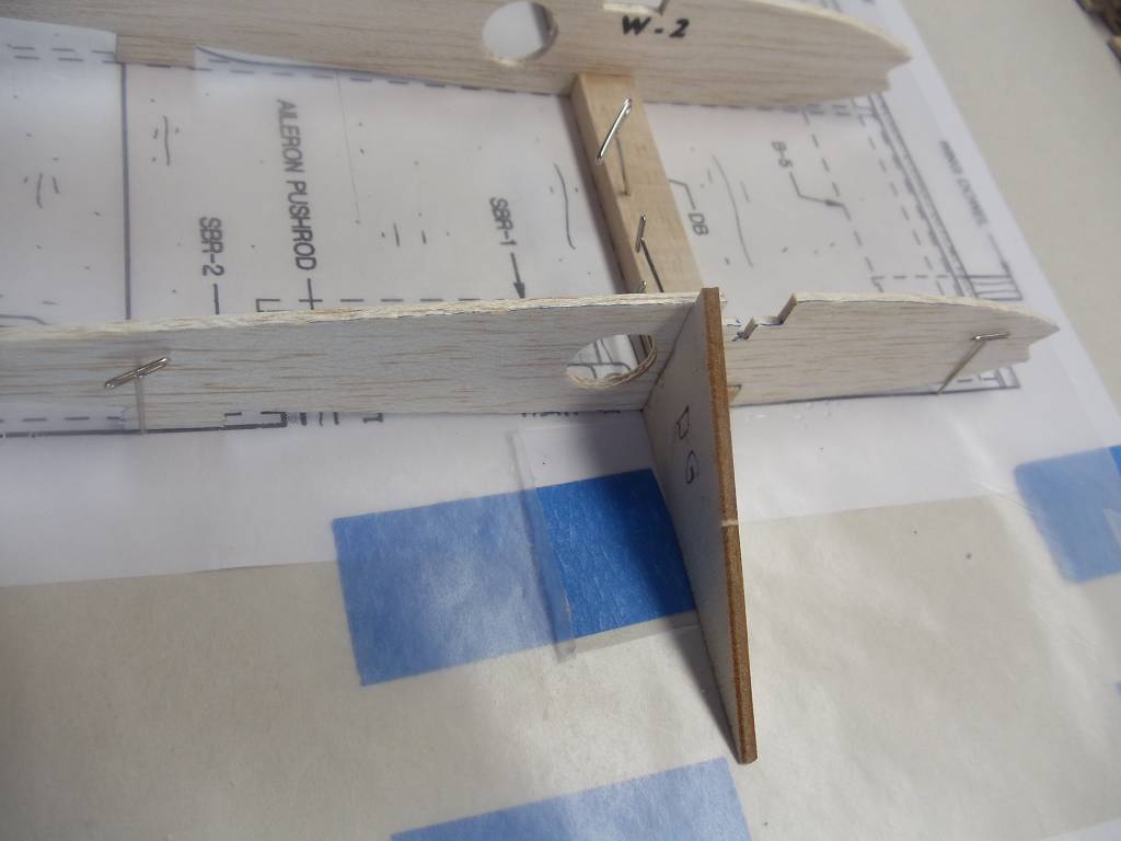

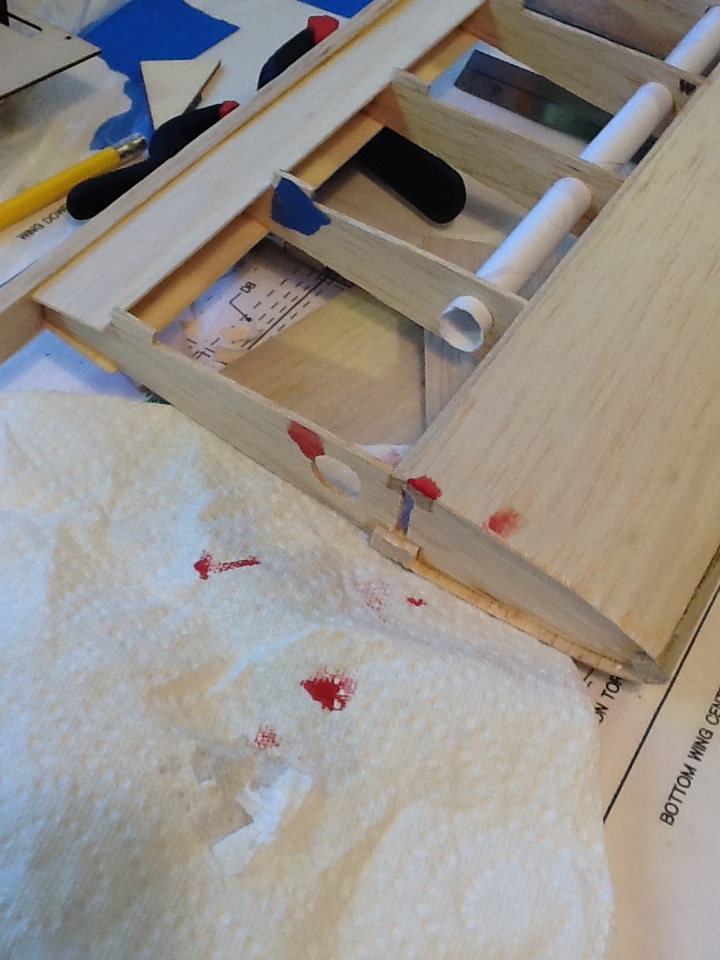

For JR.....how i went about the ticklish process of getting the root ribs in the lower wing halves positioned...A critical step.....I pinned the gage to the rib itself and then dropped ithe assembly into position prepared with t pins set on the plan line. When i got it where it need to be, i welded it to the lower spar. Be sure to double check that you don't shift things when you add the upper spar. Hope this helps.

LOL it is easy to build one of these things, just sit down with an exacto, a chunk of balsa, and just open up a vein...........

Looking through some of the build pictures tonight. A piece of 1x1 aluminum L bracket a couple inches longer than the top wing, a little over 4 feet, long, was one of my most reached for tools. Made every thing straight and flat................Will have to upload pics in the morning

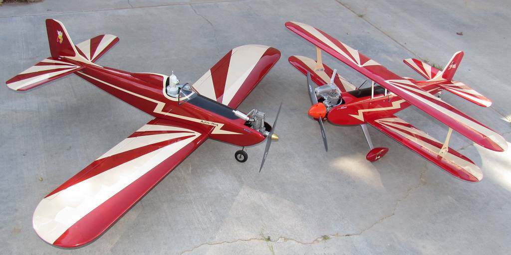

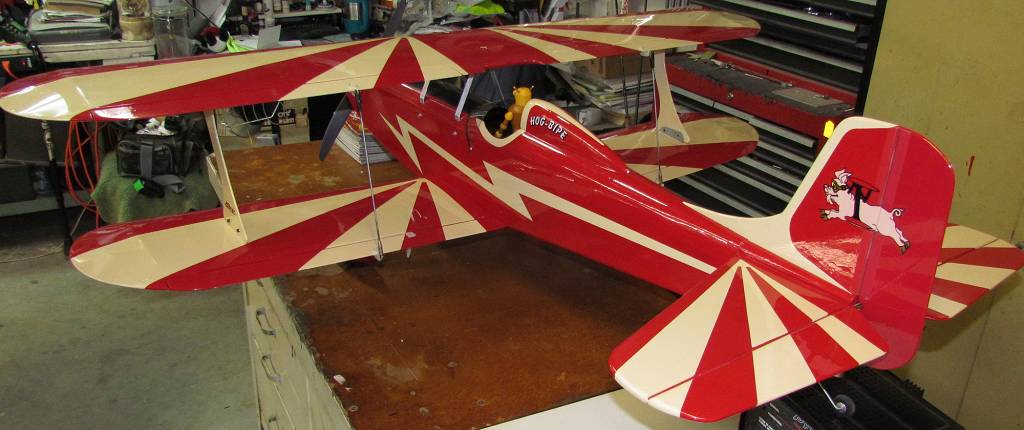

Hey guys I thought I would update you all, my Hog Bipe is complete! I did an engine run and the 95 AX runs sweet and very quiet. I wanted to fly tuesday but we have been having high winds here in So Cal so I have to wait until a decent day. I just used the graphics that came with the kit on the tail, in fact the whole covering scheme is box stock really. the only thing I did different was put some checkers on the bottom wing for fun. I need to take some good out door pics and some with her sister Astro Hog too. I am anxious to fly this airplane! I went fairly conservative on control throws with a heavy dose of expo, the CG is in the middle range. I will post a couple of pics of her, not the best pics but best I can do indoors. A quick summary... I am using an OS 95AX 2 stroke with a Hayes 14 oz tank, HiTec 645 MG servos everywhere except throttle servo, dual aileron servos, Sullivan tailwheel bracket, 6 volt 2200 MAH NiMH Flight pack, HiTec 2.4 GHz with an Aurora 9 TX, and a Heavy Duty Charge switch sharing the cockpit with "Calculon" the robot from Futurama. I dont like to get too serious with my pilots Wow having a tough time uploading pics...

That is a nice classic hog!........ I know what you mean by 'complete' When you are sitting at my stage it just sorta looks built. I have a list a mile long. Plan to set my controls up the same way. Did you put a meter on the wings? Curious how yours built out in that regard. That and how it weighs in (pretty sure mine is going to be a pretty fat) Yours outta be near unlimited vertical with that much motor in a good OS two stroke.
Still have to run the glow sys wiring and a million other things. Got my radio system today and the motor is on it's way from Horizon repair from getting the case replaced from the tree strike. Should be as good as new. Nearly is, less than a gal of fuel through it before the crash. Sprayed the Minwax Polycrylic on the covering this morning. Two coats and it came out ok. Good enough for me anyway. Been kinda dreading that step. Wasen't quite sure what i was getting into.
Maybe the winds will lay for you soon Daddyo, and good luck on the maiden. Get us a video if you can!

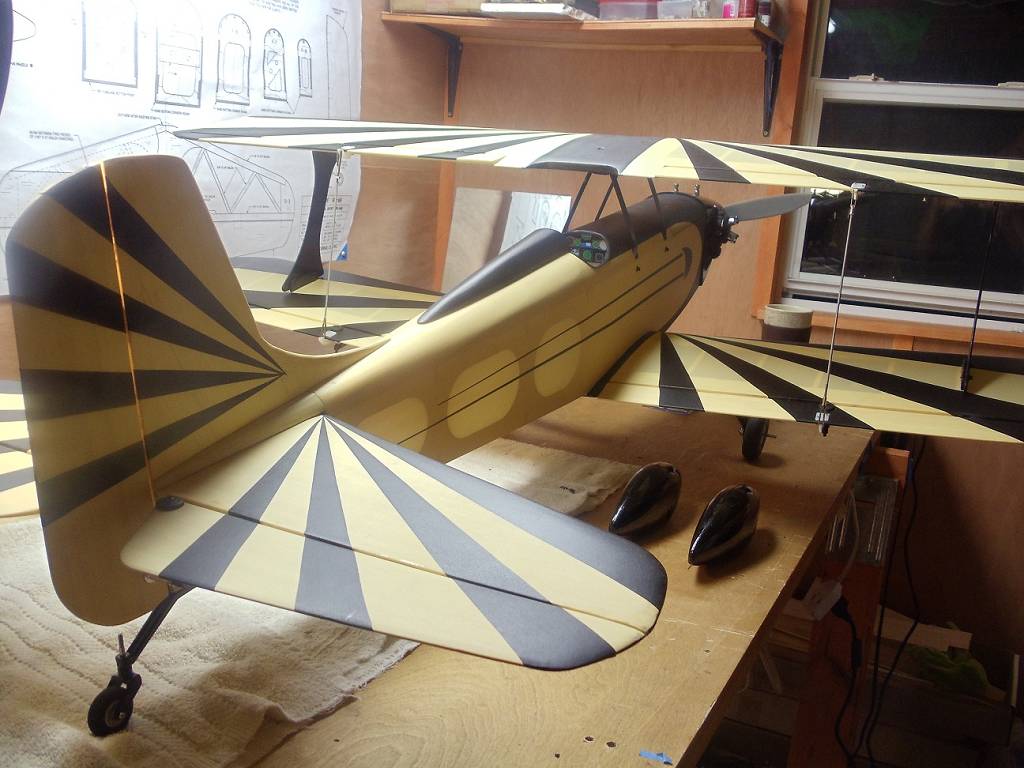

he pile of parts is beginning to look like an airplane! All linkages and aileron interconnects are installed and await final alignment. My Airtronics SD-10G has arrived along with my repaired Saito fa100t from Horizon Services. Debating if i am going to stick it on a test stand before instalation. Should be good to go with enough run time on it from the previous installation to be settled down and dependable. We shall see. Will install the new Airtronics reciever in another airplane this morning to get some flight on it before i trust a new build to it.
Have had quite a round with a H9 digital incidence meter. Very nice unit that appears to be extremely accurate They have a little battery just over 1/2 inch tall (15mm) and 3/8 inch in dia. (10) mm for power. Rated at 6v and 11 amps according to the battery label (whatever 11 amps means....never ran across numbers like that.). There is no auto off feature in the circuitry of the unit and the little digital inclinometers draw a heck of a lot of current apparently. Forget and leave the switch on, which i soon did, and the little battery is toast in short order. Found numerous references on the net regarding the problem. And all kinds pain and agony finding a replacement for the cheezy battery shorty of ordering it from Hanger 9. Folks have found the battery if they have a deticated camera store near by that carries these little odd balls. I don't have that luxury. The nearest possible source is a deticated battery store an hour drive from here. Way to go H9! Got a nice little 'Dollar Catcher' going on with part number HAN197.
I got to thinking 6v huh......well i have a new 6v 2000ma hump flight pack sitting here.....and a soldering iron and a female servo lead. Solder a pigtail to the battery contacts, hook it up and see and see what happens. And it works....beautifully! None of the smoke has leaked out and i see no reason that it will. 6v is 6v, no matter where it comes from, weather it is from a huge U boat submarine battery or a little cheezy camera style battery from China. Let the power hungry little rascal chew on the current from a good reciever pack and let it see if it can run it down!!! The only down side i can see is putting up with the wiring while running the unit. That and the unit looses calibration when the battery is removed, requiring a recalibration whenever the battery is plugged into the pigtail. No big deal....
Got a good handle on the build incidences last night using the new setup. Lower wing is dead on, within .1 degree. Top wing is at .3 degree negative incidence , and the horizontal stab is at .3 nose down. Have not checked thrust angle yet which i doubt i will hassle with checking because of the way the firewall locks into the fuselage structure.

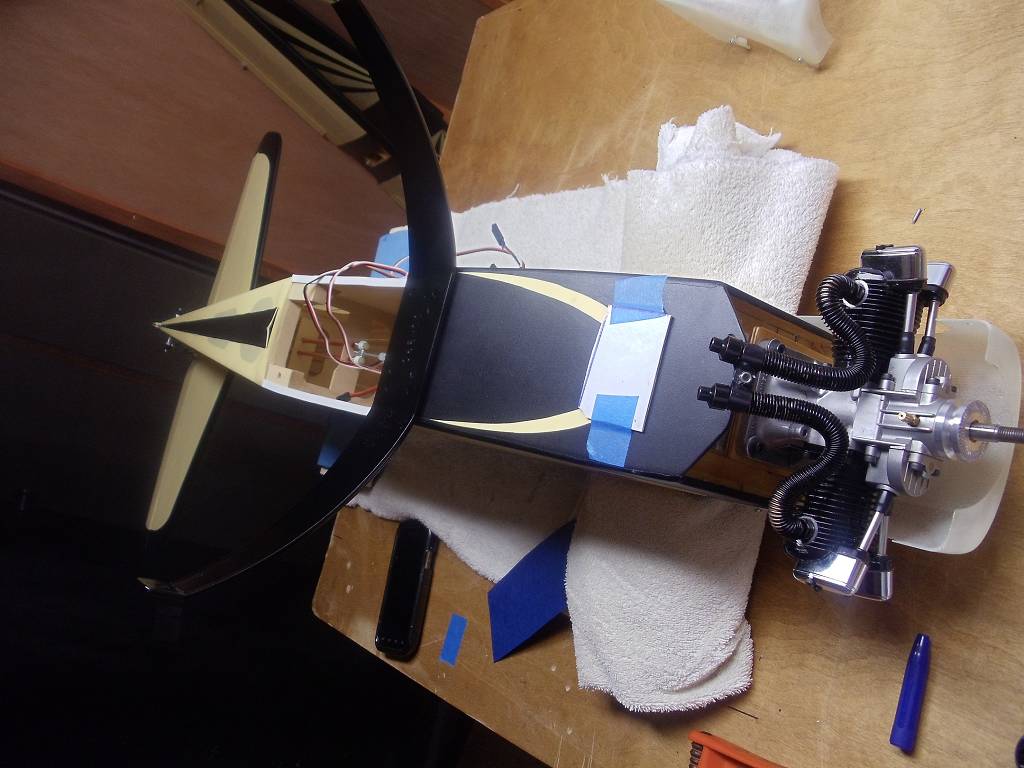

I have started at the nose cleaning up the last of the build chores. I hope to get the final cuts done on the cowl today. I want to get it and the wheel pants done and the painting completed so it can cure while i finish the rest of the build. I have flown the new reciever in another airplane for proof of reliability and the list of details for completion is getting shorter! Everything is falling into place. I was really concerned about bending the exhaust pipes. They have been bent repeatedly for a couple of instalations (and one crash where they got bent violently) and i was concerned they would break on this final instalation for them. I thought about heating them for bending with a small torch, but was advised that trying to use heat to aid bending would result in them crumbling. They survived the bending, but they are on their last legs i am sure.
It might not be possible to teach a pig to sing, but you can teach one to fly Glad it all went well with no mishaps. It will fly even better when you finish dialing it in. If you do add a bit more negative incidence on the top, it will be interesting to know the effect. How do you go about changing the incidence? I have heard folks talk about it, but have not read how to go about it. If you run across information on how to do that please post. I connected up the aileron interconnects the other day for the first time, With all that aileron surface, it should have a heck of a roll rate! I plan to leave mine assembled also, and it will definately will help with transport issues. I suspect a lot of the interplane strut hassles, directly result from the wear and tear from assembly and teardown. Sure wish i had done the cabane bolt reversal trick, it would have been a prettier build.
My son has be down here from MS for the last couple days on spring break. from college. We had a ball playing with model airplanes like a couople kids. He still is a little kid to me i guess. Two tours as a combat marine in Iraq, a a deployment to the Horn of a Africa and and a liason tour with the Israli Army. and he still allows me to think of him as my baby boy.....Humors the Old Man. To all reading this, please support our returning troops. They are the ones that bearBetween that and some remodeling at home, my progress has been slowed a bit.
