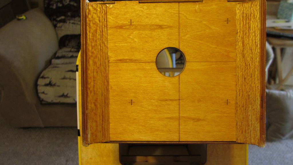

Hello, gotten alot of help on building this plane, (thanks guys) need a little more now, Iam ready to layout and mount the engine, but I am confused as to placement,,Ihave a dle-55 that I am installing. But to be honest I am not sure of where to drill the holes, as compared to what is layed out on this firewall. The vertical line on the firewall is not centered at all, the hole in it is centered side to side, but ishigher on the firewall. I am kinda confused, this is the first Kit I have built from the start, I know there is a template for the dle-55 Iseen it online, do Iprint it out and completely center it on the firewall and drill,, do I use the hole as a reference, Is that centerline on the firewall important?, is it off center for a reason, or a screw up at the factory, DO Ineed to try and test fit the engine, and put the cowl on to try and locate where the holes go,, I just want to be sure before Idrill these holes,, Thanks for any advice fellas

I don't know what plane it is so can't be 100% sure but the offset center line is usually that way so when you put in the couple of degrees of engine thrust angle the crank shaft is centered in the cowl. On a kits plans they should show you or tell you how much right thrust or down thrust to put in. Most the time about two degrees so we offset the engine so the cowl will fit correctly.

Its an ultimate bi-plane from nitroplanes (flymodels)  not sure if the crank centerline and the hole in the firewall, and cowl, are all supposed to match up,

The cross hair marks on your firewall is what you line up on not the whole in the center. If you want to mount your DLE55 easily try this product we designed and manufacture.

I haven't assembled that plane for anyone but the hole is usually just for your fuel lines. The horizontal and vertical line is where the crank should line up to. Some of the planes have the fire wall already set at an angle for the engine thrust so they off set the vertical so the engine lines up to the center of the cowl. You can just measure to find out if I'm correct, I'm pretty sure this is what it is about. ARF instructions are a bit light on things like this but you probably will have a couple of degrees of right thrust on the engine.

I personally would not use the hole in the firewall as a reference. Follow the centerline possibly shown in the instructions. It should not matter what engine is installed. The alignment of the engine shaft to the centerline of the airframe remained the same. Shift the engine on the firewall to meet the same centerline as shown in the instruction or if necessary use the cowl to find the center and the align the engine shaft to that center.

Looks to me like the firewall is canted for right thrust, and the offset center line positions the engine so that the prop washer is centered in the cowl.
