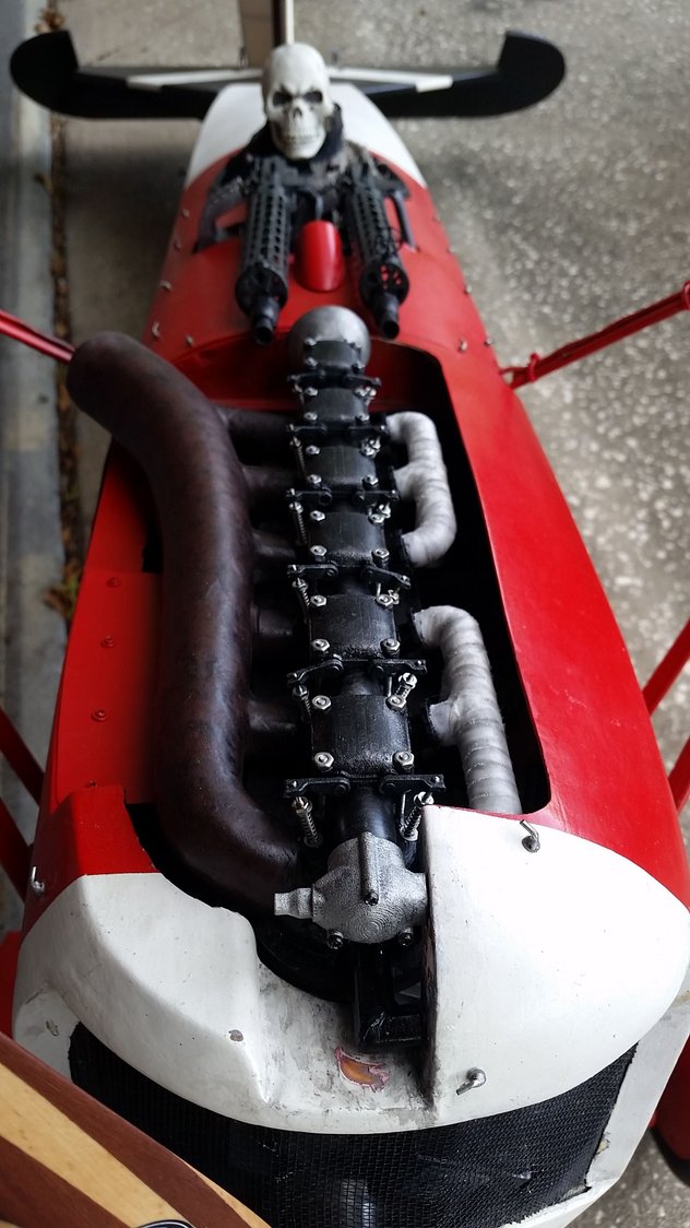

Rob, where did you get 3D engine ?

https://www.rcscalebuilder.com/forum...TID=27774&PN=1
Used the stock kit cylinders and exhaust. Flightline graphics has the 1/3 scale files. I scaled them to 1/4 and got them printed in SLS Nylon. Various brass tubes, 2-56 and 2mm threaded rod and some springs. Either from LHS or Amazon.
Working Exhaust - plumbing fixtures and neoprene tube to hole in kit ABS exhaust.

Very impressive!

Built this thing thinking I would just do sport scale and not much detail...right.
