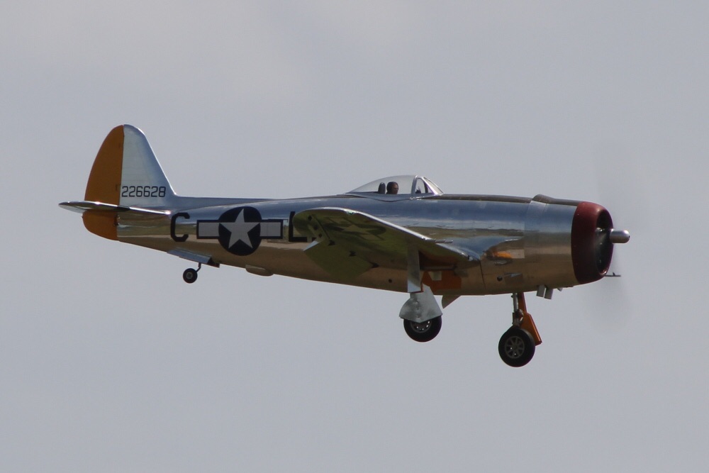

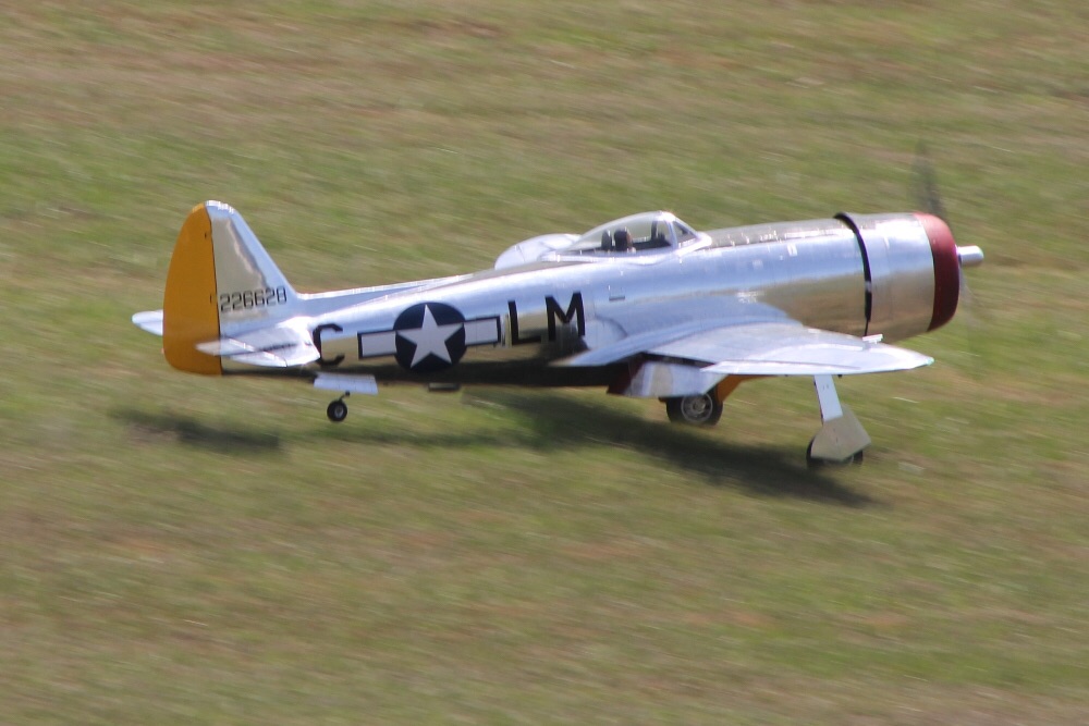

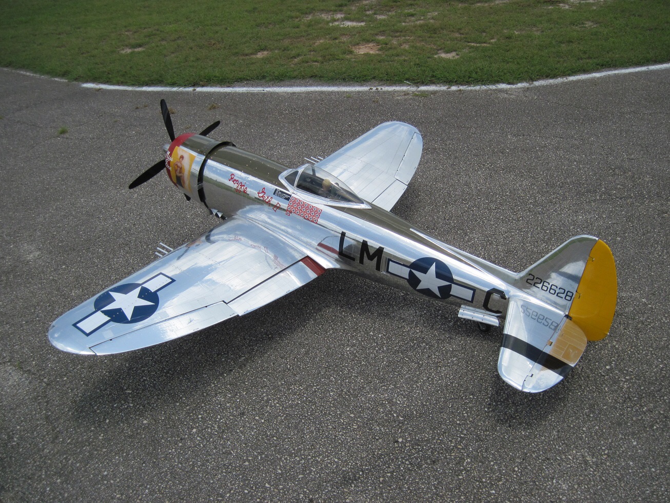

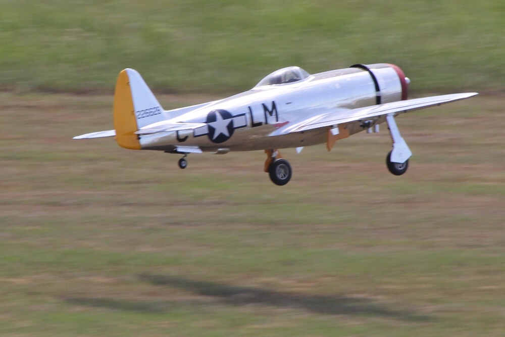

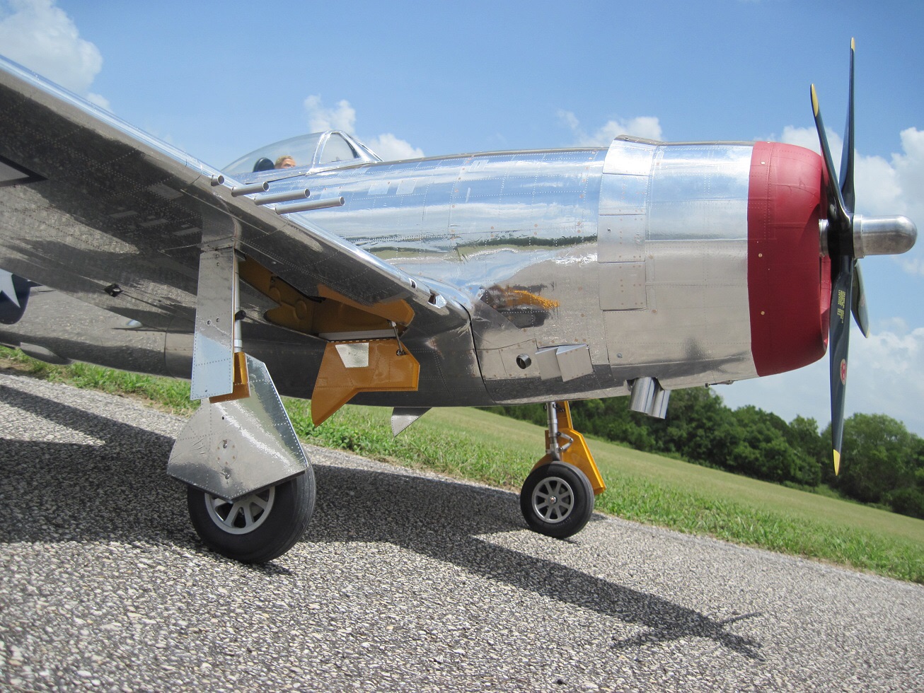

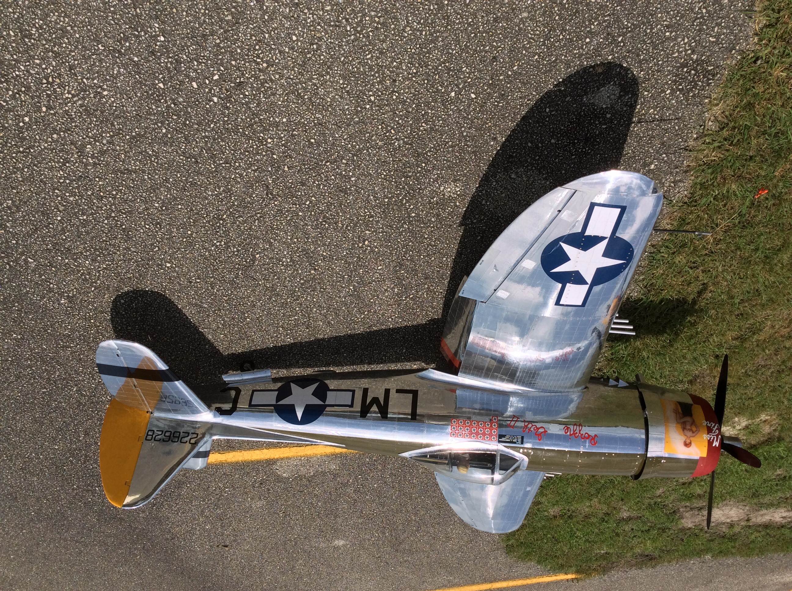

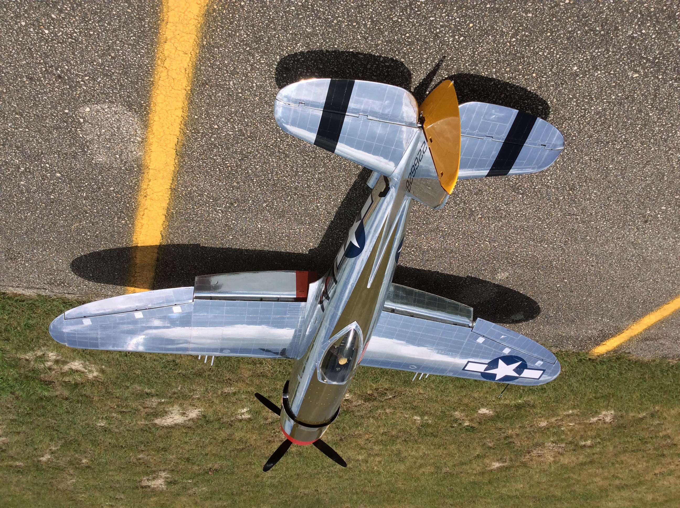

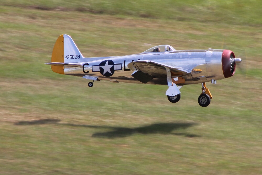

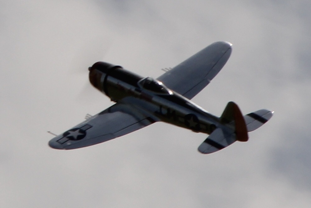

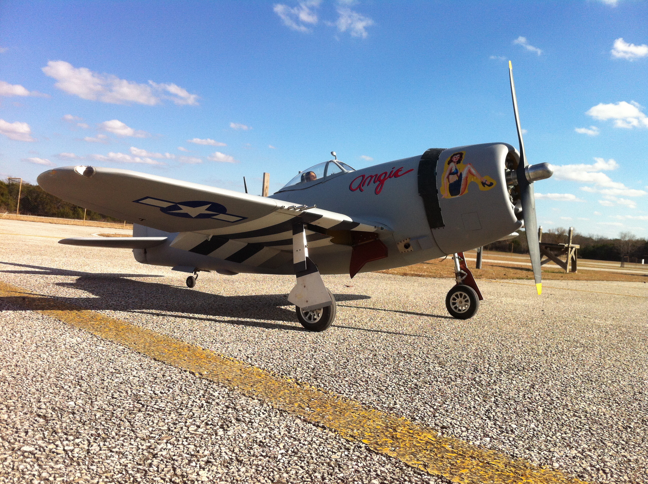

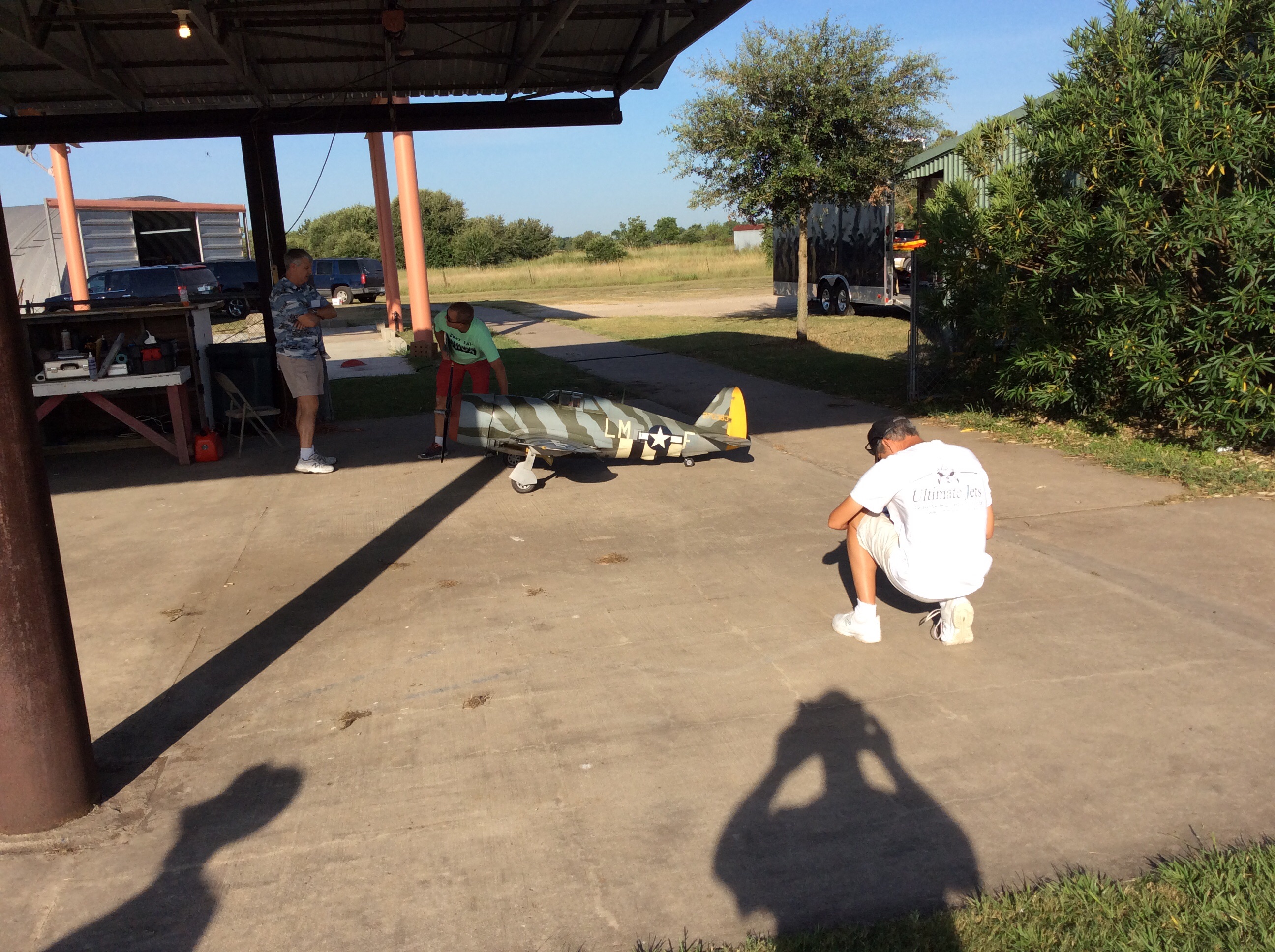

So this has come up quite a bit as builders start to build a kit so they can compete in scale compatitions. I am hoping that we can start a conversation about competitive kit building, how to and experiences of former builders/ competitors of scale planesand even judges.
I am getting ready to start competing and will gain some experience this year by going to our local scall masters qualifier.
My plan is to concentrait on one plane, the P-47 D-25 I have built three
The kit of my choice will be a Meister P-47 as I am working on my resurch and I will start with the modle P-47 D-25 then chose the scheme.
I am starting with a modified TFGS P-47 RTC and compete in the sports scale ARF division to gain expieriance.
Most just go to fun flys and fly ins but this is not competitive, to win best of show, or pilots choice is not the same as competing in a scale masters event.
So I am looking for a conversation about building scale kits. I know that the judging can be confusing and I understand that one will be replicating a spicific full scale plane with documentation. Also flying is a big part of competing.
so if you have cometeted and have something to share or if you are interested in competing and building spicificly for compitition, please share.

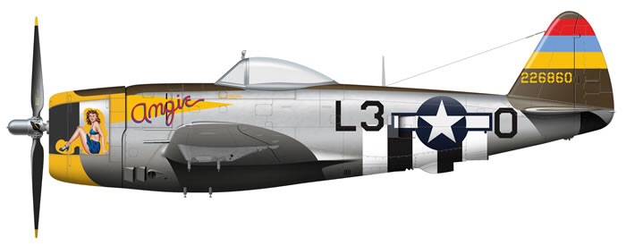

Thanks, so fare my scheme is Angie as it has a lot of history and there is also a lot of librity as this plane is well documented with veriouse diferent paint colors as parts were swapped out, so one wing can have a drab wing and the other would bu bare aluminum, or one flap can have invasion strips and the rest of the wing has none.
I was was told by a former scale master competitor that you can't be competitive if you go to scale as the judges can't see your rivets and panle lines if they are not done in a way that makes them visible, like using 1/32" chart tape instead of 1/64", and no vinyl rivets, but I disagree and will present the most scale plane I can and let the cards fall where they fall.

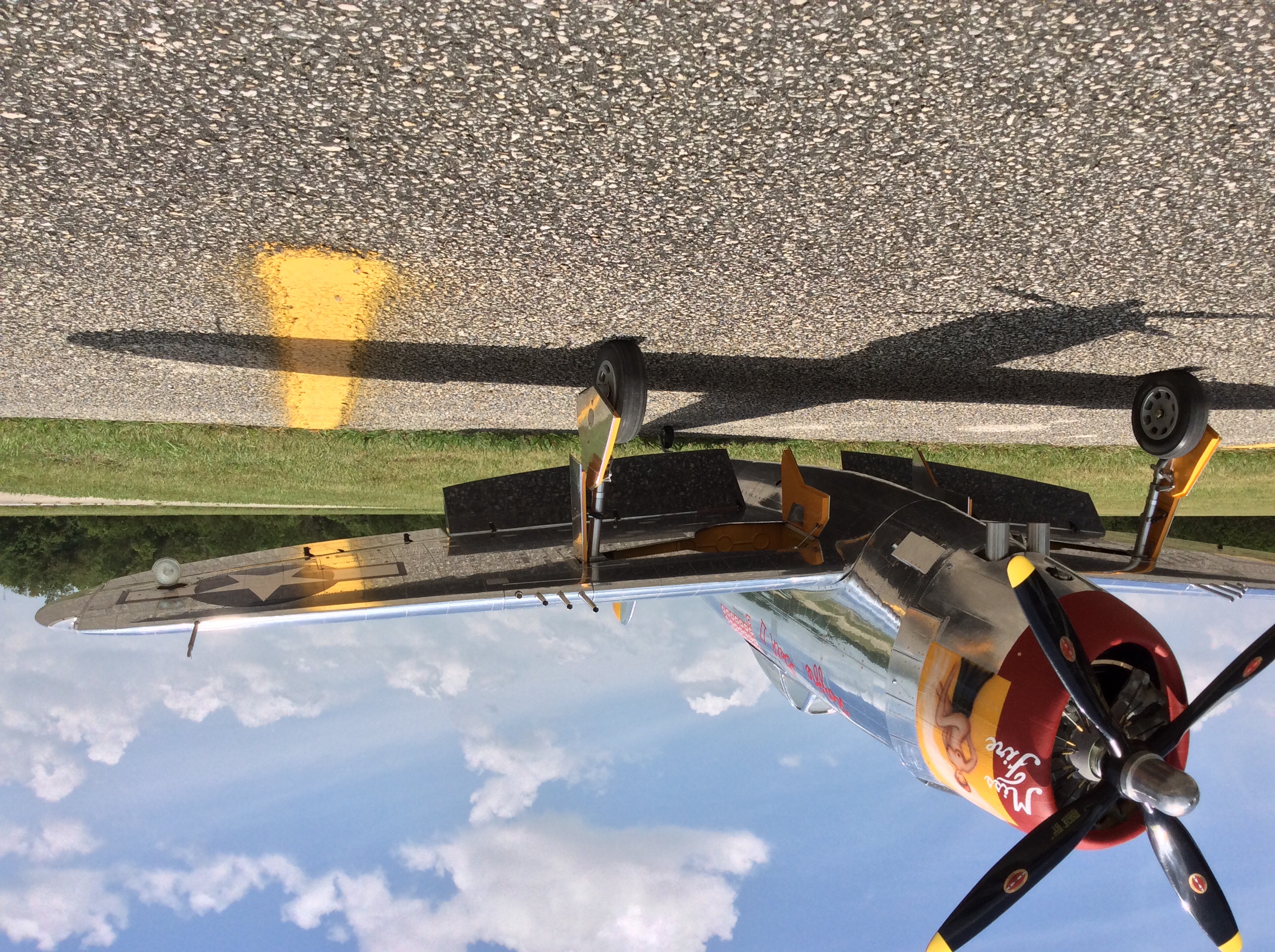

Hi guys, I need some advise. I am planning on compeating next month at Bomber field in a scale masters qualifier, fun scale beginner class, what ever the bigginer class is. I will only have a picture and description of my model for documentation to prove it is a real world prototype.
I dont have time to really work out a rutine for the flying portion as I just maidened the plane and only have about 6 test flights in. Had a dead stick and some minor damage that I am repairing and should have her ready to fly by next week. This only leaves one weekend to make sure all is good so not going to get in some practice.
My my goal is to just qualify for the championship in October. Is there a minimum flight time to score a passing grad? I am going over a basic rutine in my head and will practice that this weekend with another plane.
If im not mistaken the maditory maneuvers are 1. Takeoff, I got that she track very well and I can keep her on the ground as long as I want befor I rotate, gear up once I lift off and before the turn out. I am over powered so I need to watch my speed, mostly at 1/4 to 1/3 stick does the trick.
One lape at medium altitude then into a figure eight (2 maneuver). Then another lape into a low pass at 10-20' then one dirty pass and land. She lands good, I haven't tried flaps yet and haven't needed them but I know they are reqiered. I will see on the test flights. If push comes to shove I won't use them and take the hit.
Anyways just looking for some advice for my first try at compeating.

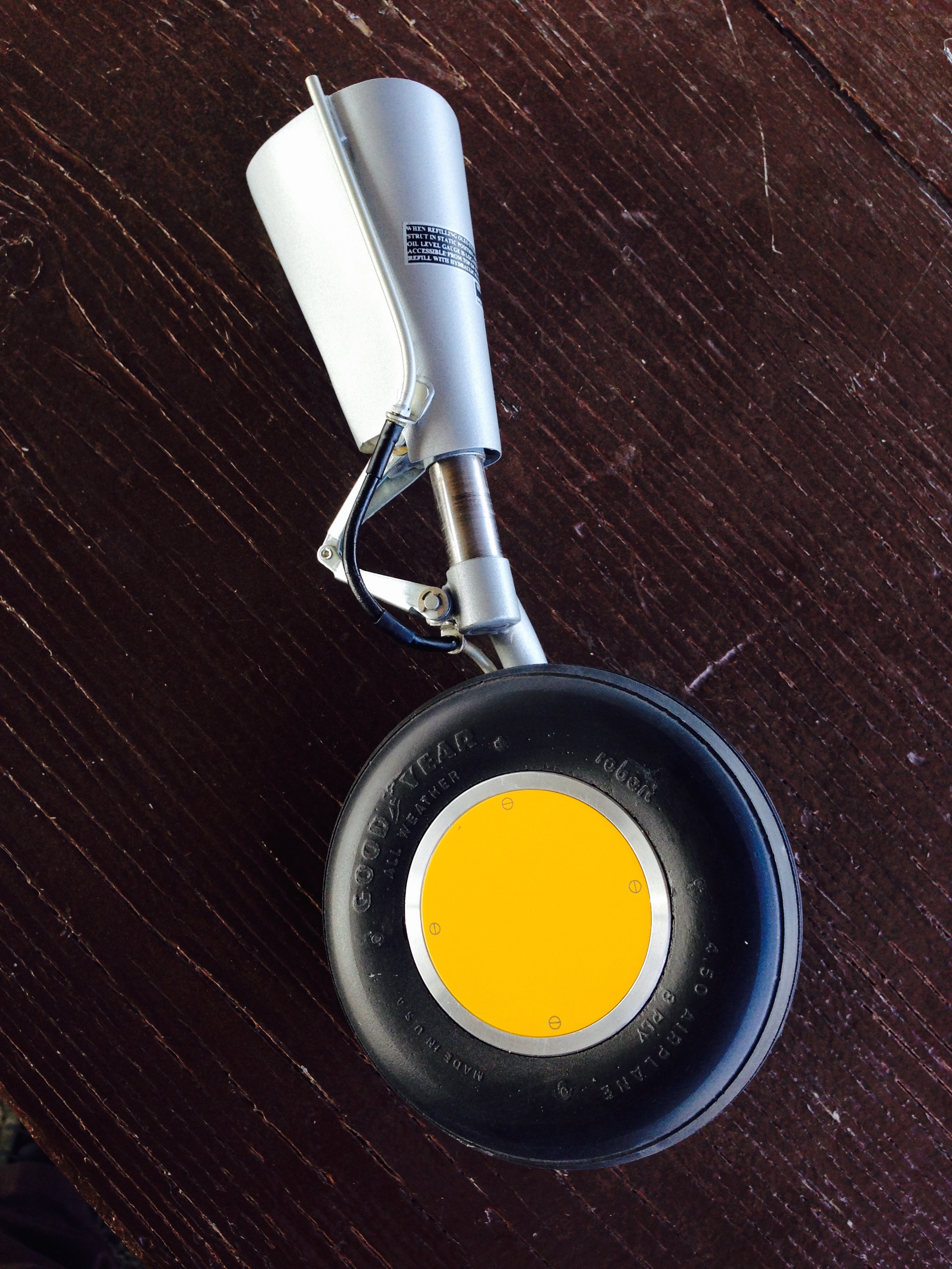

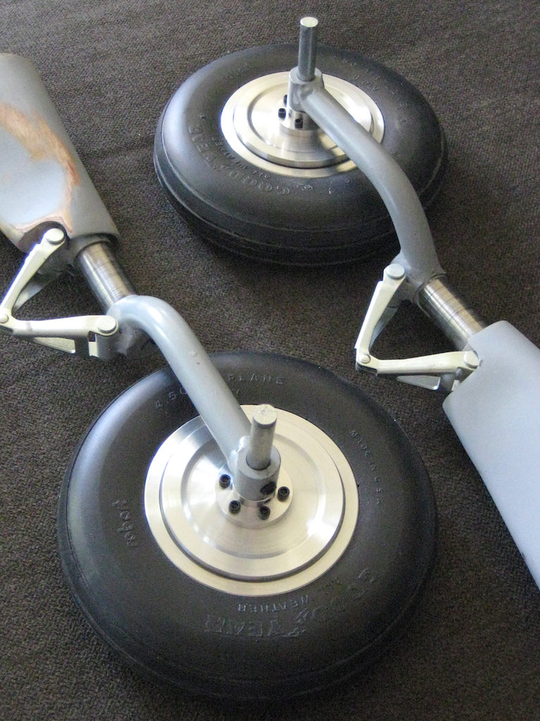

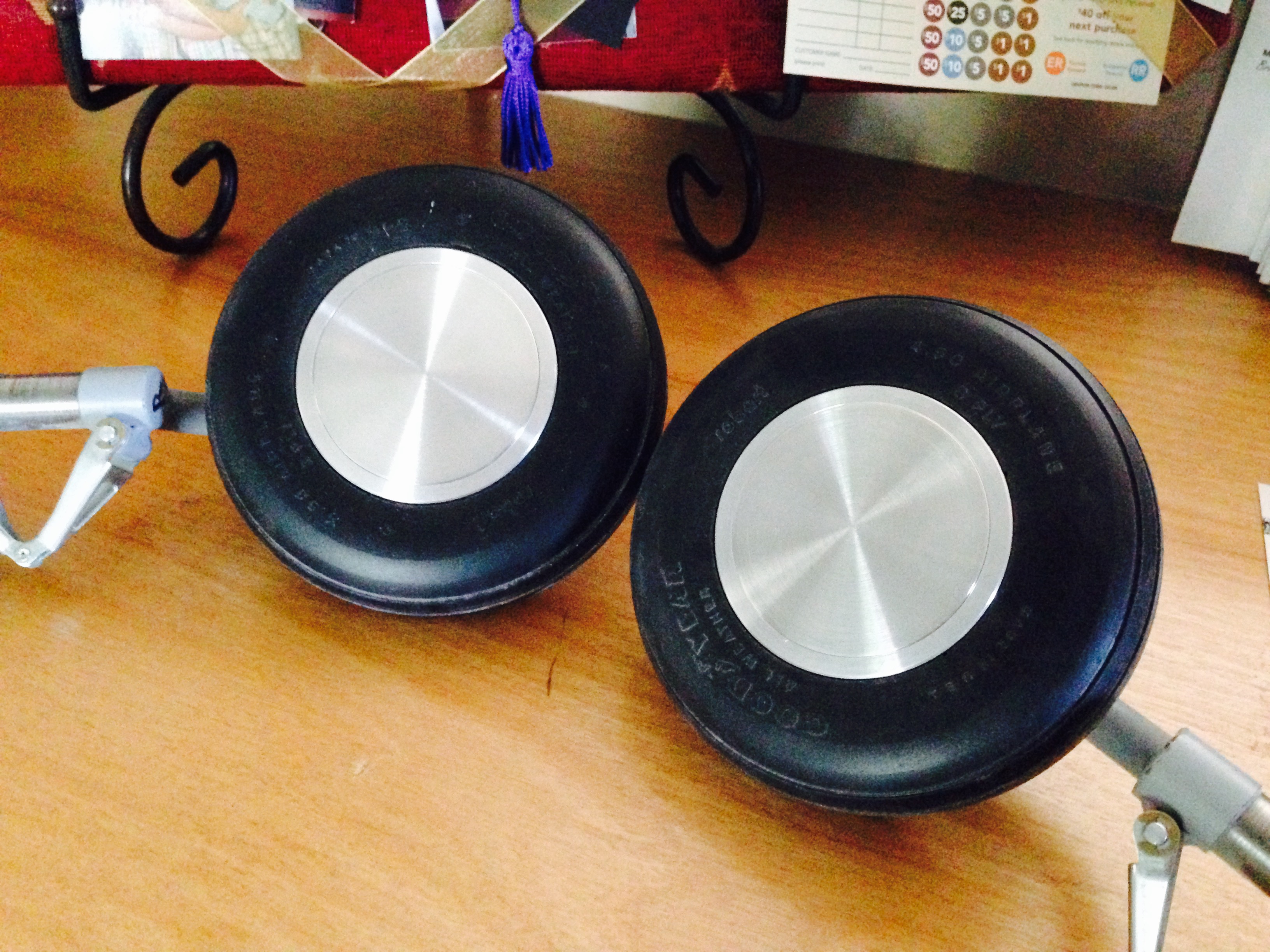

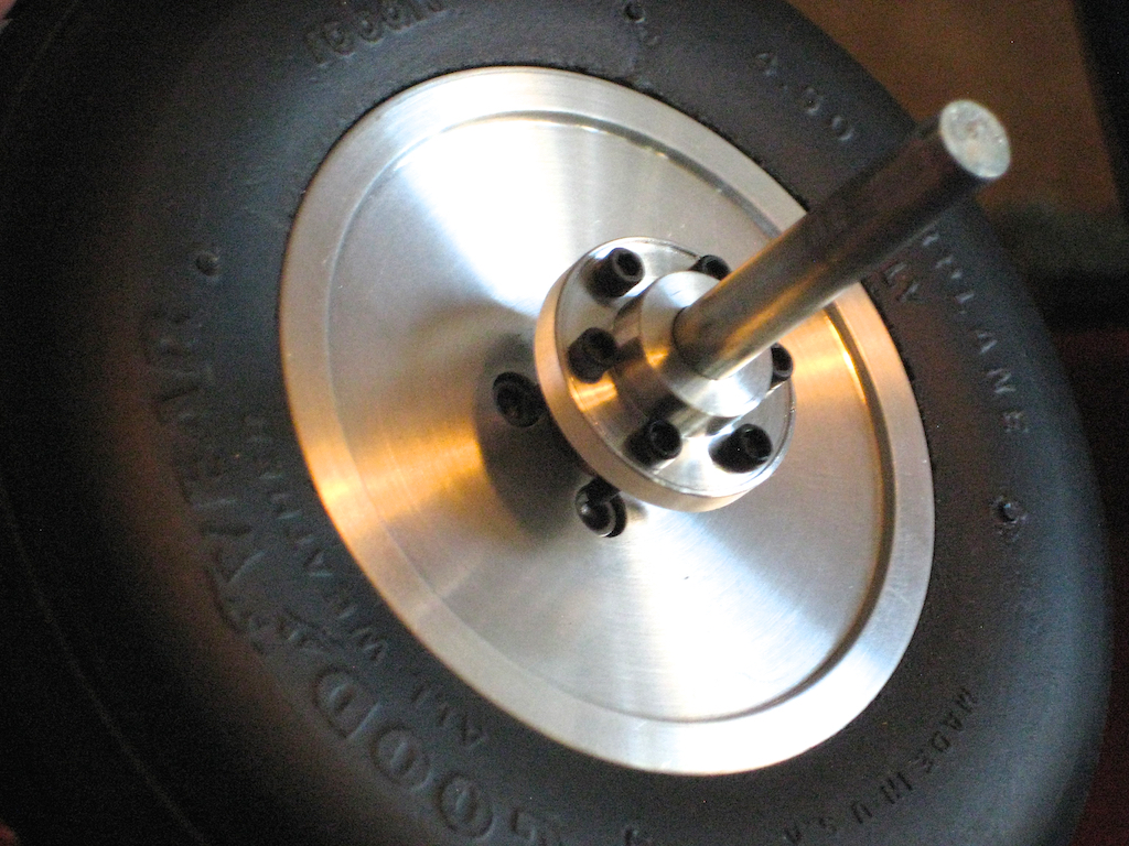

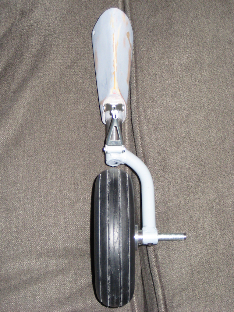

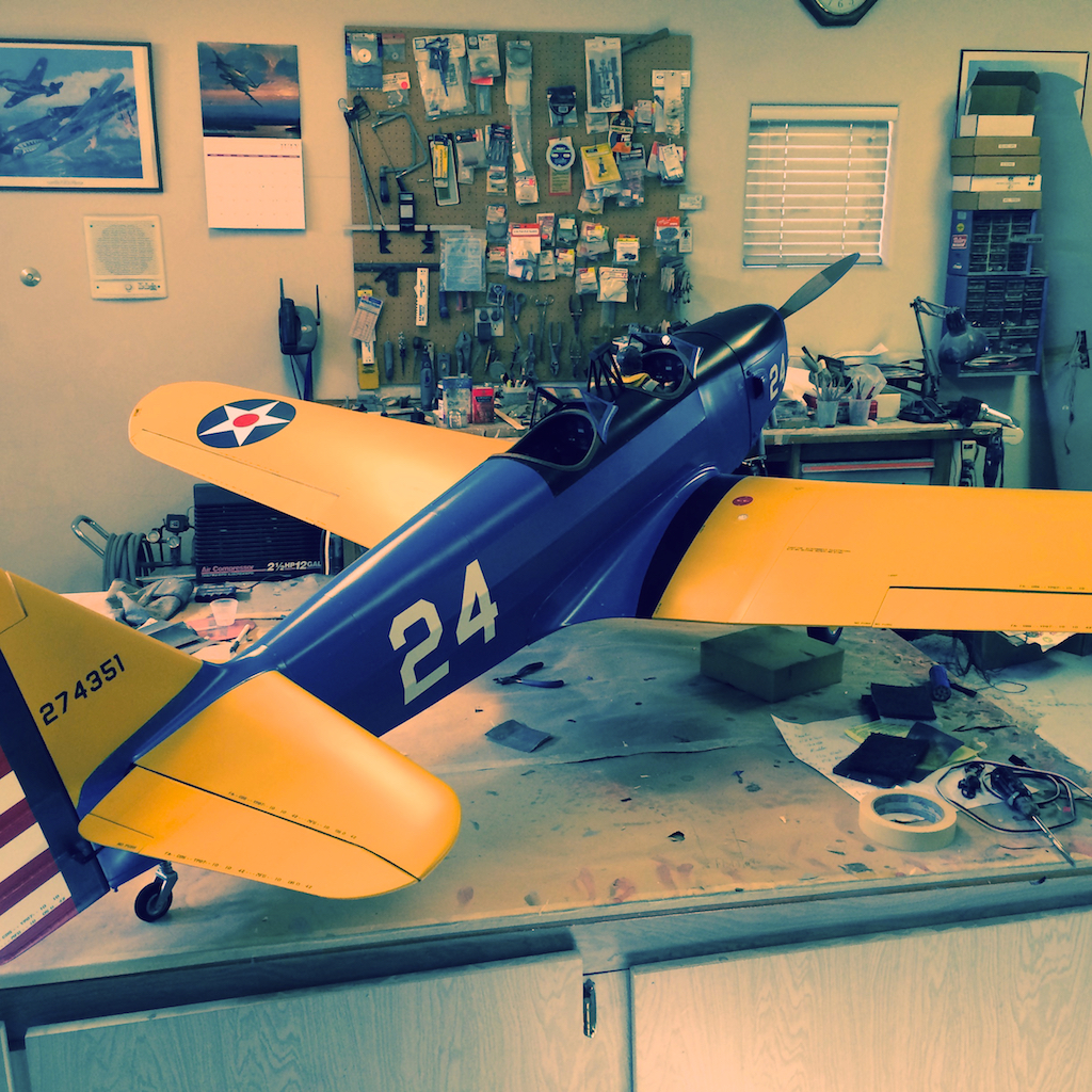

My little input. Don't forget your friends!
One of my flying buddies competes often and really enjoys flying a PT-19. His last one was lost and he decided the next would be a Aviation Concepts kit. He is an amazing builder but didn't have the equipment to turn some faux wheel brakes. I was honored he asked me for assistance since I knew how nice of a plane they would end up on.
I worked really hard on the parts, as I am no master at the lathe. I just have some DIY knowledge and a small collection of Sherline brand lathe / mill stuff.
A couple weekends and I created the parts, as best I could.
I was really happy when I gave them to him and he ran all over the field sharing them with the other guys. The wheels are Robart aluminum wheels and the struts are also Robart.
I made a spacer / mount for the axle which centered the wheel and tire with the struts main shaft. The I made the faux brake. The entire brake assembly attaches to the wheel axle with a set screw and stays stationary. There is about 1/32 clearance between the brake and the wheel. I also made the outer covers out of some aluminum.
I made the parts for free and the enjoyment he got out of them was payment enough.
The plane has not flown yet but I believe it just needs final adjustments and balancing.

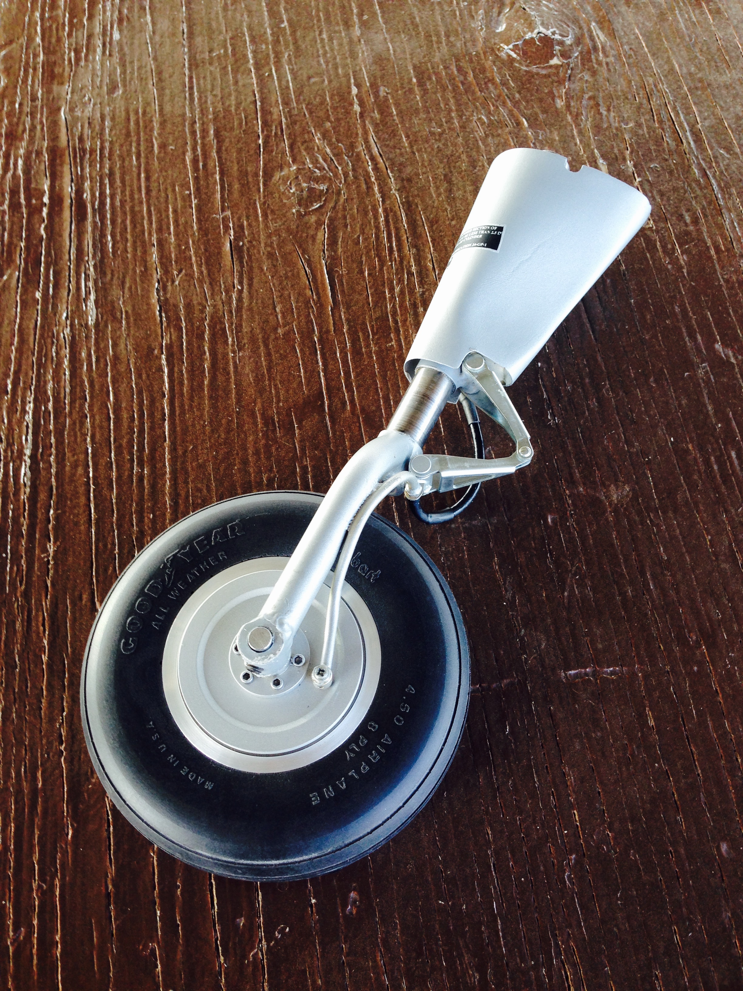

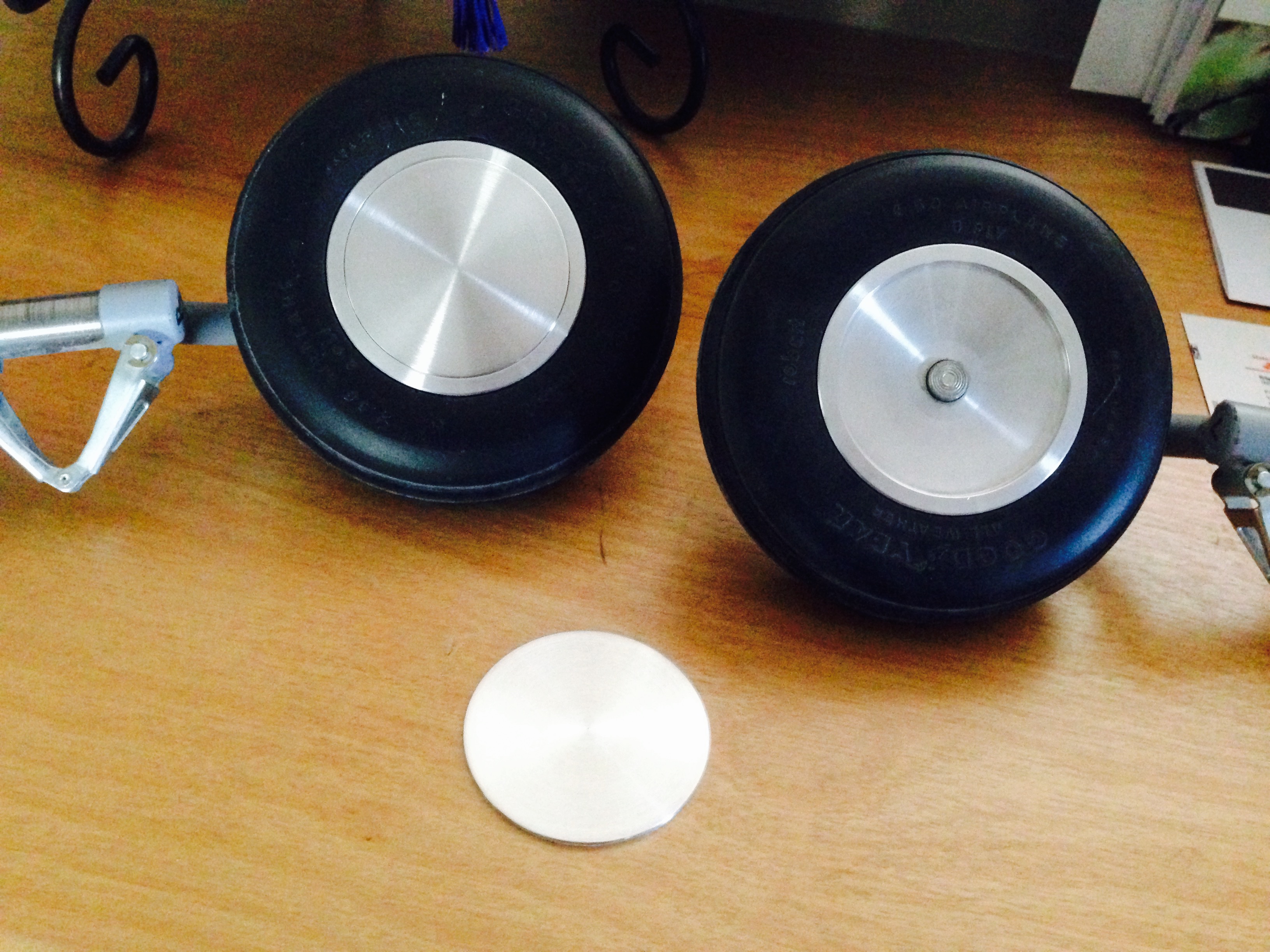

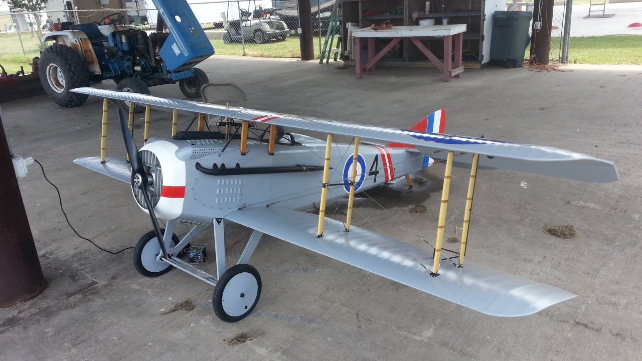

So this weekend I competed for the first time (ever) at the Scale Masters qualifer.
I learned a lot about this type of competition from the different classes and the reqierments.
I was in the Pro/AM sportsman novice division as were 80% of the pilots this time.
In Pro/AM sportsman novice and Pro you are only flying, no static at qualifiers. There were a lot of ARF and some kit builds. This division is staked with flyers so the flying is good, but most were first time competitors and don't have scale flying expieriance.
Static judging was for export only. The judging was stiff and most got lower scores then they usually get, but they were on point in my opinion.
these are the two export entries.
This plane was scratch built and in the team division. Very detailed and great craftsmanship, but got hit on color and finish, to new and shinny.
