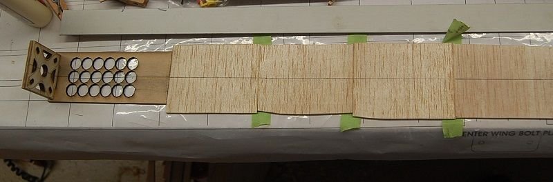

The first step in building this model is building up the fuselage floor out of 3/32 balsa. While most of this plane will be built with thin and medium CA This is one part that is better with regular wood glue as it sands more easily. This technique can be used to edge glue any size of sheet balsa. Just tape the edges together then open the joint and fill with glue. Wipe off the excess and weight it down so that it will dry flat.

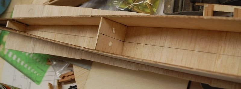

Here is the bottom of the fuselage. You may have to look closely to see it but there is a straight line down the middle of the sheet. This is a datum line that all of the formers line up on and which helps with building a straight fuselage. The dimension that is written on the sheet indicates that it is just wider than the fuselage. Once the fuselage sides are attached, it will be trimmed to fit.
This is one of the fuselage sides. There is a left hand and a right hand side with the etch line, that I have marked "do not cut" facing the inside of the fuselage. The dotted lines are the approximate positions of the formers.

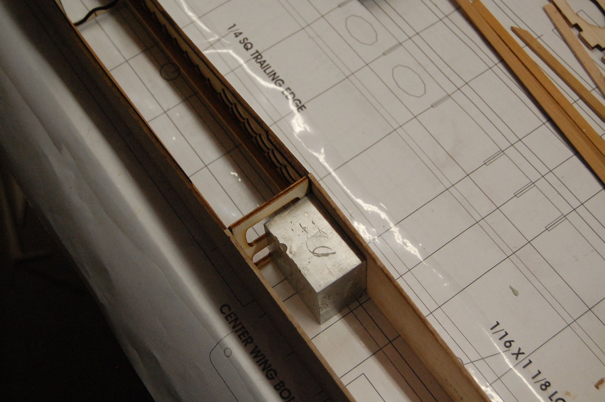

Once the front two formers are installed you can install the landing gear plate. There are notches in the fuselage sides for fitting this plate. You were careful about lining up the balsa fuselage sides with the ply doublers weren't you? Note the etched line on the gear plate. It goes on the inside and should align fore and aft. This will be important shortly. It shows up later but there is also a ply doubler that reinforces the front wing mount.
Now you can glue the firewall to the forward fuselage floor. The laser cut floor piece is used on both the nitro and electric version. The nitro version firewall is shown but the kit includes a laser cut firewall for mounting a brushless motor. The firewall and the floor are notched to fit together. Use a square to set the firewall angle at 0 degrees to the floor.

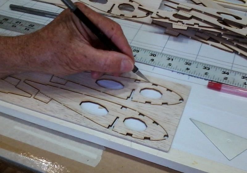

Moving on, there is one rib to assemble at the beginning. The center rib is assembled from three pieces. Later in the building process it will be drilled for the wing dowel.
