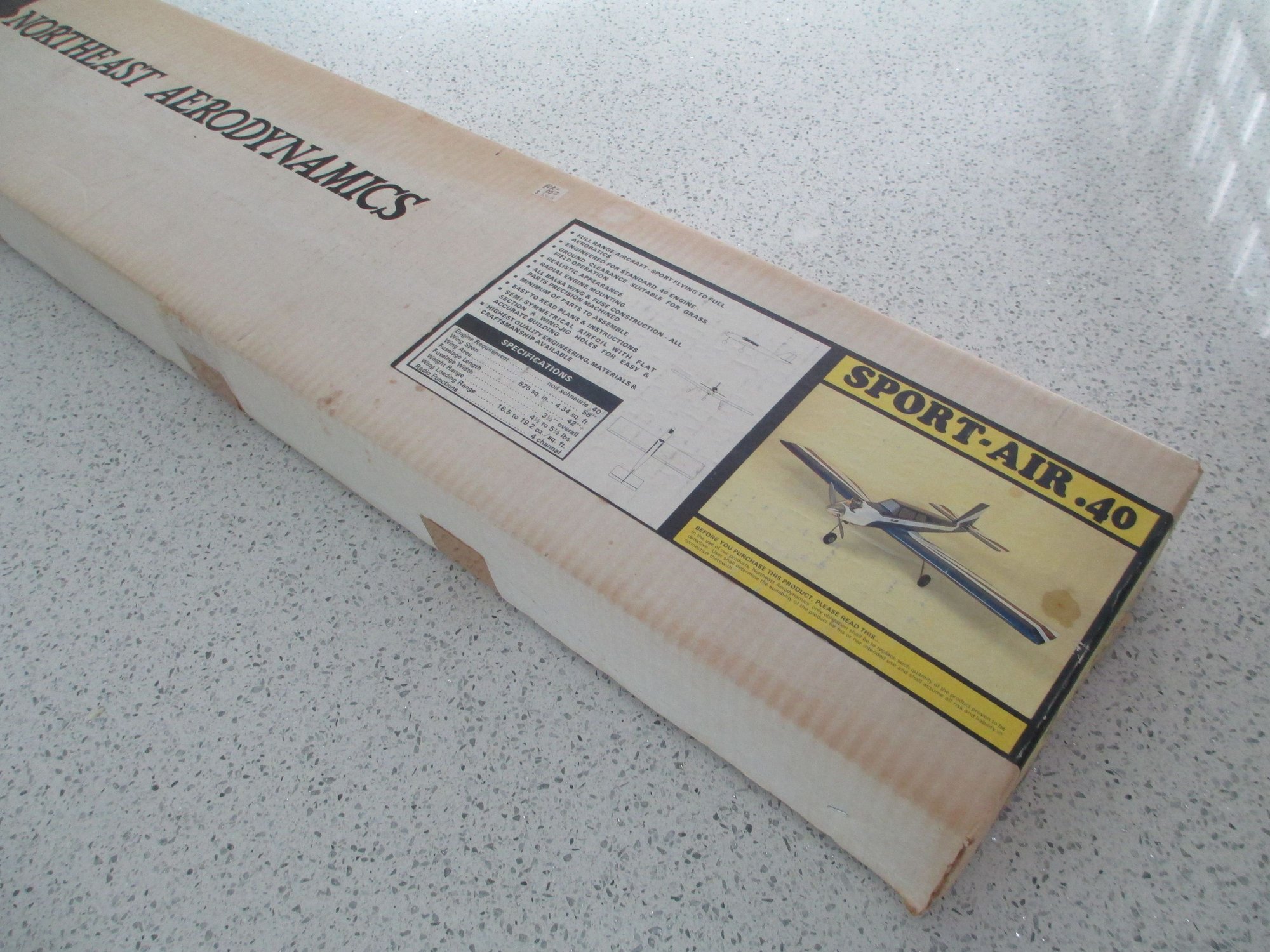

Bob's unopened Sport-Air kit.
Check out the price of this kit when it sold way back when!

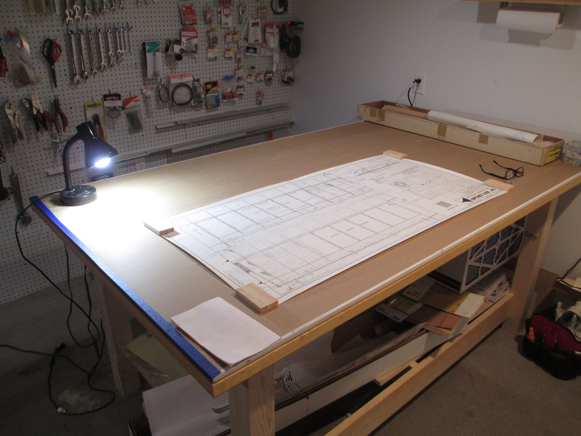

Everything seems to be here...
Note the 1980 copyright.

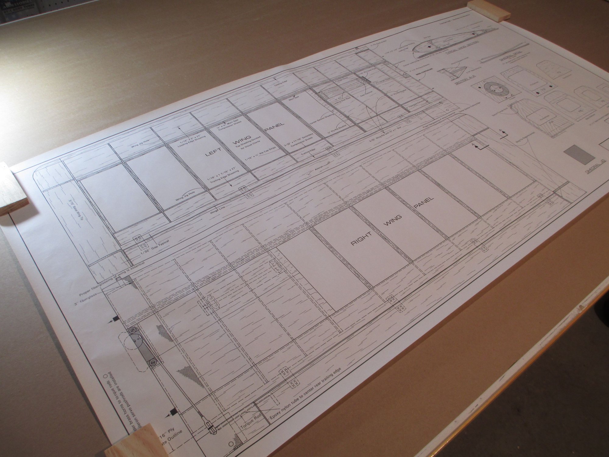

I cleaned off my build table and flipped over the 5/8" sheet rock to give me a new surface to build off of.
Plans lay nice and flat!!!

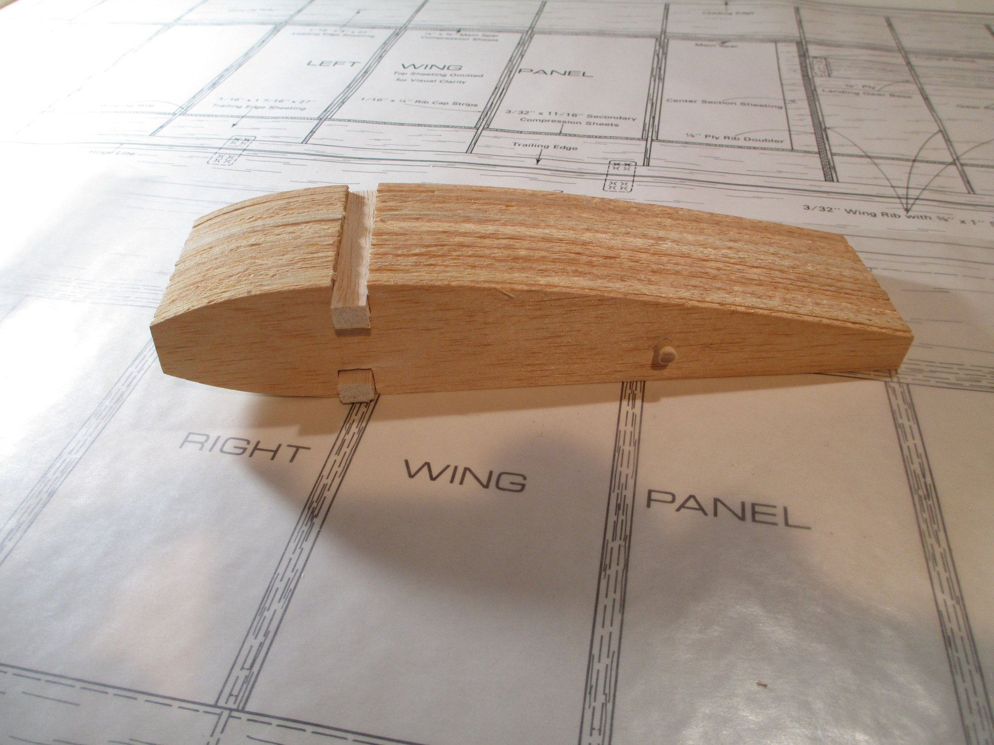

Decided that I would start by making the wings for this bird, specifically the left panel first. All of the wing ribs were die cut and secured with a rubber band. I did not have to release any ribs from balsa sheeting as is most customary. I've never seen a kit regardless of who makes it, that has ribs that are identical to size and shape, so to make them all uniform and to help ensure that I build a straight wing, I stacked all of the ribs together and will sand them as if they were one. I made sure all of the ribs were right side up (as this is a flat bottom wing), then I took some scrap 3/8" balsa stock and placed all of the ribs on the spar locations which aligned all of the ribs. To ensure that the opposite (trailing edge) side of the rib didn't move, a 3/16" hole was drilled, to which a Birch dowel rod was inserted locking them all together. A gentle sanding on my stationary 12" disc sander made quick work of it... Now I have identical ribs!

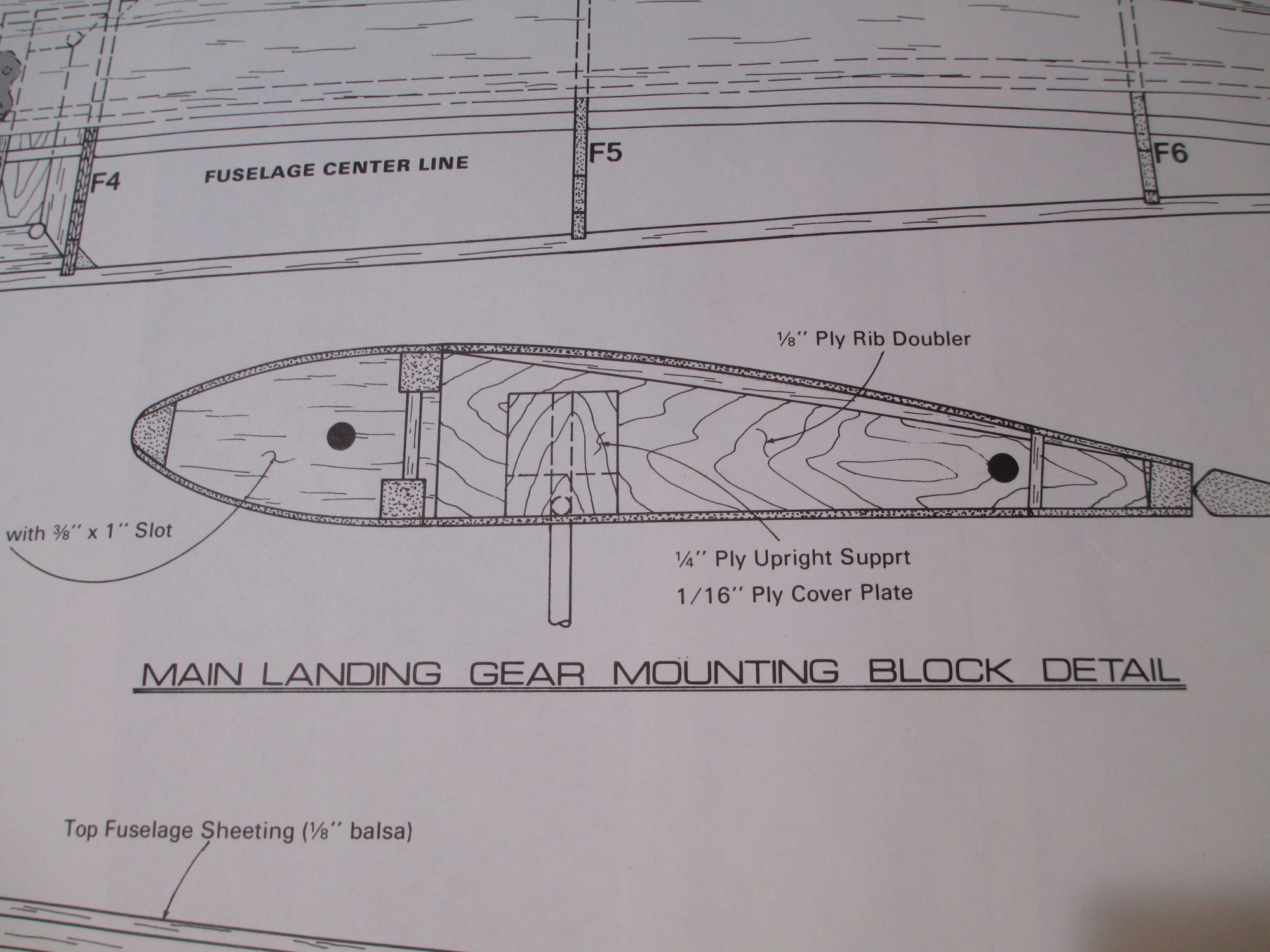

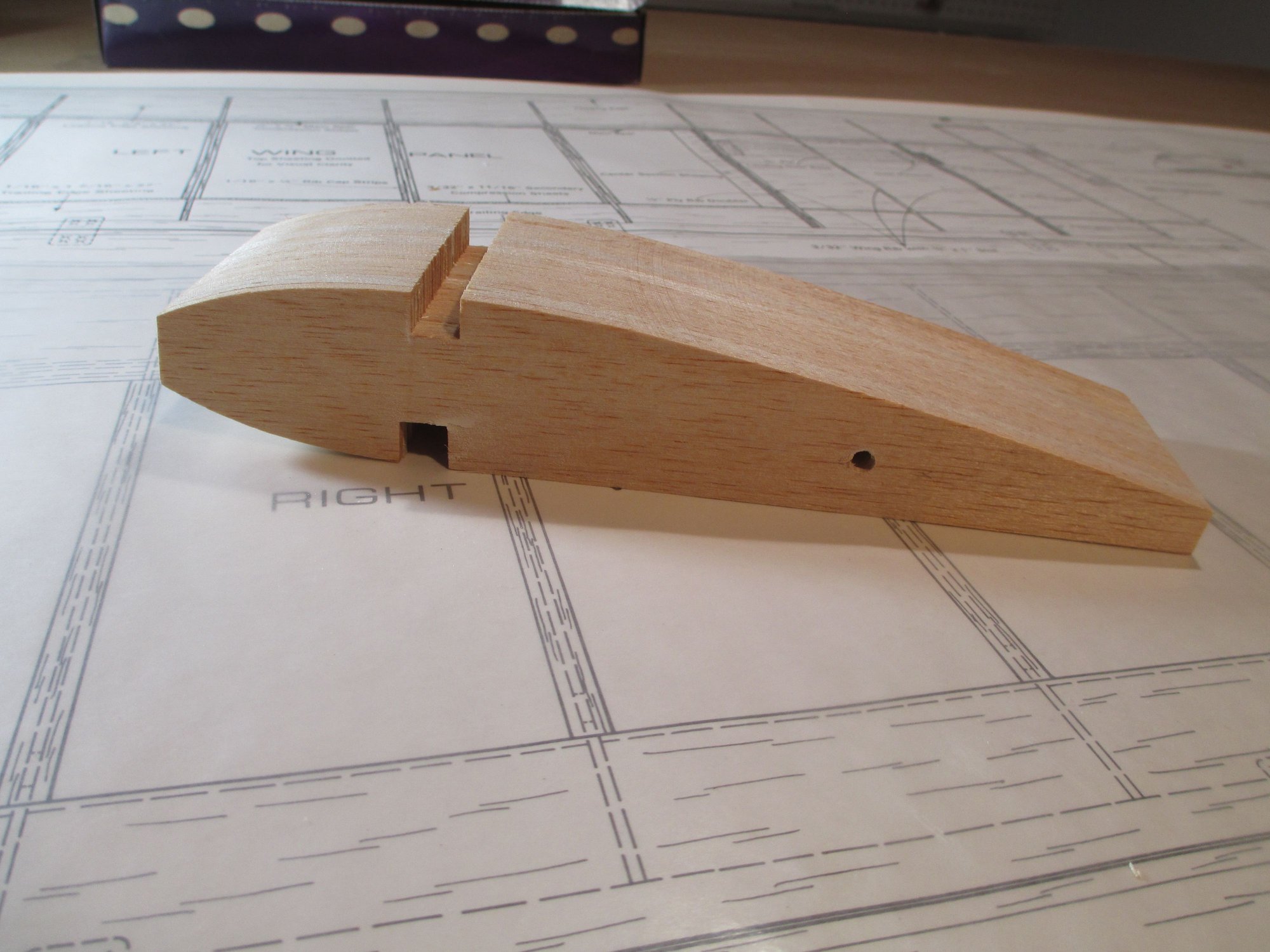

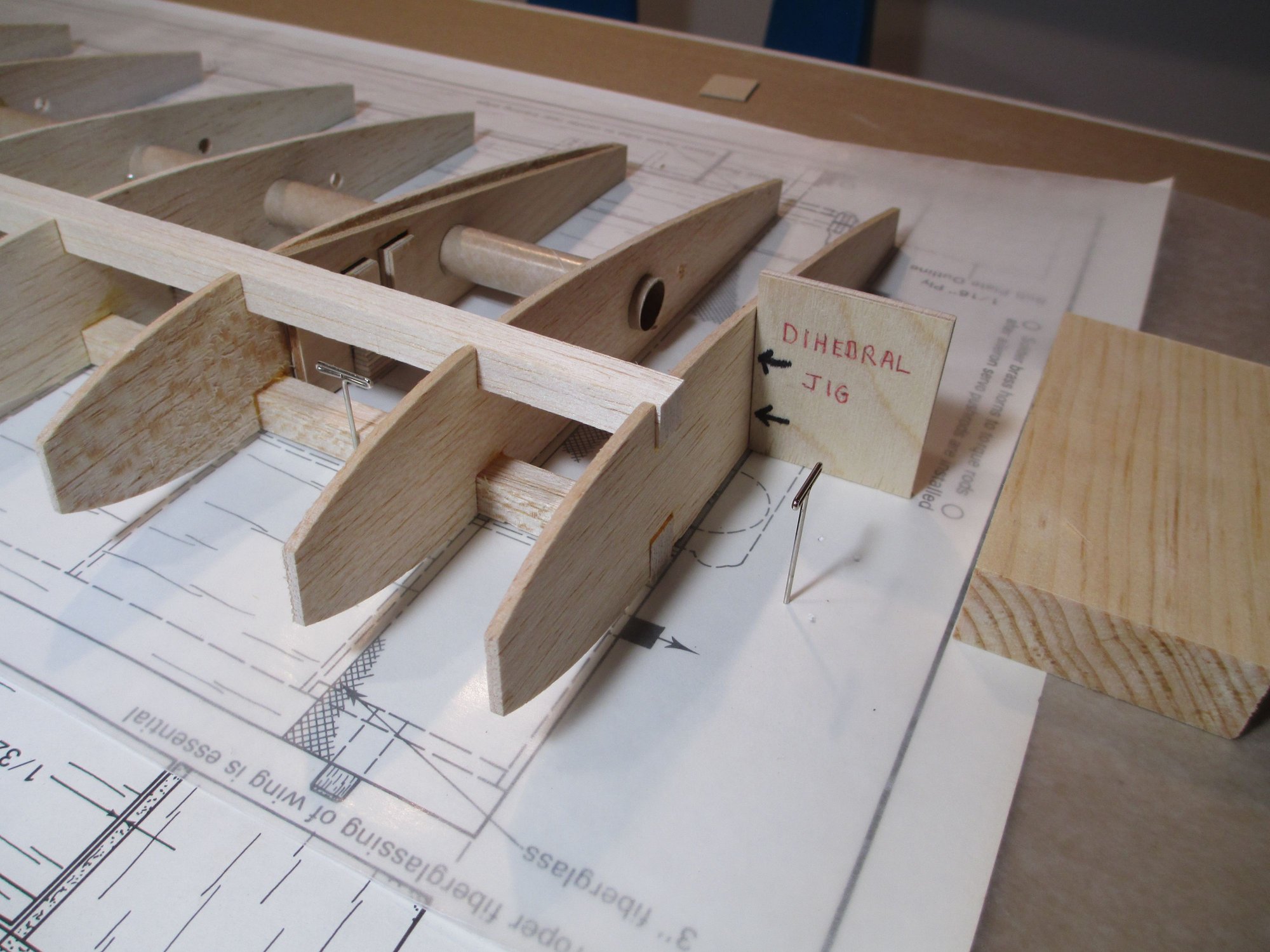

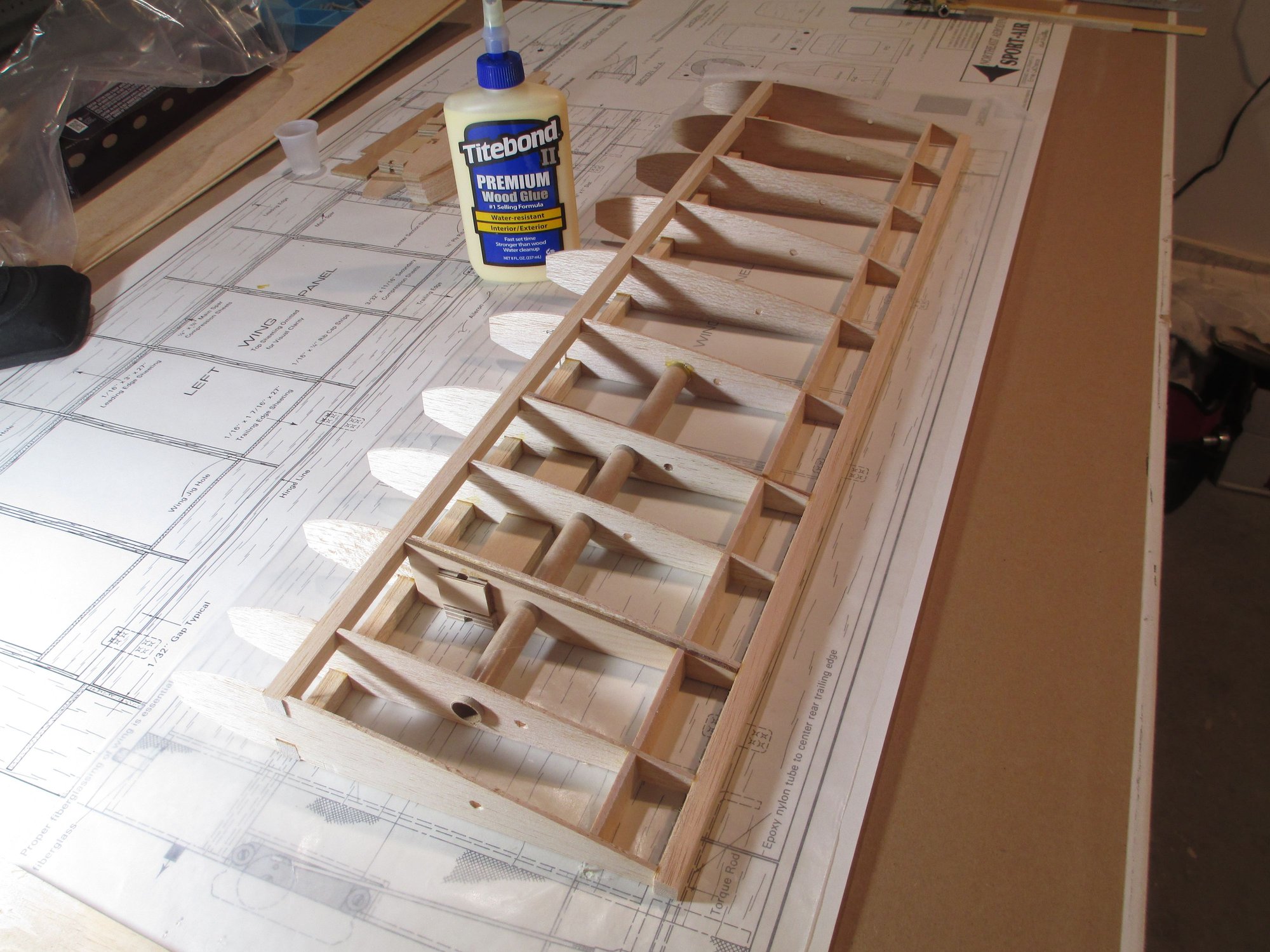

The first rib was set at an angle to accommodate the wing's dihedral. Note the plywood jig I quickly made to make sure it was accurate.
My glue of choice for building is Titebond II except for areas that need more strength in which case I use a good quality 30 minute epoxy.

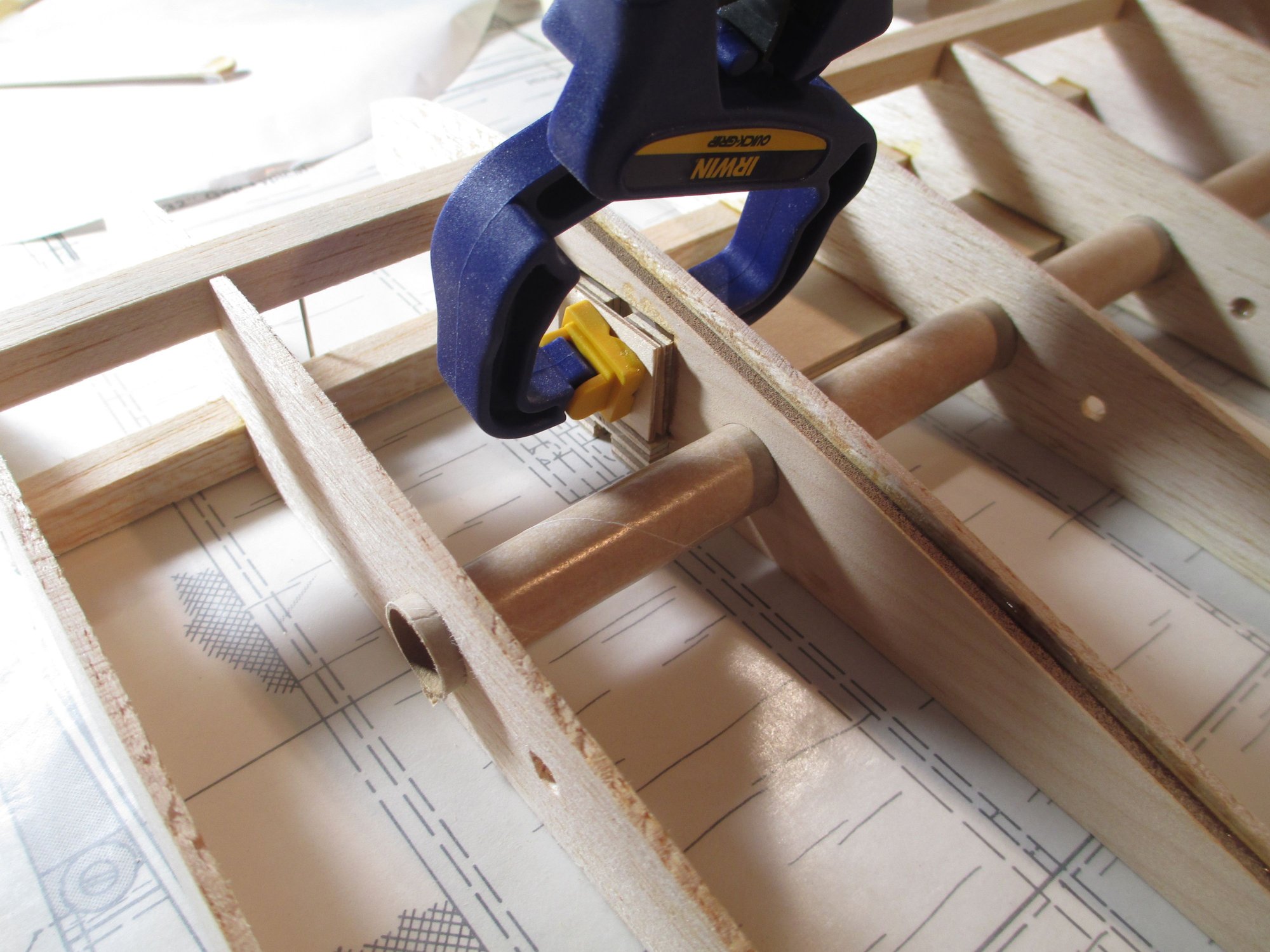

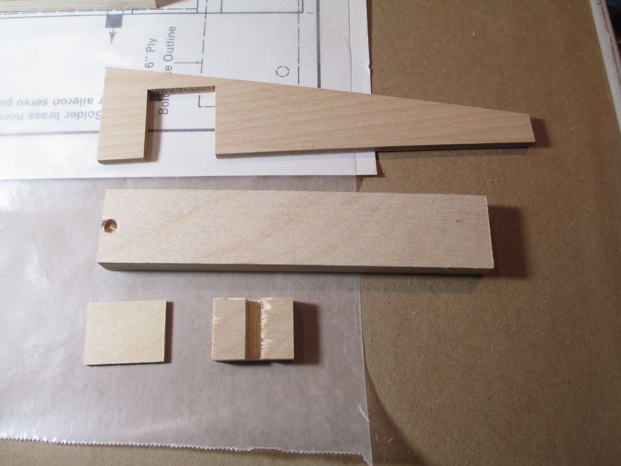

Close-up of the landing gear detail on the plans.
These four parts make-up the landing gear mount. Here's a good example of where epoxy would be used.
A small piece of 1/16" birch ply coverplate was epoxied and clamped into place.

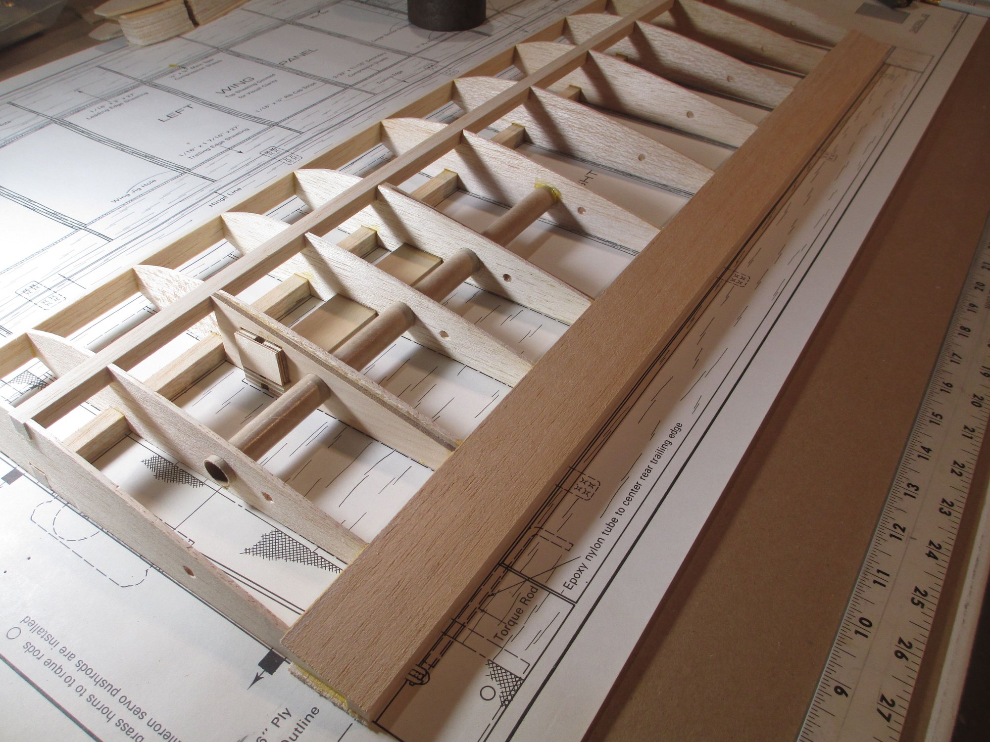

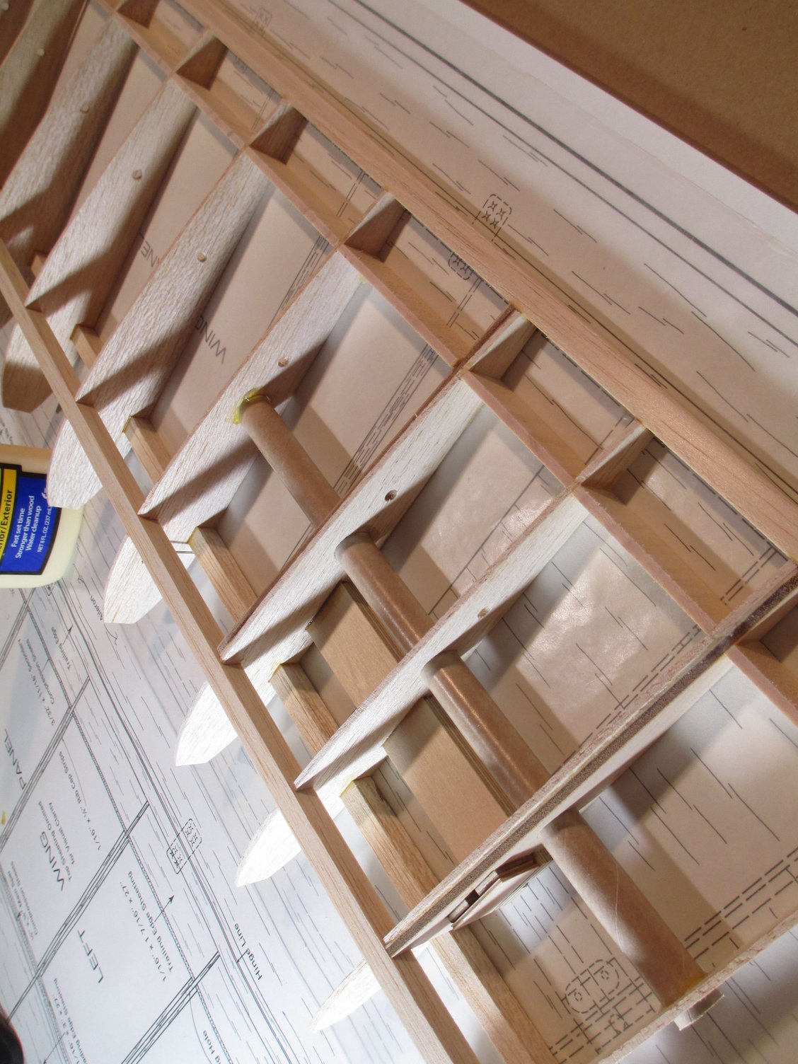

Construction of the left wing panel began by laying down a barrier of waxed paper to protect the plans and prevent any balsa from sticking. The lower front spar was then pinned in its proper location and the ribs were glued into place. The first rib (closest to the fuse) was set at an angle for the wing's dihedral. Each wing panel has 1-5/8" dihedral or 3-1/4" overall measured dihedral.
You may note a cardboard tube that extends from the second rib through the sixth rib. This is to allow a servo wire to pass through the wing easily after it's covered. I used a model rocket tube (Estes) for this purpose, it's inexpensive, light in weight and adds strength to the assembly. I plan on having individual aileron servos for each wing panel in lieu of the "old school" way of having one servo to actuate both ailerons. Each aileron servo will be positioned in the sixth rib bay.

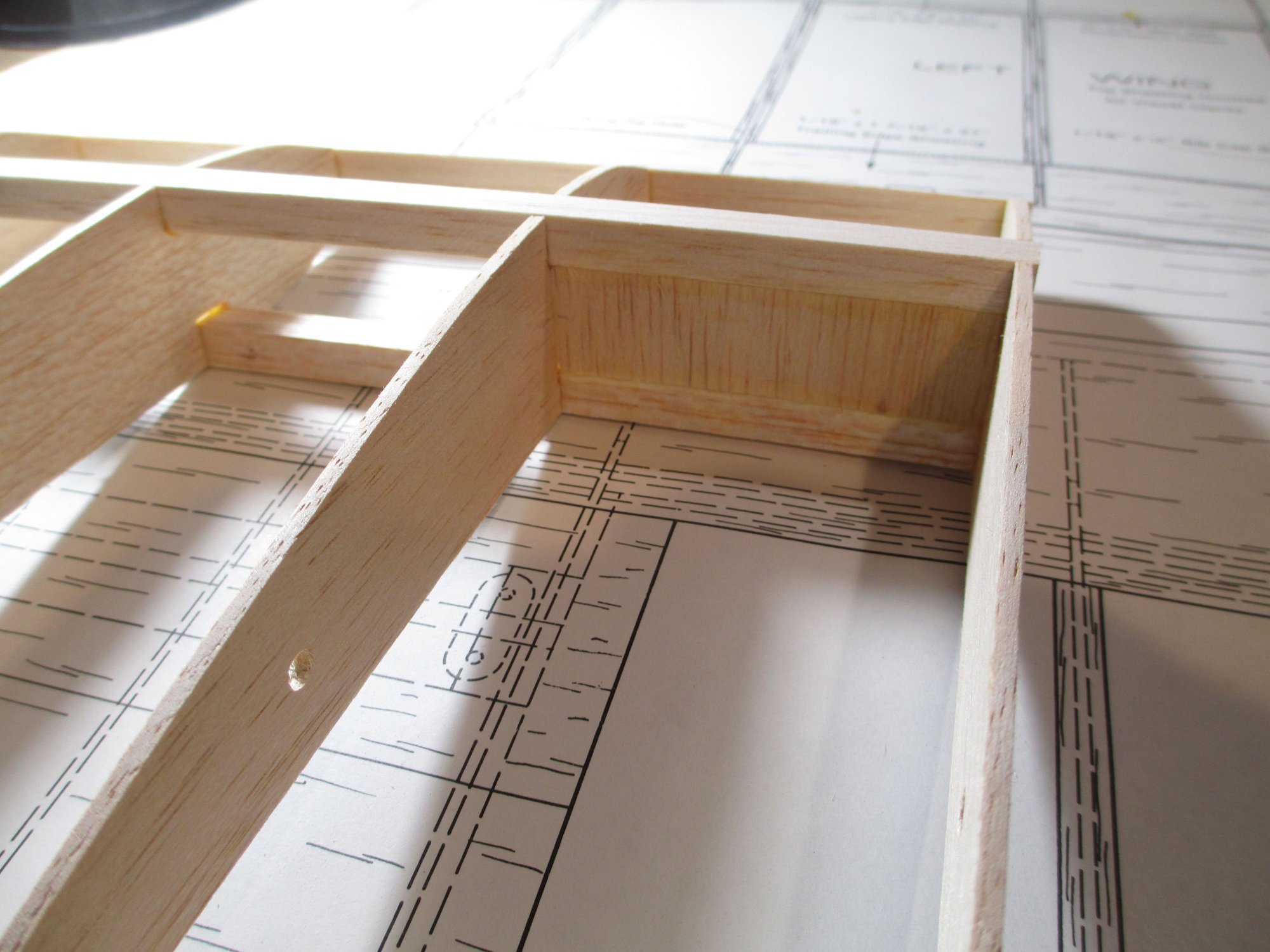

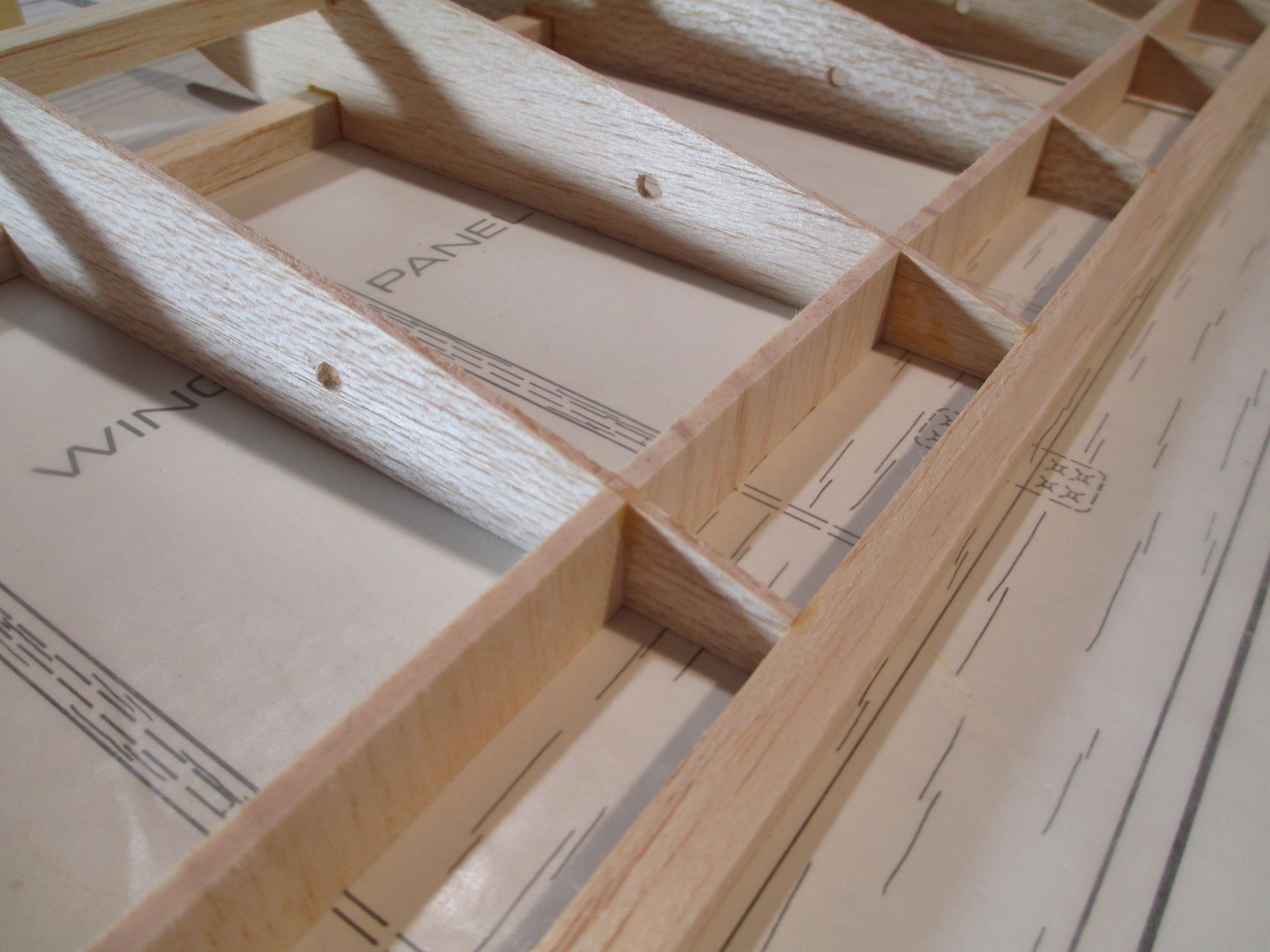

Hinge blocking in place.
I find using aluminum square tubing purchased at local hardware stores very useful during clamping.
To prevent the square tubing from slipping on the Balsa surface I installed 220 grit sandpaper to one side of the aluminum.
I couldn't build without my clamps and wood blocks!
Blocking was fitted and glued to five designated trailing edge bay areas which will give additional holding power to the 1/8"Robart Steel Hinge Points that I plan on using for the ailerons. In my opinion, these hinges are superior to most other hinge types.
Having carefully sanded all of the wing ribs so they are uniform is now paying its dividends. Applying the leading edge to the front of the ribs fit perfectly. As you can see I use aluminum square stock which I keep in different lengths as well as aluminum angle stock to aid in keeping everything straight during the clamping process...
Building Tip: Don't try to install your Spars, Leading Edge stock , Sheeting, etc. to fit exactly, rather let them run proud off the edges. It is much easier sand them all at one time after the wing is completed.

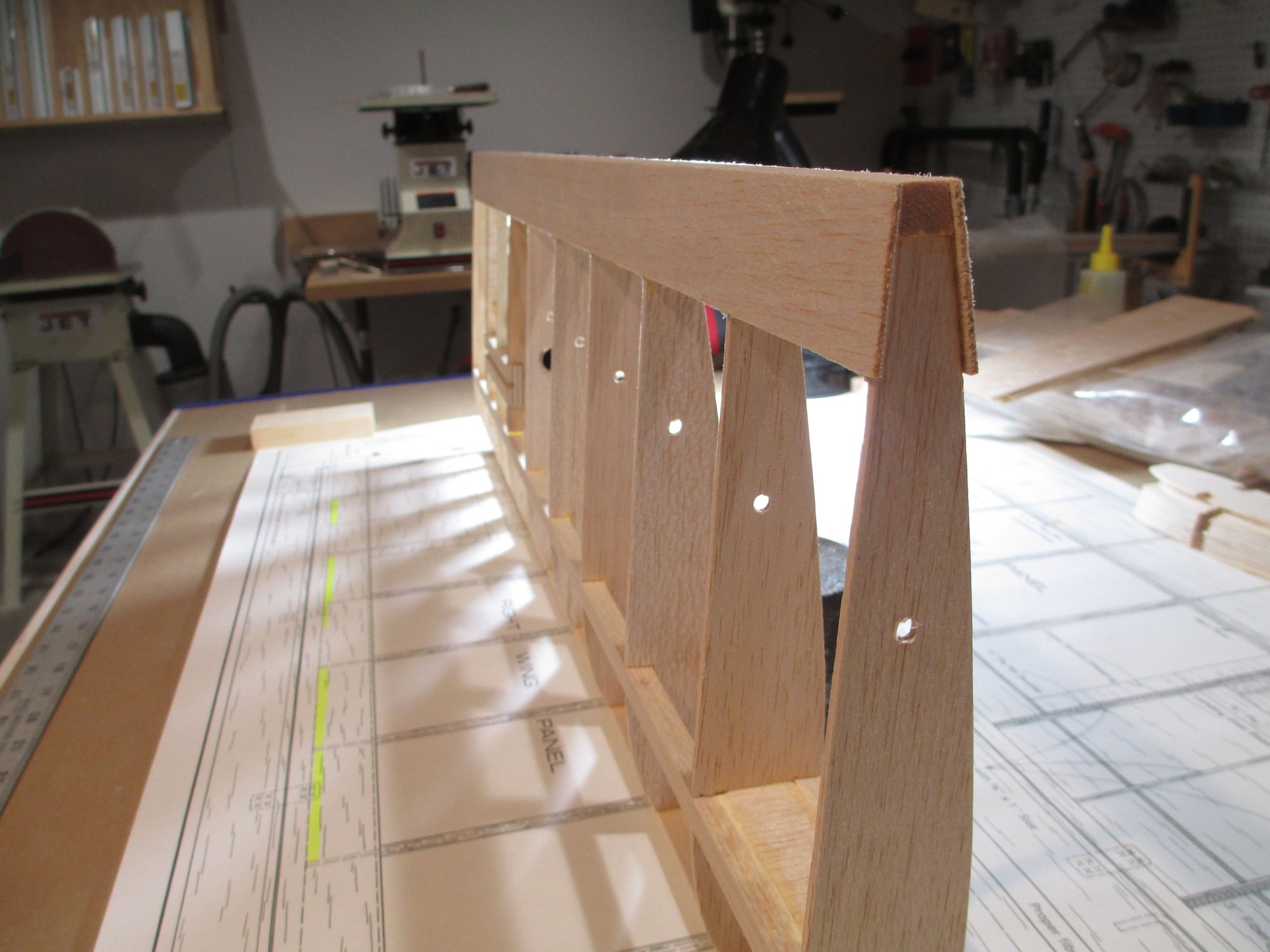

Top and bottom sheeting installed.
It came out straight!
First of many shear webs cut and fit into place. Because the spars are offset to each other the webs cannot be glued to their sides which would have been easier.
Woke up rather early this morning so I decided to head down to my workshop and glue on the upper and lower trailing edge sheeting. 1/16" x 1-716" x 27" sheet stock was used, how's that for a weird size...nonetheless I got the job done.
Before the sheeting can be placed over the leading edge, the 1/8" thickness shear webbing (or as the plans call it "compression sheets" ) needs to be fitted and installed. I'm not happy with what was supplied in the kit, they don't fit tight enough for my liking, besides my OCD tells me NO WAY!!! So, I have to custom cut and fit each shear web for each bay, gonna take me awhile...

Got all the shear webs in place (back view).
Here's what they look like from the other side.
While not called for in the plans, I added some triangle stock for additional bracing/support on the ribs that support the landing gear mount.
Well after some considerable time cutting and fitting those compression sheets (shear webs), I got them all to fit pretty well. I added (epoxied) a small 1/8" plywood support to the back of leading edge that will give the wing alignment dowel the support that it needs. Sorry I forgot to photograph that. Soon as the epoxy sets-up I'll be able to sheet the rest of the wing as outlined on the plans.
Building Tip: While it may seem obvious, strive to get all of your wood joints as tight as they can be. Loose/ill fitting joints will fail over time. By taking the time to get your joints tight, less glue will be used and of course you will not only have a stronger plane, but you will have one that weighs less...
