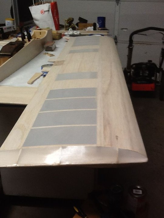

Sig Koverall should work good for you. This is my first scratch built after being way from hobby 30+ years. Koverall made me look good. Latex painted.

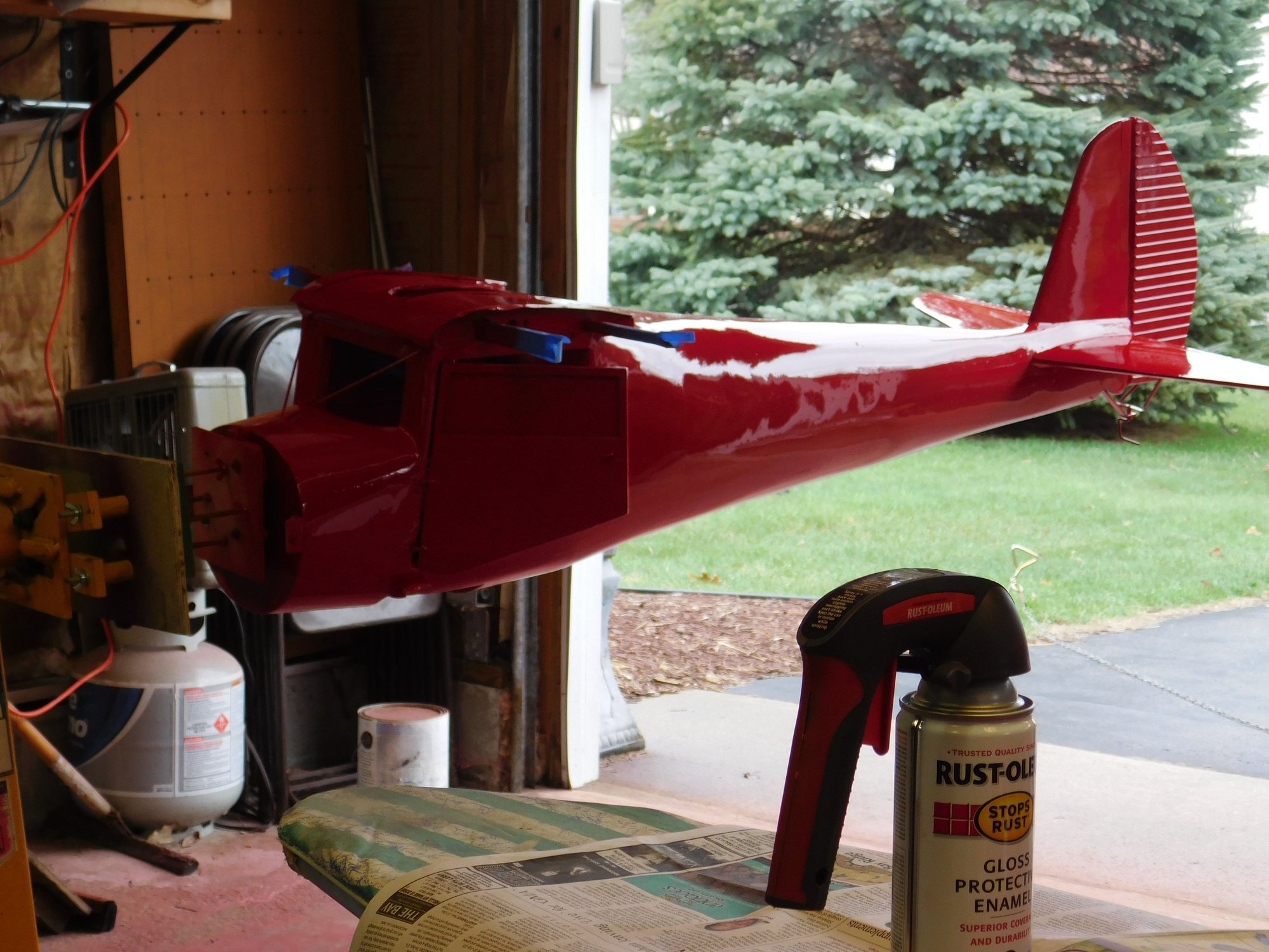

If your compressor is too small, this may interest you.
I have a large compressor, but prefer to use aerosol cans.
