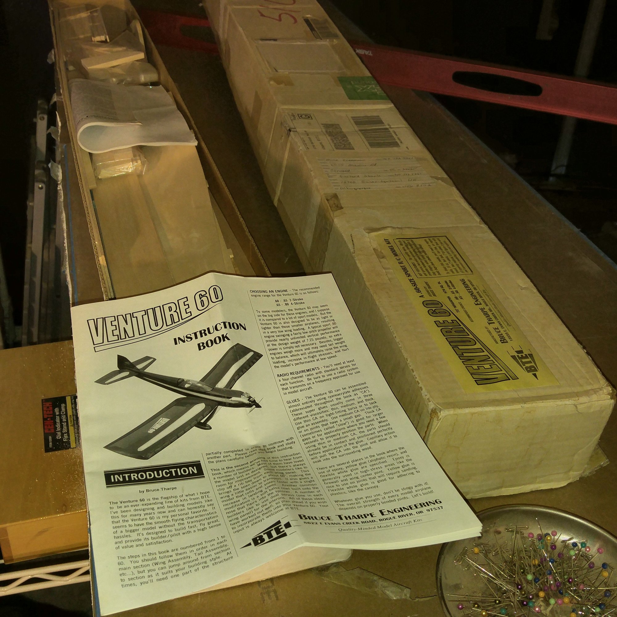

I built a Sig LT40 from a kit years ago and I enjoyed it! Now I want a BTE Venture 60 as a second airplane. But the parts aren't labeled and I'm scratching my head some and will need some help on this kit. I started the wing but haven't glued anything yet.

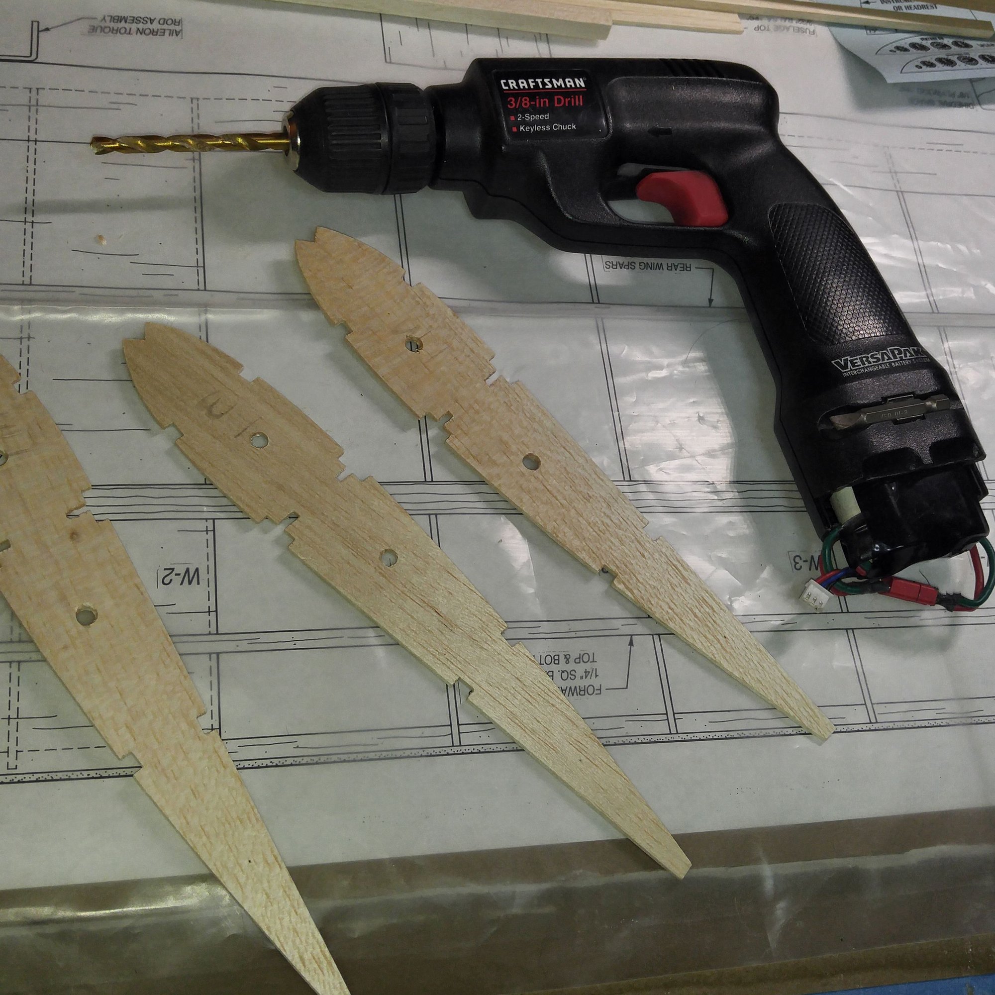

Drill (2) .250 inch holes in ribs

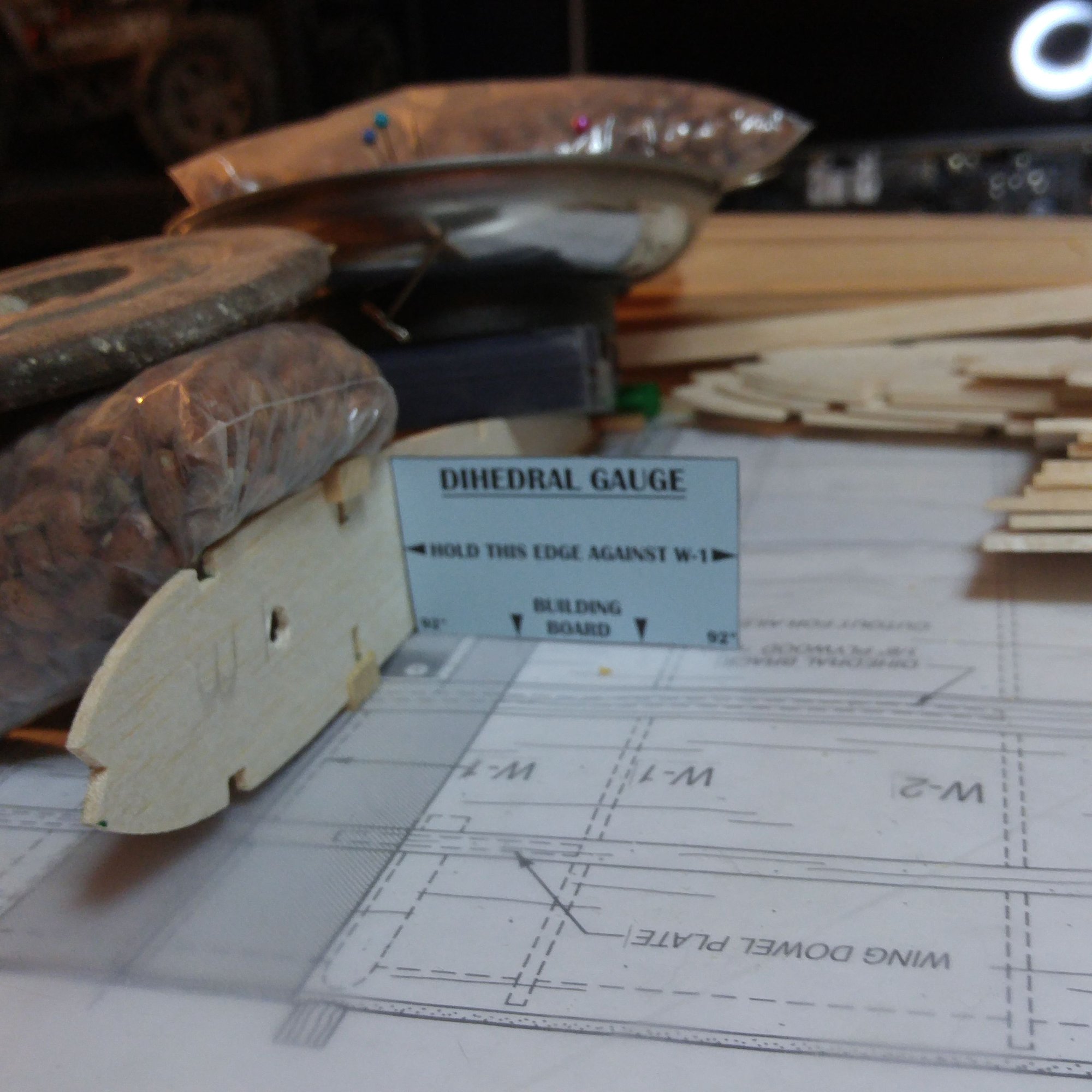

Set dihedral of the root rib
Venture 60 kit

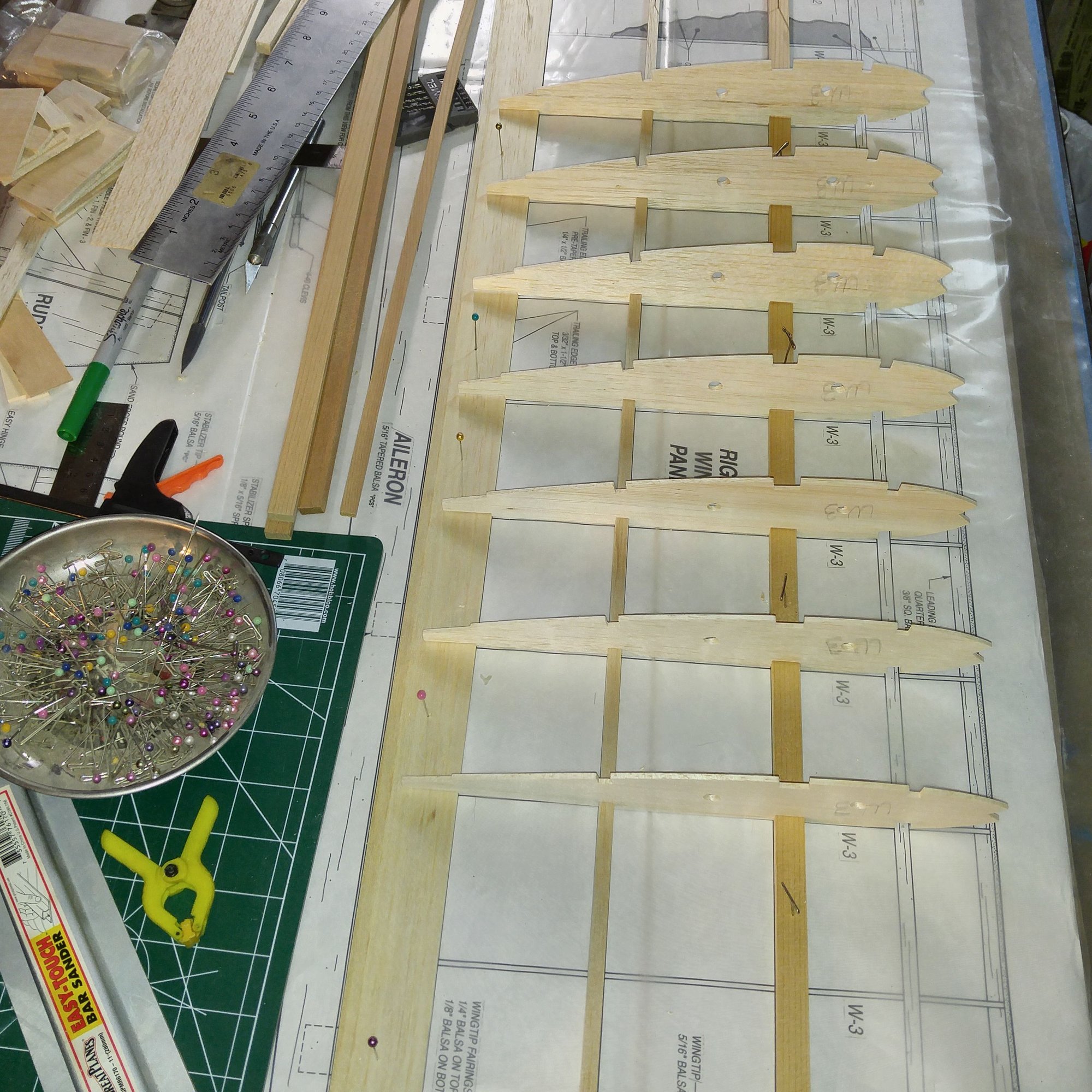

Pin down wing panels

Don’t forget the rib holes for your servo wire. Best do them before gluing wing together. May need to widen those in the ribs. Didn’t see them at first.

Thanks Etpilot! Yeh I thought of that, if I take the servo wires out of their futaba plug ends they will fit thru current holes.

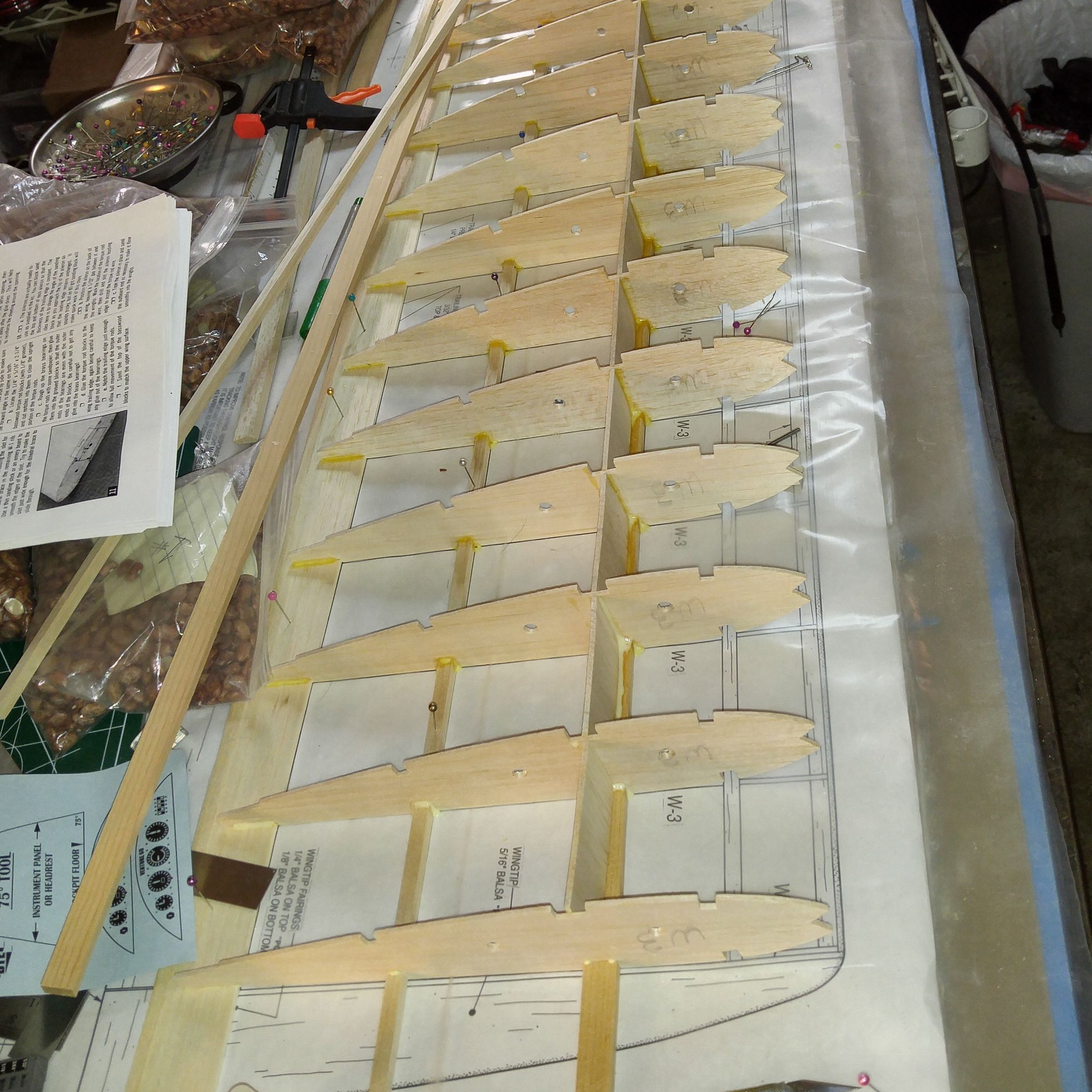

Default Ribs and shear web glued down
