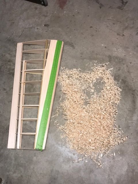

Thank you guys😊 I went ahead and added som balsa to the inner part of the LE to get it to match the thickness of the wing. However when I set
the LE up against the wing it just looks wrong when it comes to being able to sand the front of it to the correct radius on the inner thicker part of the wing. Maybe im overthinking it. I'll drop a photo of the issue.

That LE stock should plane and sand to shape just fine.

You beat me to it. That will work fine. I would shape it with a razor plane to get it close and final sand it.

As suggested, use care not to sand the tip LE sharper then the root. Also make certain the radius is perfectly symmetrical. If one side is slightly different it will show up as needing some aileron trim and will always favor dropping the same tip during stall.

After you complete your text for your post, make sure your cursor is 1 or 2 lines below and after the text. Your pictures will then attach after the text.
If if you happen to leave your cursor within your text, as when you review it, your pictures will post there. Ive had that problem and finally figured it out.
and yep, razor plane and sanding.
