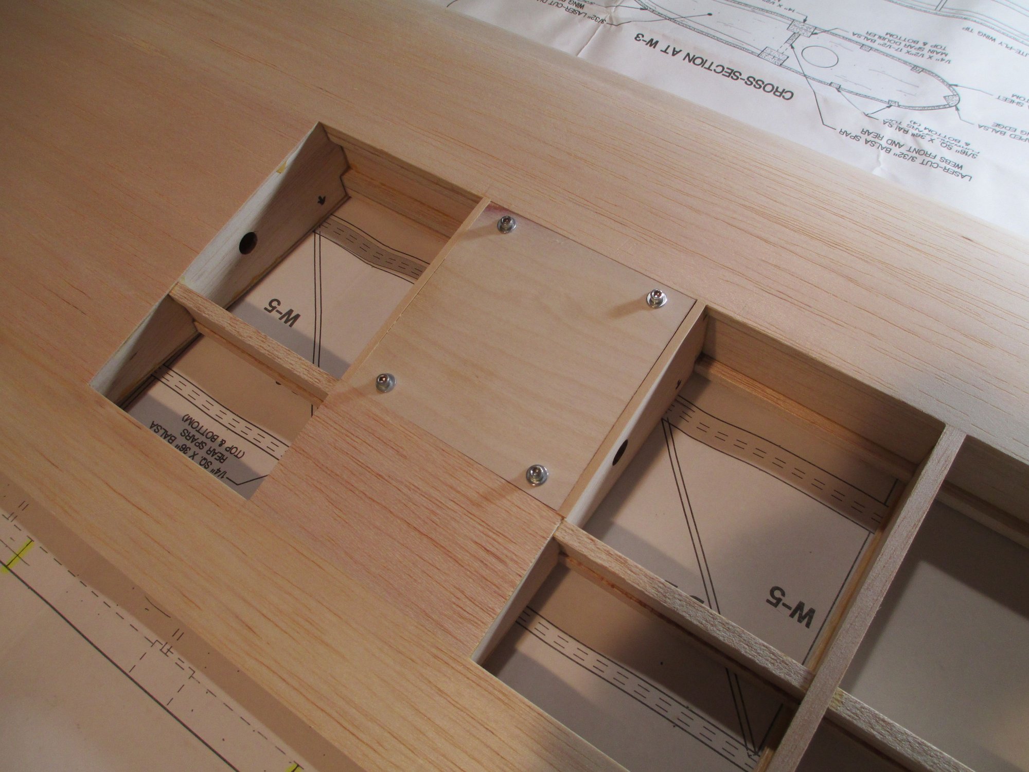

These are two brackets made from Basswood. They will hold the aileron servo cover to the wing. Each bracket is made from 1/2" x 1/8" stock epoxied together forming a 90 degree angle. I further reinforced it by gluing in a short length of Balsa tri-stock for good measure.
The brackets are epoxied to the sides of the front and rear spars. Four 4-40 cap head screws will secure the cover in place.

With the brackets (that I made yesterday) now in place, the servo hatch covers were fitted and secured using four 4-40 cap head screws.

Tonight's task was to get the servos mounted. It's pretty clear now to see how all the pieces come together; the aluminum mount, the servo and hatch cover. I love it when a plan comes together!
The slot that the servo arm slips through may have to be lengthened once they are operational, but for now it is good.
I realize that I don't have the same color hardware, that will all be rectified on final assembly...
With the titanium turnbuckle in position, I can now determine the exact placement of the aileron horn. More on that later...
To some, it may look like a block (2'' x 3'' x 12") of balsa, but to me it looks like a wing tip!!!
