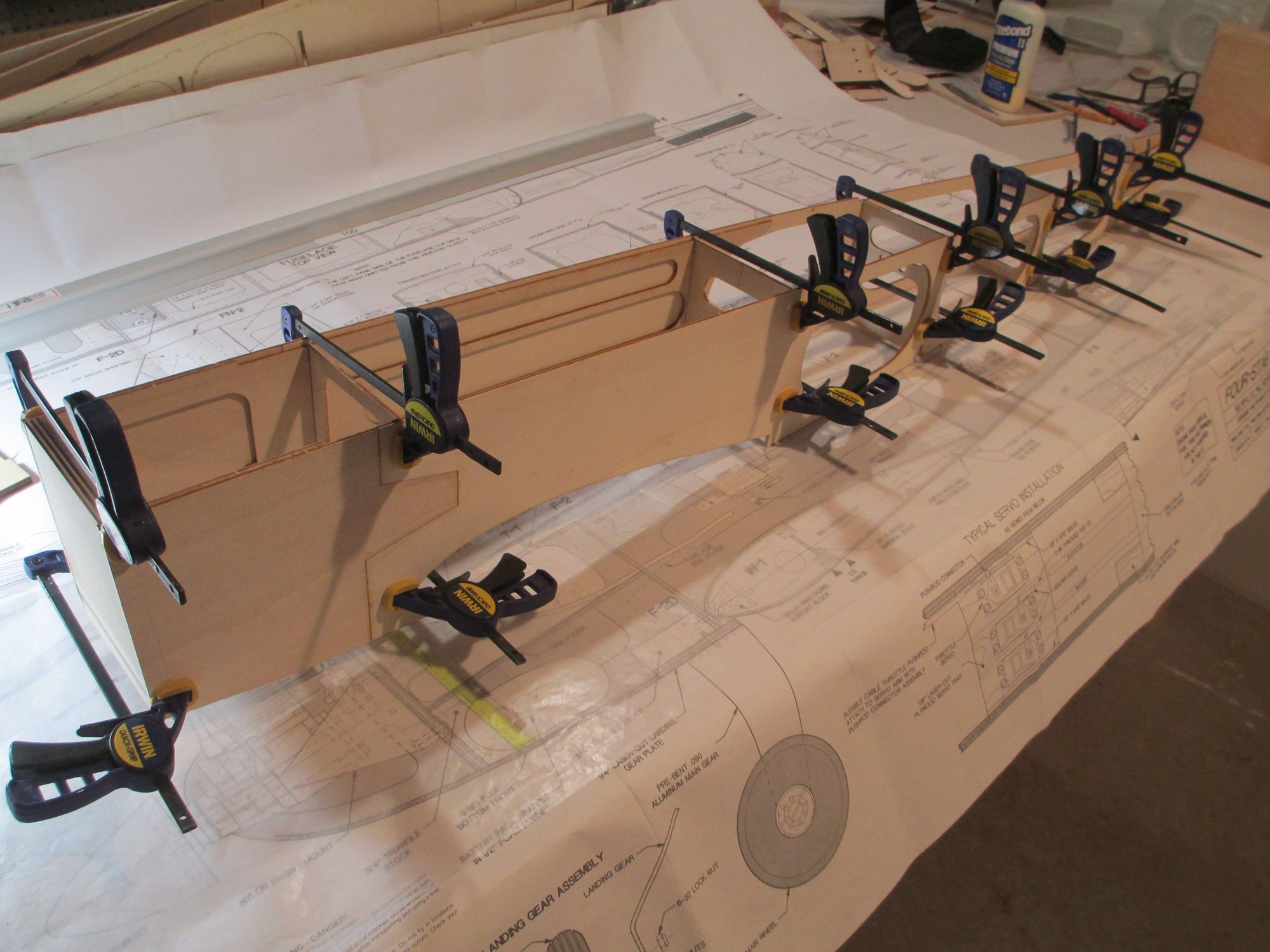

Time to start on the fuselage. I have all of my pieces ready (including clamps) on my work table.
I took the time to place center lines on both sides of each Former which will help in alignment of the fuselage when the time comes.
Stock firewall on the left and its replacement on the right. Besides the increased thickness, note the angled bottom of the firewall to follow the bottom profile of the fuse.
It isn't the time for glue-up quite yet, its wise to dry assemble the fuse using clamps making sure all the joints fit properly. Now is the time to get it right. The construction method used on this fuselage is a lot like that used when building my Tiger 60.
No surprises with initial clamp-up. Now I need to cut and fit 1/16" birch ply to both insides of the fuselage between the firewall and F-1. This will really give much needed strength in preparation for the DLE-20.

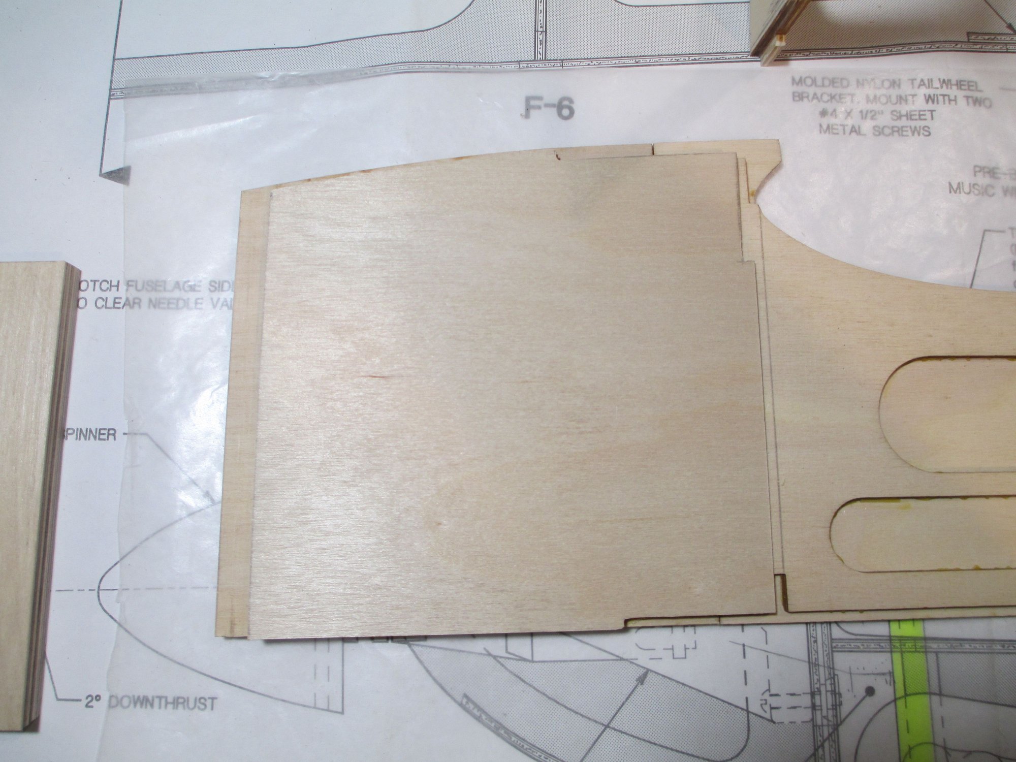

With the 1/16" birch ply in place and epoxied, Former (F-1) is glued in place making sure that it is dead nuts square.
Note- 30 minute epoxy is used in areas indicated. When I use the term "glued", I am referring to Titebond ll being used.
For comparison sake, the right and left fuselage panels are shown. The void in the bottom panel is filled using the same ply removed from the laser cutting sheet.
The plug fits perfectly.
The birch panel it cut and fit into position, now it's time to mix-up some epoxy.
Heavy flat weights are placed on top to ensure good contact between each epoxied panel. Just have to wait for the epoxy to cure...

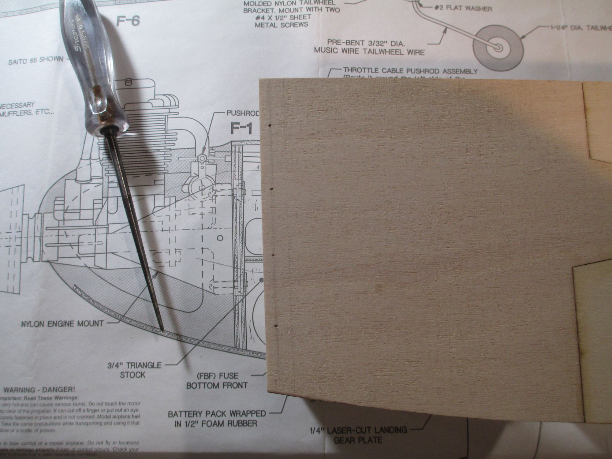

Firewall is epoxied into the fuselage.
Checking square, should be no surprises.
Front of fuse is spot on to the plans and the revisions I had made. You can see the angle on the bottom of the firewall how it conforms to the bottom.
I decided to pin the firewall in place. It will really lock the firewall to the sides of the fuselage. Here you can see my layout lines.
Four 1/8" holes were drilled using a brad point bit on my drill press.
I cut eight pins roughly about one inch in length. If you look carefully you will see that I chamfered one end of each pin.
A drop of glue was spread into holes using a toothpick, then each pin hammered into its opening and trimmed off.
After a quick sanding here is the final results.

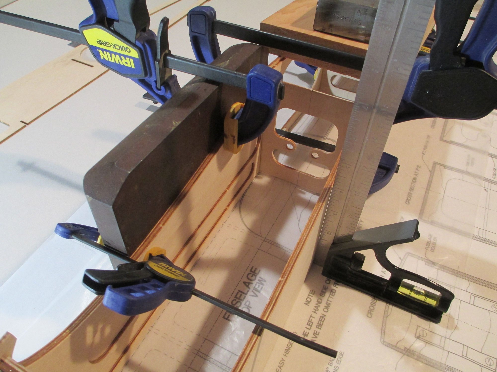

I like to assemble this type of constructed fuselage in the method that I've shown. I know better than to try and assemble the entire fuselage with rubber bands to hold everything together. The chance of building a "bananna" fuse doing it that way will be your likely result. Use the TOP of the fuselage to your advantage, as it's perfectly flat, which is why you see it placed on my build table in that orientation. Constantly check your square and revisit all the center lines and you will be just fine.
If you recall in an earlier post, I recommended marking the center lines on all the Formers. This is where and when it will become an asset helping you build a straight fuselage.
I have various blocks of steel that are perfectly square that I have collected over the years. Many of them I purchased for next to nothing at yard sales.
I will use the blocks mass to clamp off of it making the side of my fuse plumb.
Additional weight on the top will make sure that the top of the fuse makes contact with my flat build table.
Don't be afraid to be creative using clamps to get the job done...
I couldn't install this Former (F-6), as the top of it which is part of the turtle deck would prevent the fuse from sitting flat on the table. I'll install it after the glue dries on all the other Formers.

3:30 in the morning is quite early, but that was the time I got out of bed and entered my workshop. I was eager to remove the clamps and weights off the fuselage. As each clamp was removed, I was looking to see if my fuselage would move or twist. With the last of the clamps released I'm, happy to report that my fuselage didn't move and is indeed straight and true! So before going upstairs to make my morning coffee, I turned the fuselage over and glued F-6 (the last Former) into position.
Now for that first cup...
