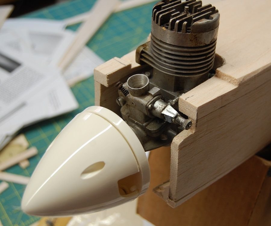

Shaping the nose. There are lots of airplanes that have an engine just hanging off of a firewall. The fly well but most of the time you wouldn't call them pretty. The carved nose is one of the things that makes for a good looking airplane, at least with the Super Kaos. At this point is is necessary to be able to mount up the engine.
The engine I am going to be using is a Fox Eagle .60 . This one needs to have the castor residue cleaned off of it but it is strong engine, barely out of its break-in period. The case on the Eagle series of engines is pretty large and takes up most of the room in the engine compartment. It also requires a little wider than usual engine mount. A smaller case .60 would probably give you a little more room. The SPA also allows you to run up to a .91 four-stroke. If running a four stroke you should probably plan for a little longer nose. If you choose to go electric it is possible to have a really slim nose. Again you may want to plan for a longer nose but more to address the balance than for the addition length of a four-stroke. The plans call for 2 degrees of down thrust. If you are using the built in hardwood engine bearers this is designed in but if you are using a plastic engine mount build the down thrust into the fire wall or plan to shim the engine or the mount to get the desired down thrust. The plans don't show any side thrust.
Being able to mount the engine in its desired position is important for lining up the plywood nose ring. Laser Works supplies a couple of plywood nose rings that are the diameter of the spinner called for on the plans. In this case 2 3/4 inches. I added about 5/8 of an inch to the nose to get to front of the engine and centered the ring on the snout of the engine. How much material you add will depend on the length of your engine. At this point it is a process of carve and sand away anything that doesn't look like a Super Kaos. It's a little crude at this point. You can also see the outlines where the plastic mount will go along with the cut marks where the beam mounts would be if you were using them.
With the engine and spinner in place you start to get a picture of how the shape of the nose will flow. Lots of sanding to do yet and I've only begun to shape the top of the fuselage.
I haven't yet added the balsa block that will form the bottom of the fuel tank and engine compartments. Adding this component will do a lot to fill out the shape of the nose. Shaping the nose isn't difficult but it is time consuming. It isn't a scale model so getting a particular shape isn't critical. If it is symmetrical, smooth and reasonably streamlined it will work. Even a ham fisted individual such as my self can get something that is aesthetically pleasing if you take you time with it. This one is still rough but you can see the shape starting to come out.

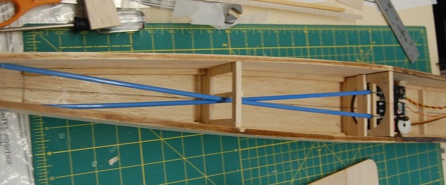

I'm leading off this post with a photo of the top deck back at the tail. You can see where I have marked out the slot for mounting the fin. It isn't shown on teh original plans but the laser cut parts include a tab on the bottom of the fin. This will provide a stronger glue joint but it is important to center the slot so that the fin sits on the centerline of the airframe and to cut the slot accurately so that there is a snug fit and thus a strong glue joint.
Servo mounts. Just some 3/8 basswood rails for mounting the servos. In hindsight one thing I would have done differently is to mount the servos a little farther forward in the fuselage. With the aileron servos mounted in the wing clearance for the aileron linkage isn't an issue and by moving the servos a bit farther forward it would leave more room for the wing hold down bolts. It's not a critical issue, more just a matter of my own taste. Relating to servos and personal taste, I had a chance to examine a Super Kaos that had individual elevator servos mounted in the tail on either side of the fuselage in the manner of a lot of 3-D airplanes. This was in a competition airplane at an SPA contest. The owner indicated that this setup didn't confer any particular advantage and that if he were to do it again he would just use the stock setup with a pushrod and a wire joiner for the elevator halves.
A view of the front anchor points for the pushrods. Pretty standard stuff. The pushrod sheaths will be tied to the frame before i add the bottom sheeting. The rods cross so that I can get the straightest possible shot from the servo to the control surface.
Here are the pushrod runs from to the nose gear and the throttle. There is plenty of room in the fuselage for the receiver and battery. The passage through F2 is just the right size for the 12 oz. fuel tank called for in the plans. There is plenty of room under the tank for the flight battery but given that the Eagle .60 is pretty hefty I am probably going to mount the battery just behind F2. For those contemplating electric power, a battery tray between the firewall and F2 and a hatch on top of the tank compartment should make for easy access.

Nice build, I'm looking at buying a Kaos short kit myself, even though there's nothing wrong with my scratch built kwik fli III. I love old pattern planes even if they aren't quite as capable as the newer guppy designs.
You are going to add bracing to capture those control rod sleeves, yes? Otherwise you could get some unwanted bendy-bendy. I like to use 1/8" ply, drill holes slightly larger than sleeve dia, cut in half and glue one half to the former and glue the other half on to completely capture the sleeve. I don't use golden rods anywhere in a pattern plane as they can expand/contract with temp changes and mess with trim settings. I do use golden cable for throttle setups when airframe design damands.
Yes, the sleeves will be anchored at both ends and in the middle. I know that everyone has their personal favorites when it come to control linkages but I've personally had good results with Golden Rods. It may just be that their stability exceeds my ability to tell the difference.
