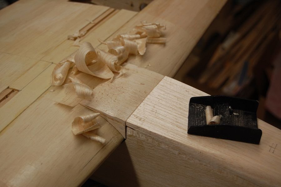

Here is a picture of the shaping in progress. If you keep the blade sharp, even a cheap plastic plane can do a good job. I've also got a couple of small hand planes but I only just got them out of storage and the need cleaning and sharpening.
The shaping tools used on this model. Sharp blades and fresh sandpaper are your friends. Found objects such as the bit of blue plastic tubing can be handy when you want a sanding bar of a particular shape.

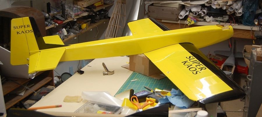

The basic covering is done. It still lacks a canopy and landing gear. The controls aren't hooked up yet. It isn't the most elaborate covering job you will ever see or the best but it satisfies the criteria of high visibility and ease of distinguishing orientation. The rounded wing tips took a bit of effort. I just used the technique of tacking to covering along the rib line of the wing time and then tugging and tacking the covering toward the midline of the tip. There are tutorials on how to do this but I can tell that I need more practice. Aesthetically, I'm still debating on whether or not I should have rounded the corner where the black of the wing tip joins the black of the leading edge. The Super Kaos plans do show a small wing root fairing. I have the material and had gone so far as to lay out the cuts. The bottom line is I just didn't feel like messing with them and the airplane will fly just fine without them. I covered the fuselage before installing the tail surfaces. It's just easier than trying to work the covering down onto the joint where the surfaces meet.
This shows the belly of the airplane. The fairing on the leading edge of the wing was covered in yellow first and the the black of the leading edge was cut to fit around it. There was a question earlier in the thread about how I dealt with the curves on the fuselage. I envy the skill of those people who seem to be able to cover a fuselage with a single piece of covering like it was a piece of heat shrink tubing going around a wire. In my case I covered bottom, then sides and finally the top of the fuselage. If you are careful with your heat you can stretch as well as shrink film covering. In my case I worked the covering around the curves of the nose by tacking the covering down along the centerline and then rubbing the covering with a bit of soft cloth to be sure that it was adhered to the airplane. I let the covering cool so that it is well anchored and then I start heating and pulling the covering so that it conforms to the curves of the nose. You can also see that I have installed the aileron servos and their linkage. The linkage is simple and direct. A ball joint at the servo end minimizes slop and a clevis at the aileron horn provided for fine mechanical adjustment. I'm running my ailerons on a Y-harness but as discussed earlier setting up the ailerons on separate channels is an option along with the advantages that setup would bring.

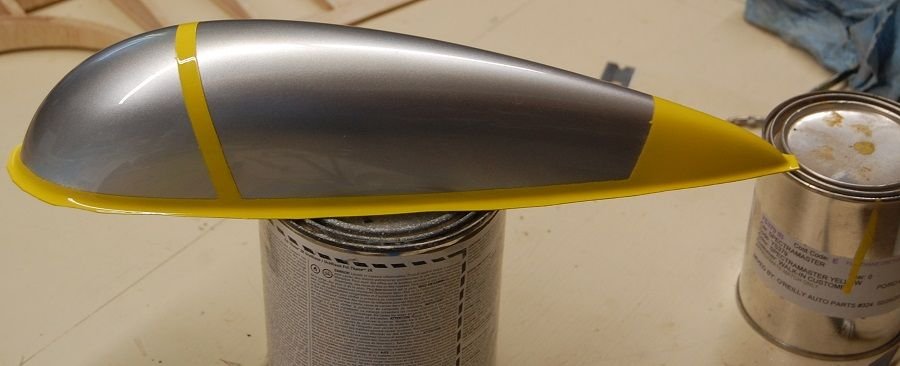

Well Michael, I have to get the canopy on first. The canopy is a Sig product. I think this one is about 12 inches long. I have seen them with much longer canopies. I sprayed the interior with silver model car paint and them masked the outside with good quality tape.
The color is some Nason catalyzed urethane that i had mixed up for an earlier project. It is a good thing that it fit for this project because I had to buy a one pint minimum. I mixed up one ounce and probably only sprayed half of that.
Here is the painted canopy. Automotive paint is pricey but it is tough and it can produce a beautiful gloss finish. I used an old (and cheap) Cambell Housefeld automotive touch up gun to shoot the paint.
