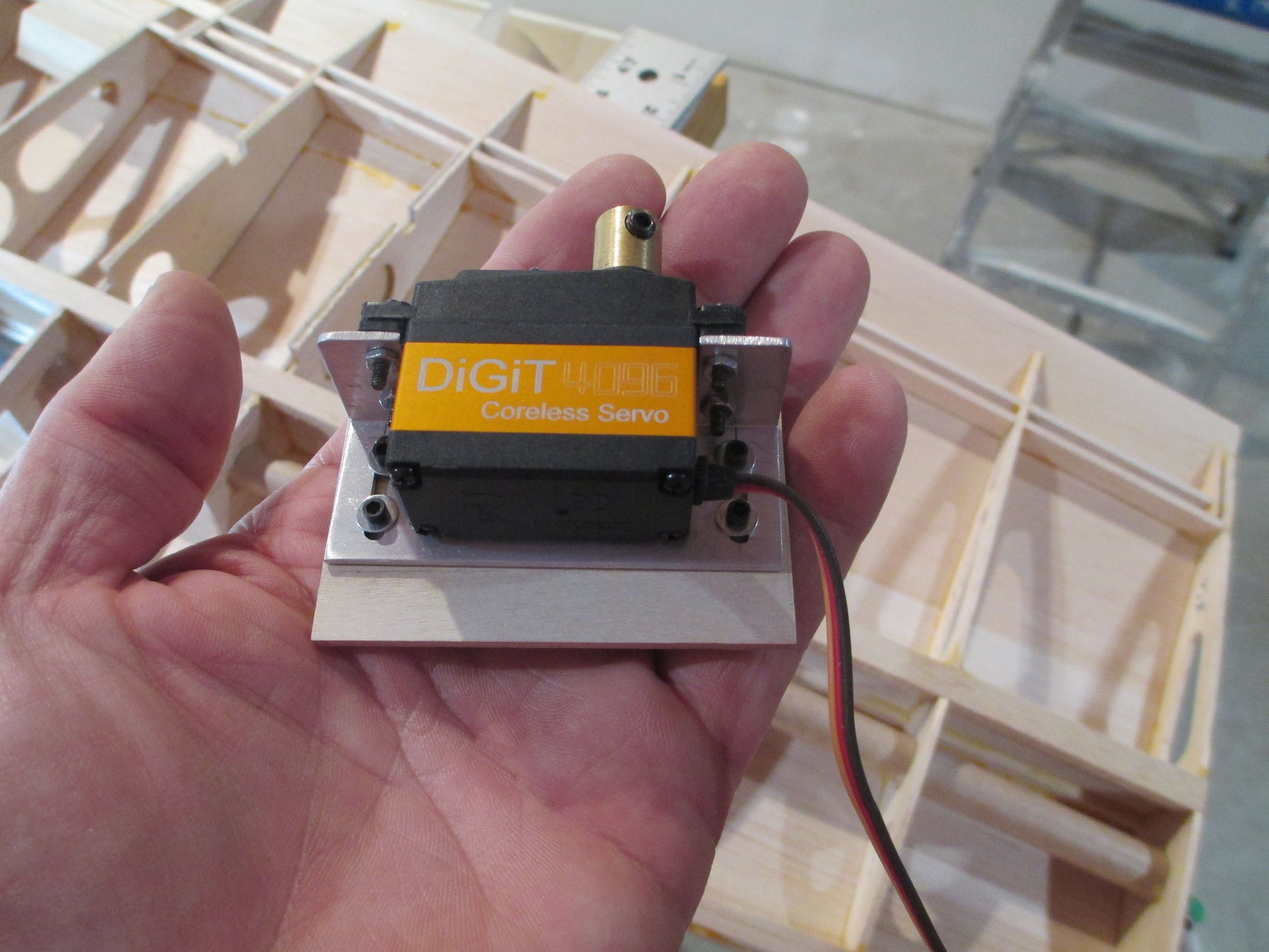

Stopped work on the fuselage for now because I have the parts that I was waiting for to complete the wing. I made this custom aluminum aileron bracket that will hold the aileron servo into position.
Back view of the bracket. These brackets are super strong, light and easy to make with just some simple hand tools. I will take them to my shop at school later and glass bead them to give them a nice uniform finish later.
The servo is secured to the bracket using four 2-56 cap head screws and nuts. As I said, these brackets are super strong and I've never had a failure using them in any of my other planes.
Back view. When making these brackets, be sure to leave 1/16" clearance or more between the servo and the bracket to avoid the air-frame's vibration from getting to the servo.
The bay between ribs W-9 and W-10 will support the aileron servo. I want to strengthen these two ribs by laminating 1/16" plywood to their sides.
Here is the blank that just needs a bit more work before I glue it into position.
Blank is now glued and clamped into position.
End result is a much sturdier rib that will not flex.

All of the ribs that support the aileron servos have been laminated with plywood are completed.
I added two slots at the base of the aileron servo brackets, this will allow the bracket to be adjustable. At this point it may not make any sense, but in sort order all will be revealed...
VincentJ is offline

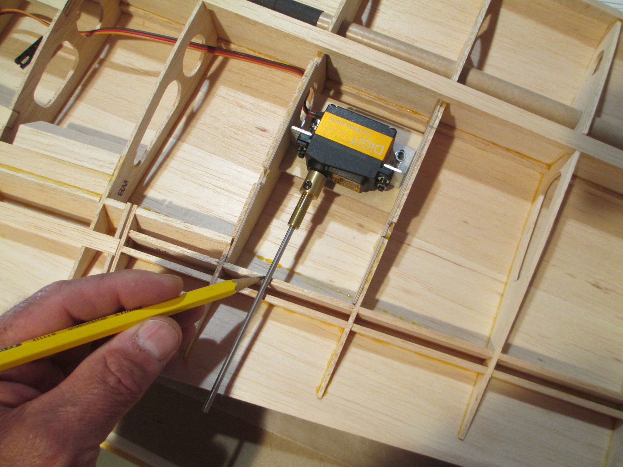

I'm incorporating something that I've never done before in any build. The ailerons are going to operate without any visible linkage. This will be accomplished using a Rotary Drive System (RDS) that has been used by the slope gliding community for some time now. It hasn't been popular in RC scale building, and I'm not really sure why that is. I did a lot of research on the best way to accomplish this task and settled on this method. It was important to my partner Bob and I, as our goal to enter this plane in various scale competitions deduct points for any visible linkages. Not happy with what was on the market for purchase, we decided to make most of the components to fit our needs. Luckily Bob's nephew Scot, is a machinist and made the drive shafts for us! I will be sure to explain the steps involved as well as document each step with pictures to make the process more clear and hopefully brig some attention to this method of actuation...
The servo bracket is bolted to the plywood mount which will get epoxied between the rib bays that I reinforced.
The drive shaft is connected to the splined servo output shaft through a coupler. At this point I'm only trying to determine where the drive shaft will exit the wing's trailing edge.
Using a pencil, I'm marking the exit position of the drive shaft.
The pencil lines indicate the exit position.

The adjustable aluminum servo bracket is held to the plywood mount with four 2-56 blind nuts.
The coupler is secured to the servo with your typical servo screw.
This is the driveshaft separated from the coupler. The driveshaft is made using a 1/8" stainless rod pressed into a 1/4" diameter brass end that slides into the coupler and locked in place with a set screw.
Once the drive shaft is inserted into the coupler, it is locked into position with a set screw. Once I determine the exact spot where the driveshaft is in relation with the coupler, I will grind a flat spot which will prevent the drive shaft from rotating inside of the coupler.
With the servo now in position, you can see where the drive shaft exits is right on the mark!
I need the epoxy to cure then I can separate the servo from the bracket and remove the drive shaft.

Nice Aileron setup!
