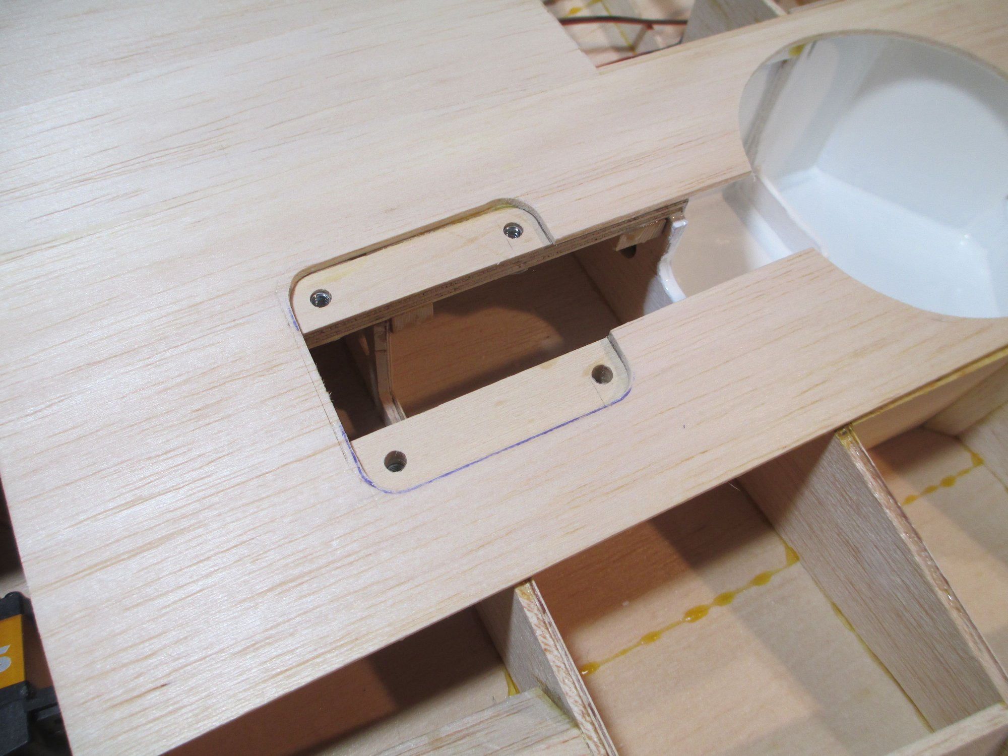

Sheeting is coming along. The hard part is now over. Measuring and cutting around the retracts and hatch covers proved to be formidable and time consuming. It's done and more importantly, it fits!
