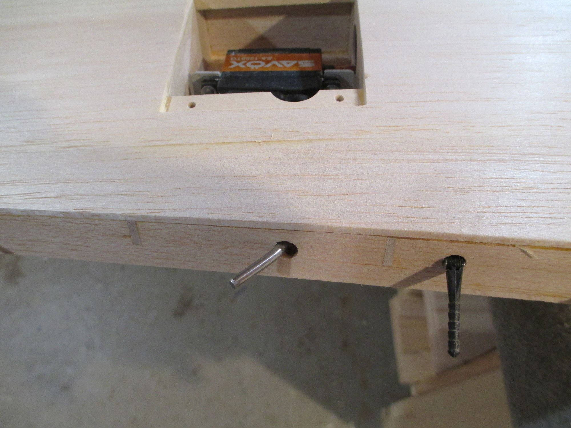

Huge milestone reached today... With the ailerons competed, it was time to cut and bend the drive shaft to see if this RDS really works. The drive shaft shown in these photos is not the actual shaft that I will be using. This is a damaged shaft that I am using as a prototype to see how to get the right bend and length before I proceed bending the good drive shafts.
Once bent and inserted into the aileron pocket, I hand rotated the servo coupler to see if the aileron deflected as I had anticipated. It did, it works! With more throw than I need and absolutely no slop in the aileron. In fact, the traditional method of aileron actuation using a pushrod, has more slop than the RDS! I did take a short video of the ceremonial event.
Drive shaft is inserted through the access hole made in the TE of wing and coupled to servo. I need to fully seat the drive shaft to get an accurate measurement of where the bend will start.
I used a piece of tape to mark where to start the bend.
Clamped in a vise, I bent the end of the drive shaft (which is called the "wiper") at 45 degrees.
The completed drive shaft.
It is critical the bend starts exactly at the hinge line for the RDS to work correctly. Remember, I made the bracket that holds the servo adjustable. It can move forward/backward and even pivot, I can fine tune its operation once final assembled.

What determines the 45 degree bend? Seems to me that you have a fair amount of movement of the surface with little rotation of the servo. If the bend were around 25 degrees it would require more servo movement to det the desired throw and you would gain some resolution. Just thinking out loud here.
speedracerntrixie is offline
Reply With Quote
Old 10-20-2019, 01:46 PM
  #357
VincentJ
VincentJ's Avatar
Join Date: Mar 2011
Location: Peterborough, NH
Posts: 4,000
Gallery
My Gallery
Models
My Models
Ratings
My Feedback
Originally Posted by speedracerntrixie View Post
What determines the 45 degree bend? Seems to me that you have a fair amount of movement of the surface with little rotation of the servo. If the bend were around 25 degrees it would require more servo movement to determine the desired throw and you would gain some resolution. Just thinking out loud here.
Speed, the angle of the wiper determines the approximate maximum deflection. See list below:
AILERON WIPER BEND ANGLE......20 30 35 40 45
APPROXIMATE MAX DEFLECTION 20 24 27 30 33
Your point is well taken, I'll have to check the rotation of the servo and maybe reduce the angle to 40 degrees. Thanks!

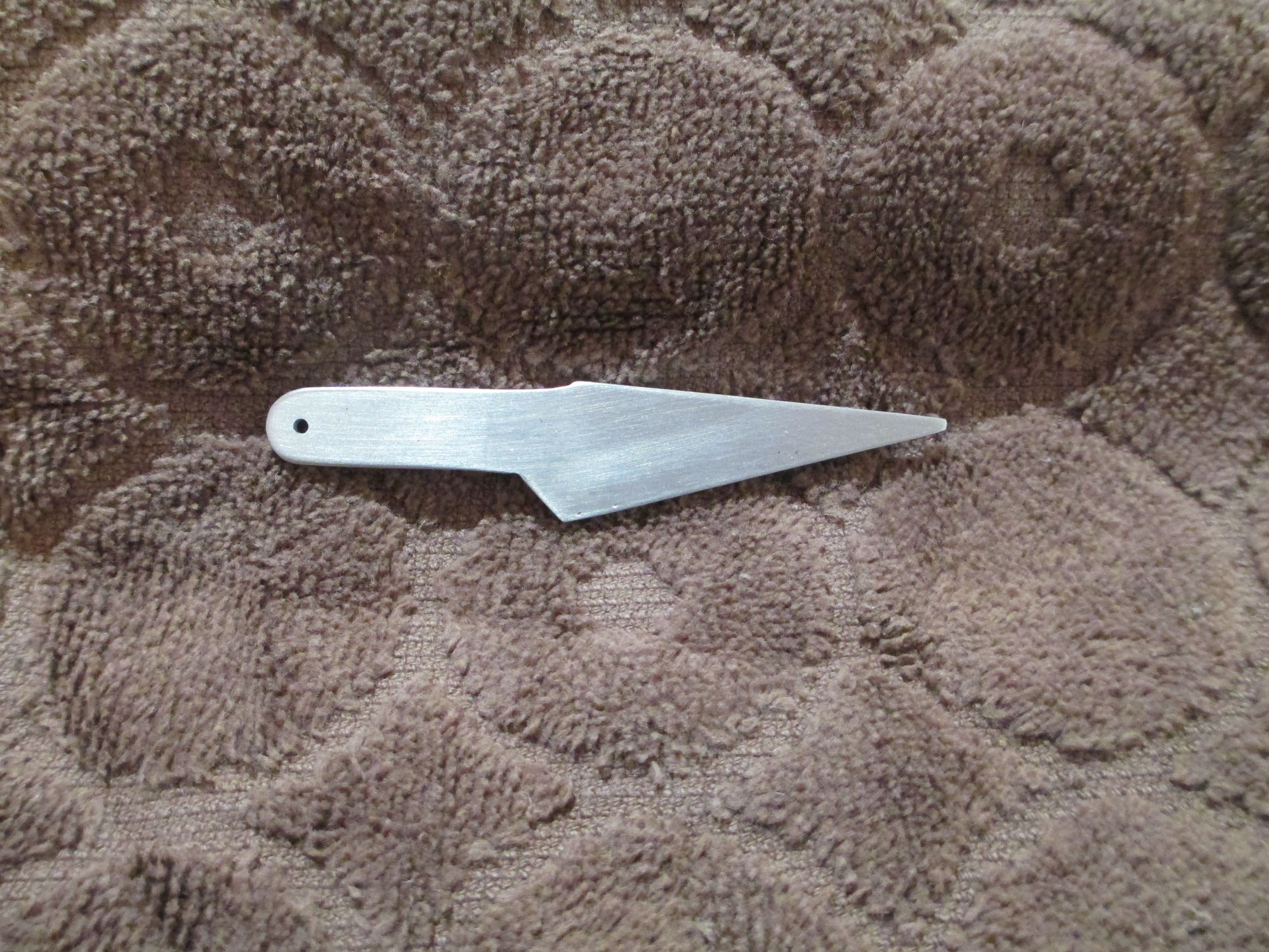

Plan detail for the flap control horn. Stock horn is 1/16" plywood. Again, I'm not comfortable with so much stress being placed on a very thin control horn. Note how close the hinge pin is anchored to the end of the flaps LE. You can see here why I chose to add material to those critical areas.
I decided to make my own horn from aluminum sheet stock (.064 thickness).
Finished product after a bit of hand filing. Light and strong. This should do the trick nicely.
One down, one more to make!
