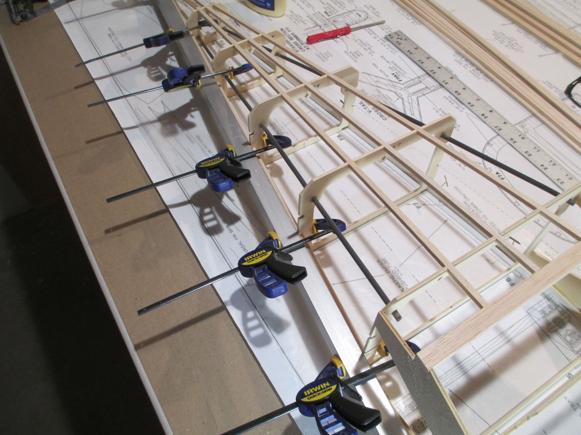

Happy with how each of the formers fit between the side stringers, I glued them all into place making sure each former was plumb.
You've seen my block collection before, they come in handy in so many different ways. Here I'm using them to keep the former plumb by clamping them on each side of the former. Each block is perfectly squared,when the blocks get dinged and worn they get used as kindling in my wood stove!
I wasn't going to glue in the firewall former at this time, but after looking at how the next few steps progress in the build I changed my mind.
The firewall is installed with 2.5 degrees of right thrust and 2.0 degrees of down thrust. The down thrust is set using this firewall gauge (supplied in the kit).

Before the plywood side doublers were installed, I took the time to sand both sides as well as true up all of the edges.
Two 1/8" plywood fuse side doublers get glued to the right and left sides of the fuselage next. I decided to glue the left side on first (remember the fuse is upside down) using my blocks and clamps. Note, in all the photos the plywood is not glued to the firewall former yet.
The blocks help spread the clamping load evenly.
Once the left side dried, I glued on the right side. Here I'm using my clamps across the fuselage. All you need is a small amount of clamping pressure as too much will bow the formers.
Note that the centerline of each former is directly over the plan.

All of the formers were glued to the 1/8" plywood fuse doubler except the firewall doubler. Because of the additional stress placed on this former by the engine, 30 minute epoxy was used.
Just checking the angle with the firewall angle gauge to make sure it didn't move.
Two 24" pushrod tubes were inserted through each former and epoxied into position. To ensure that the epoxy would adhere to the tube, sandpaper was used to rough up the tube's surface at each former location.
I made sure that each former was dead plumb before I spread the epoxy. Also note that the bottom center stringer was added and glued into place.
Before gluing the stringer into position, I checked to see if it had a bow in it. I did, so I took a small file and made adjusts to a few of the formers to ensure that the stringer was straight. It's the small details like this, that ensure that your fuselage will be straight and strong.

The rail is (1/4" x 3/8" basswood) glued into position.
This should give a stronger joint without any weight penalty. Basically a win win situation...
I also ditched the servo trays and made two new ones. I also lowered the front of the tray about 3/16" by notching the top of the former. These will be epoxied into position, but not quite yet...
I have been holding all of my servos in place with cap head screws threaded into blind nuts for years without any failures. I'm not fond of using wood screws to hold servos in place. Here, I'm drilling holes to receive the 2-56 blind nuts.
Gently tapped into position.
Note: Its always a good idea to run a tap through each blind nut before installing them, or at least run a fastener through. You don't want to find out later that the thread has a burr in it an won't accept the fastener.
Each blind nut is epoxied in place.
