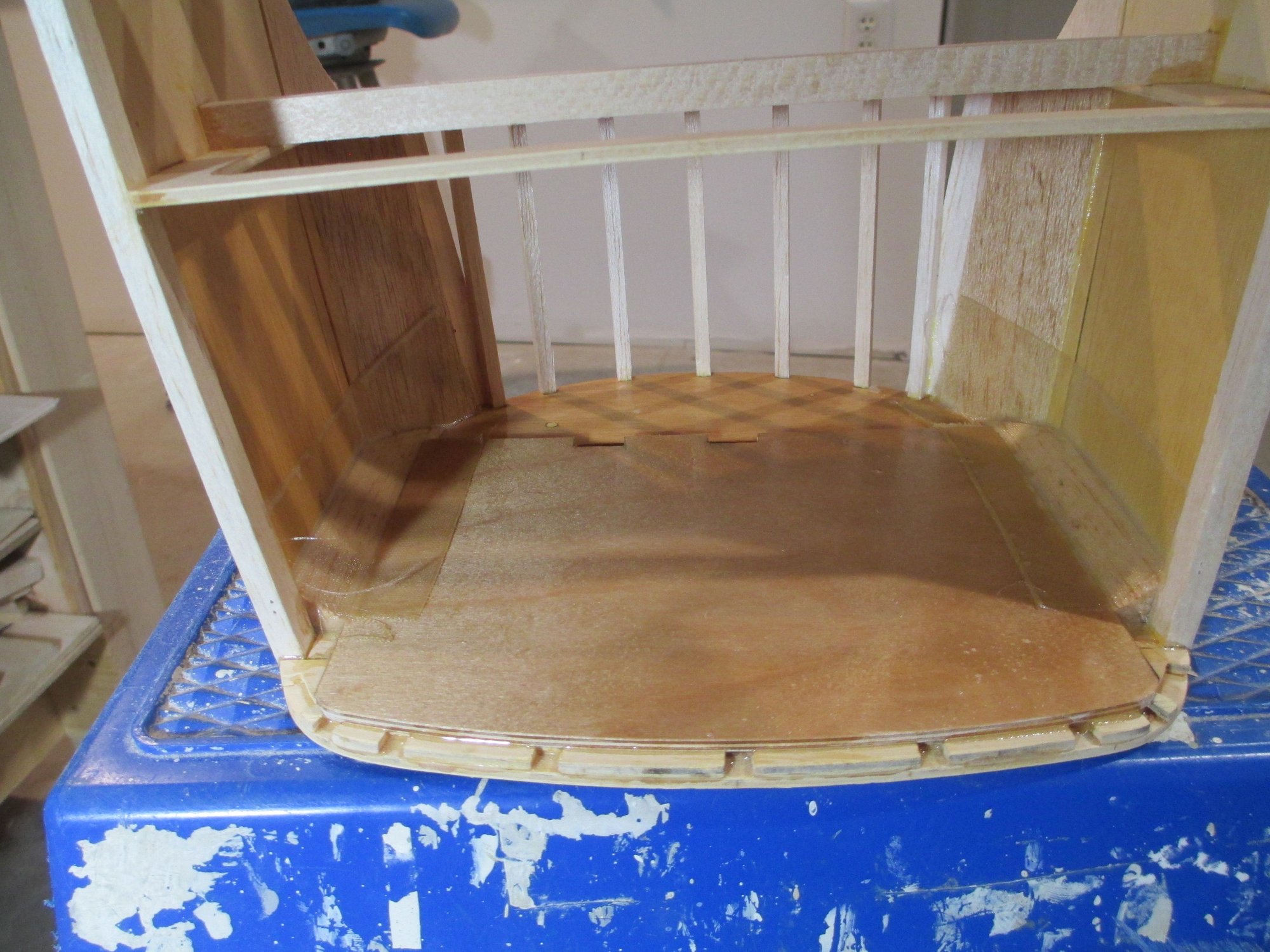

I'm holding the supplied 1/8" plywood firewall doubler against the inside of the firewall. I think I can improve on its strength and thickness.
On the left is the new and improved firewall doubler. It is larger and thicker which will give the firewall a 3/8" overall thickness. It will also give better support for both front landing gear rails.
Time to mix-up some epoxy...

On the Top Flite Cessna 182 kit all the wood in the landing gear area was liteply so I replaced it with real plywood. Did Top Flite do the same with the Bonanza kit?

Mike, the plywood used in this Top Flite kit is real ply not the "fat free" stuff! lol I have been pretty impressed with the quality of the wood supplied.

I really wanted to tie in the firewall to the sides of the fuselage. Gas engines are known to vibrate more than glow engines, so I used fiberglass strips to get the job done.
This is the first of two coats, it will also serve to fuel proof the area.

Nice job on the firewall doubler! Yeah, if those spars break their would be nothing left of the airplane.

Second and final coat of Resin applied over the fiberglass strips. The firewall is nicely tied into the fuselage now.
