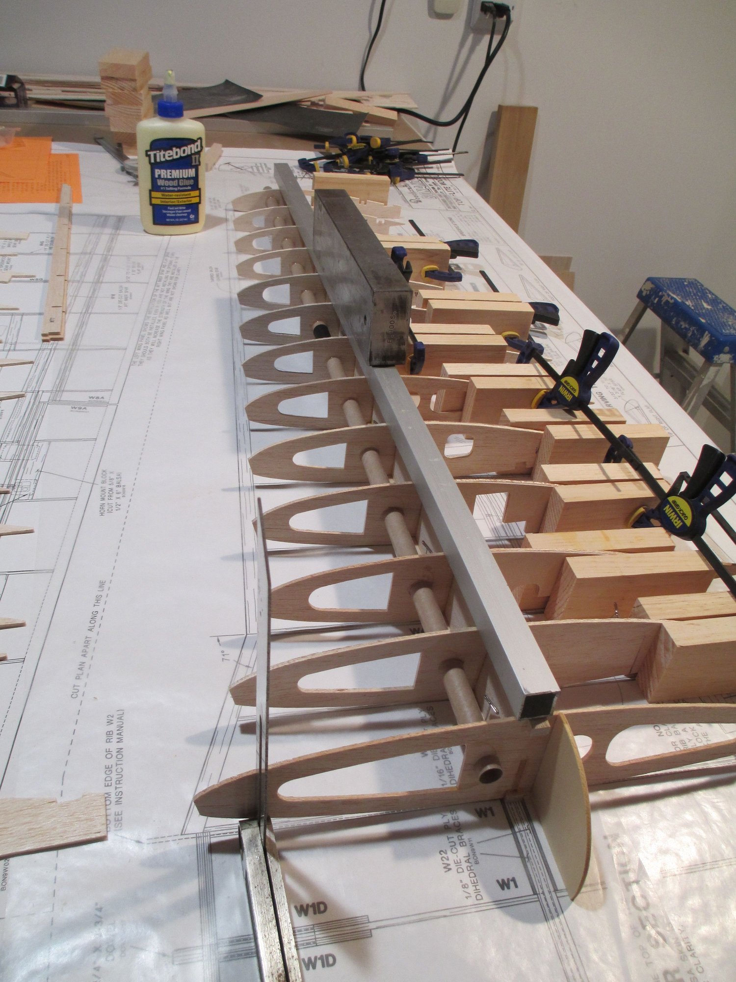

Ask and you shall receive Lupe...
Not wanting to weaken the ribs by drilling holes for the navigational lights, I decided to glue part of the die cut plugs back in place towards the forward portion of each rib as shown.
A hole was drilled in each portion of the plug that will accept a 1/2" Estes rocket tube. This will provide a chase for the wires to slip through without weakening any of the ribs.
I didn't want to drill the holes oversize. The rocket tube fits snug in each opening giving additional strength to the wing panel once epoxied in place. The tube is slid forward to the next rib in place and I simply draw an outline of the tube on the rib.
The rib is removed and placed on my oscillating spindle sander where I get it pretty close to the pencil line.
The rib is re-installed and using deep socket wrapped with 150 grit sandpaper, I get the fit I'm looking for.
The end result is a nice opening without any slop.
Each rib is held in place by placing these simple rectangle pine blocks that I made on each side of the rib with a clamp. I made sure when cutting these blocks that each is perfectly square.
Here's where I keep my stash of those blocks...
These rocket tubes come in a variety of diameters. I'm using the smallest diameter tubes which have an outside diameter of .544 in. They are light and will give strength to each wing panel.

All of the ribs are installed plumb (90 degrees) except for the first rib (W2) which is set at 84 degrees to accommodate the wing's dihedral.
With the rocket tube in place, a small fillet of epoxy on each side of the rib was applied to permanently secure the tube.
The square aluminum stock on top of the wing was placed directly over the top wing spar which was glued into place. This will ensure the spar is making full contact with the webbing beneath.
The rocket tubes aren't long enough to span the length of the wing. To splice them together, I used a short length of 3/4" heat shrink tube.

Build question: did you end up using CA for the ribs to spars or wood glue still?

I can't help but think the Estes tube adds a bit of structural integrity to the wing. Beautiful job!

That part of the build is really suited to using CA, but I did not, I used my Titebond.
