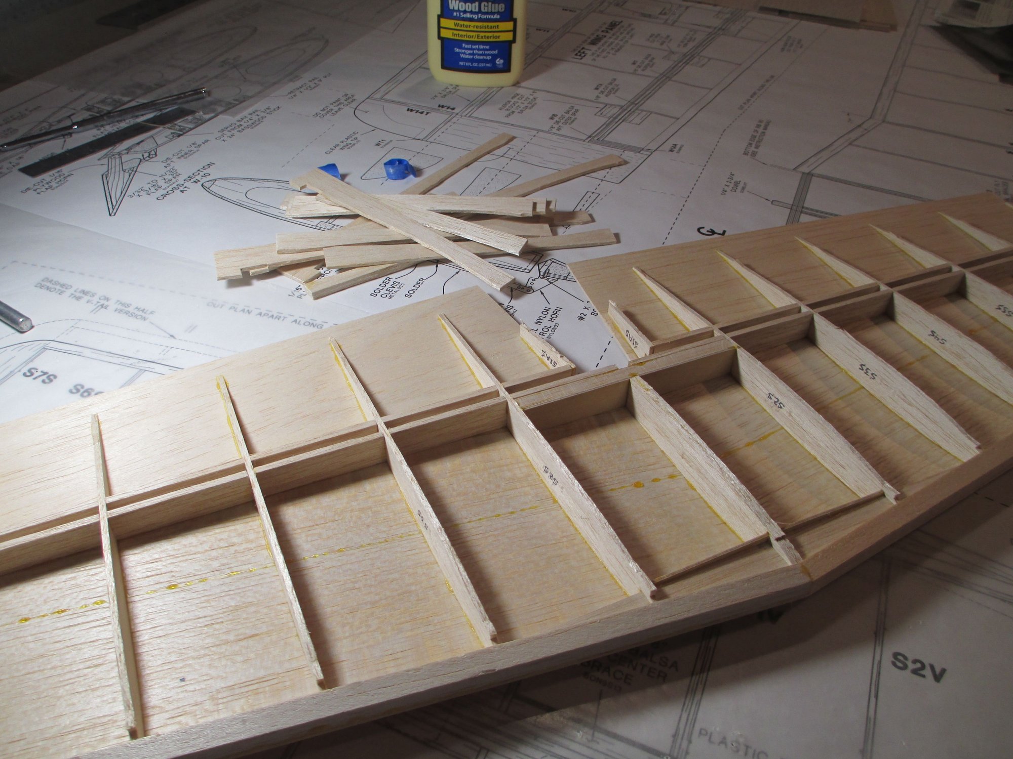

Thank you TF for including ROLLED plans in this kit. It's so much easier to build on compared to folded plans. It's a good thing that I built a big table (4' x 7') because these plans are large! My table is topped with 1/2" sheet rock which protects my table top and will easily accept "T" pins.
I normally like to start building the wing first, but since my electric retracts haven't arrived I thought I would start the horizontal stabilizer. The ribs are die-cut, but many of the cuts didn't go all the way to the end so I had to use a blade to finish the job...I wrote the rib number on each rib as the stamp marks were too hard to read.
Happy with the dry fit of the ribs on the spars, it was time to glue them into place. I don't build with CA, I prefer to use Titebond II.
There are so many sheets of wood in this kit that it was a bugger to locate some of the parts I needed!

Top sheeting of the stabilizer has been completed. At this point the elevator is attached to the stab and will be sawn off once the bottom is done.
Here's a good shot of how each rib's cradle keeps the stabilizer level to the work table during construction. These tabs will be removed once I flip the stab over.
I'm pleased with the full contact that I got between each rib and the top sheet.

The stab and elevators are looking real good. I see a lot of similarities with the stab and elevators on my TF 182.
I have pretty much switched over to Titebond II myself. My current project is a copy of fun scale Ken Willard Sunday Fighters for the grandkids. Progress has been slow thanks to the osteoarthritis in my thumbs and fuzzy vision due to the slow progression of cataracts. The cataracts are to be fixed on 7/18 (left eye) and 7/25 (right eye) and I will be getting new glasses after that. I should be more comfortable with my far vision so I can start flying again. My wife had to have her cataracts fixed back in 2011 so I lasted a bit longer than she did. Osteo bi-flex seems to be helping the thumbs so hopefully I can get back to building to. It SUCKS get older!
