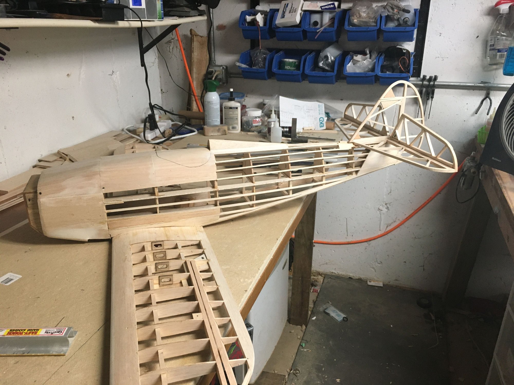

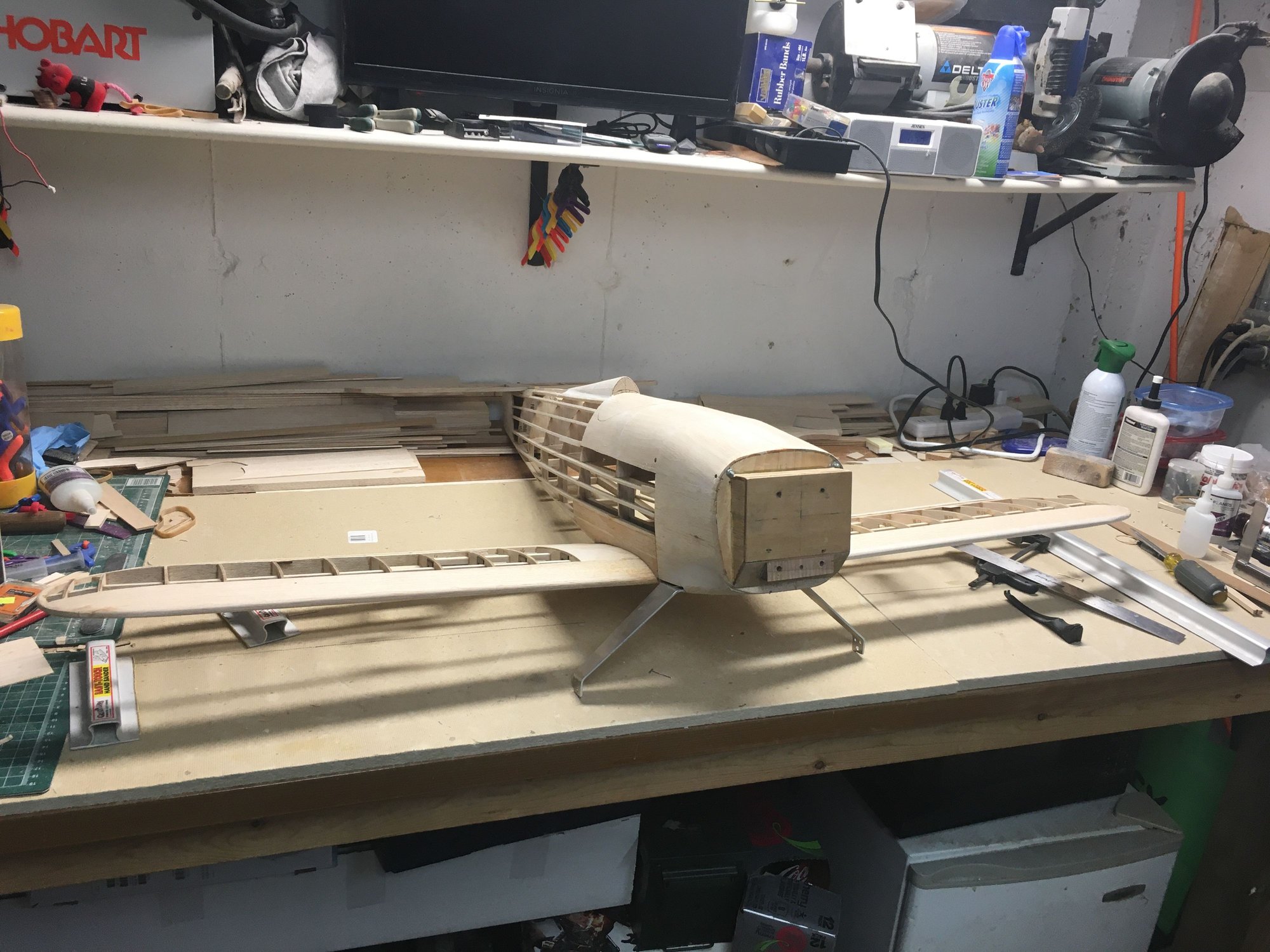

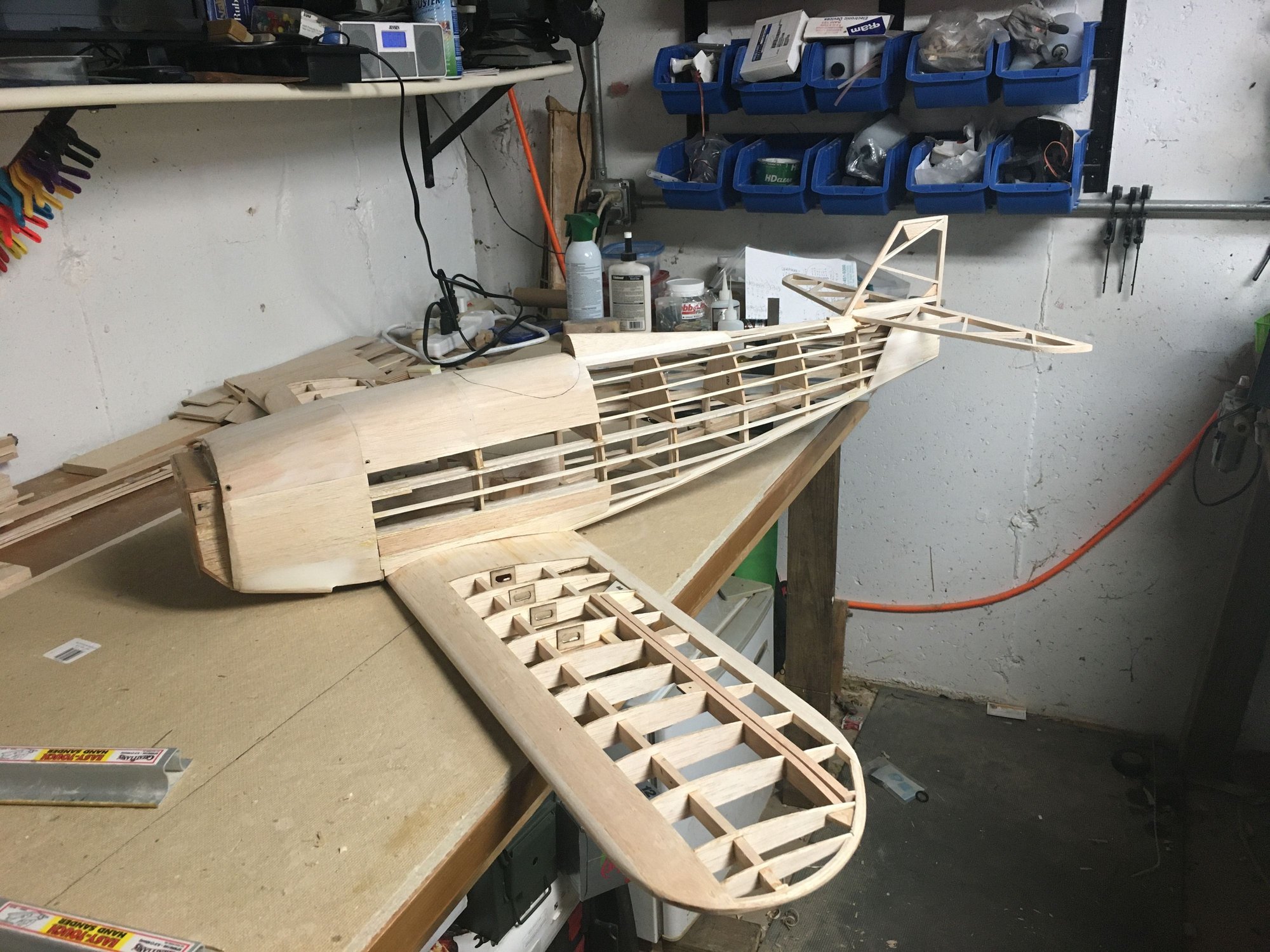

Made some progress today. Got the lower wing center section taped so nice and solid now, and have it bolted in place. Got the stab aligned and the epoxy is curing. Now need to trace out the wing fairing and import that into the computer so I can laser cut the plywood sheet and get the fairings done, and then attack the fuse shaping. Since the elevator has to be hinged before the fin gets glued in, I will just pin it temporarily to block shape where is joins the fuse at the very tail, and then I can move onto the top wing. I also need to study where the tail wire bracing attaches so that I can put the reinforcements in place. I also want to use different hinges for the ailerons and tail, looks like pin hinges will work for the tail, but the ailerons may need some modification to make hing pins work.
Pics to come, have to take some first .
#55
Here are the latest pics. The stab is epoxied in place, shimmed to be level and squared to the fuse, following the plans incidences, which I need to find my incidence meter to verify. I will do that, and then get the thin ply cut to shape for the wing fairings and get that done next.

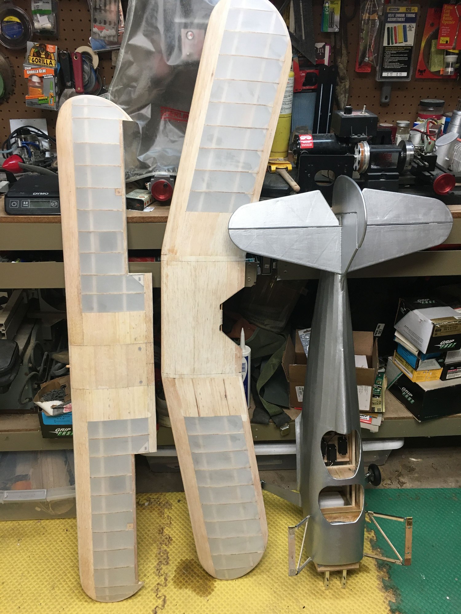

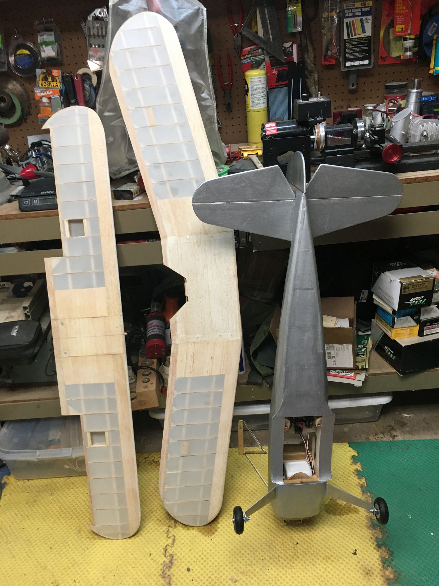

Well, here is the latest update on the build. Been busy with many other pressing projects, so not much building was done, and what was done I didn't get pictures of.
Both wings are built and aligned. Top wing just needs a little touch up of the top sheet and it can be covered, bottom wing needs the ailerons cut out, some final sanding ant it can be covered too. Will need to make the N struts first so they can be aligned properly before covering. Elevator, stab and fin are covered, the elevator is hinged and attached and the last thing I did was glue the fin on. So some final sanding, install of the pushrods to the tail and cut out the cockpits, and the fuse can be covered. Then it is onto the engine and radio install, and final painting, which I haven't decided yet if I want to go all dope, or latex and clear coat over dope. I may do a blend of both, but have to see how clear dope sits over latex first. I just don't want to buy two different quarts of gray as it has two shades in RL.
#58

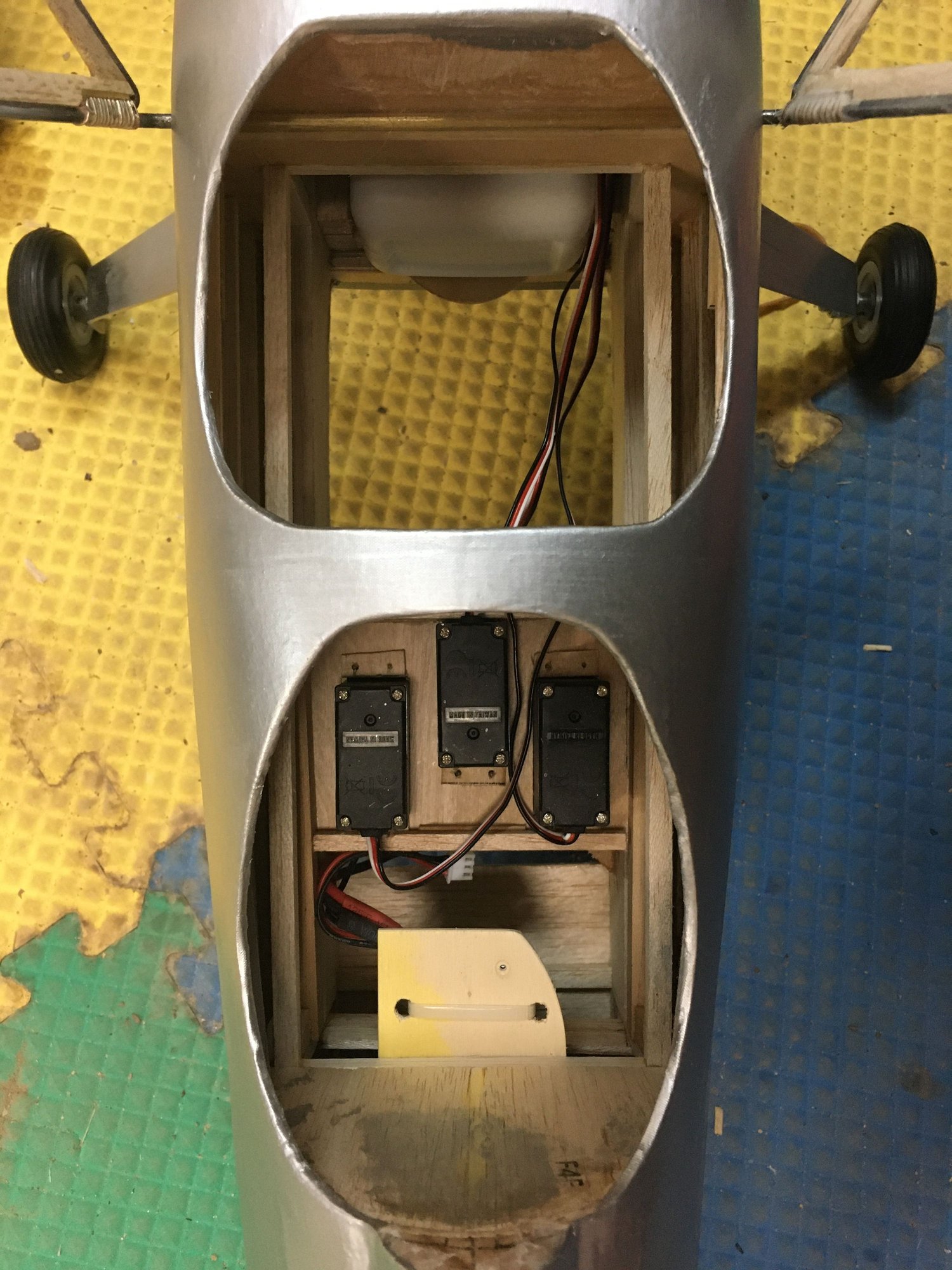

Majority of covering done, just the cabanes and N struts left. Wings have the first coats of Nitrate done, one more coat to fill the weave and then Rand-O-Fill. Fuse has the second Rand-O-Fill coat on, two more coats and it is ready fro the color coats.
Still have the cockpits to make, but will do that last.
A quick look at the plane with the wings. I wont be opening the bolt holes in the wings until full done, this way there wont be dope in the hols and threads, and I plan to put reinforcement rings on the bottom wing too.
I have also swapped the Gemini, which would need 7 ounces of weight in the tail to balance, with a YS 63S. If everything goes right, Zero dead weight to balance it.

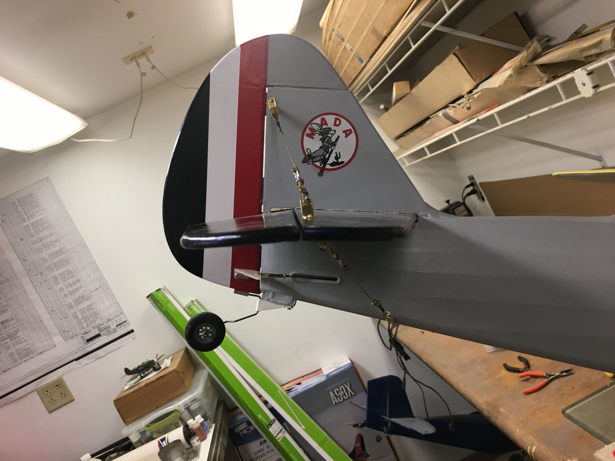

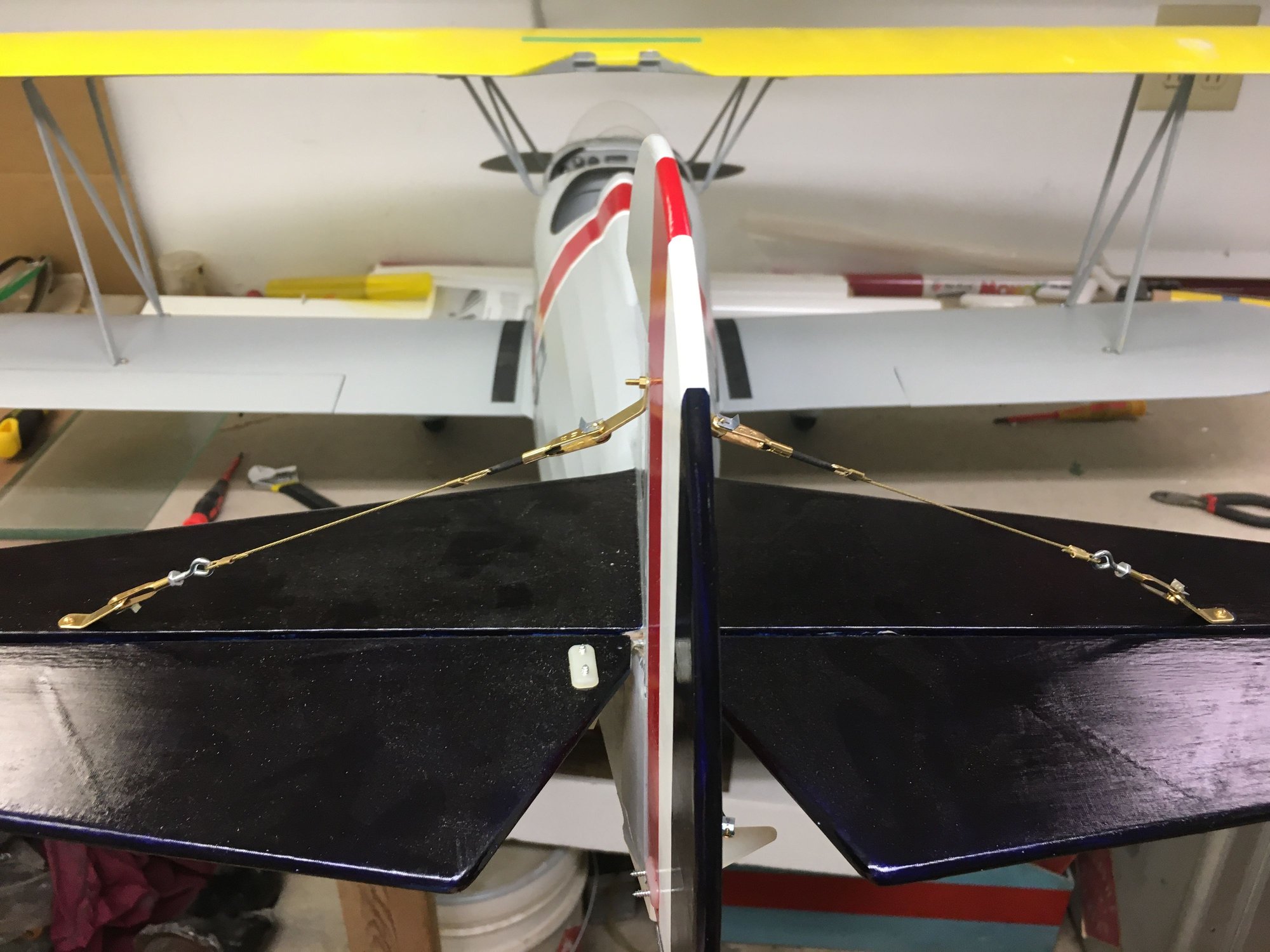

Nearing completion. Need another 4 oz of Lemon Yellow to finish the top wing, and silver brazing wire for the N struts, and the final thing then is the rigging, and it will be ready to fly. If you look, you can see that the cowl is very close to the actual one where I split it. I still have to add the baffles and the fuel dots to the cowl too.
Balanced perfectly
Balanced perfectly
