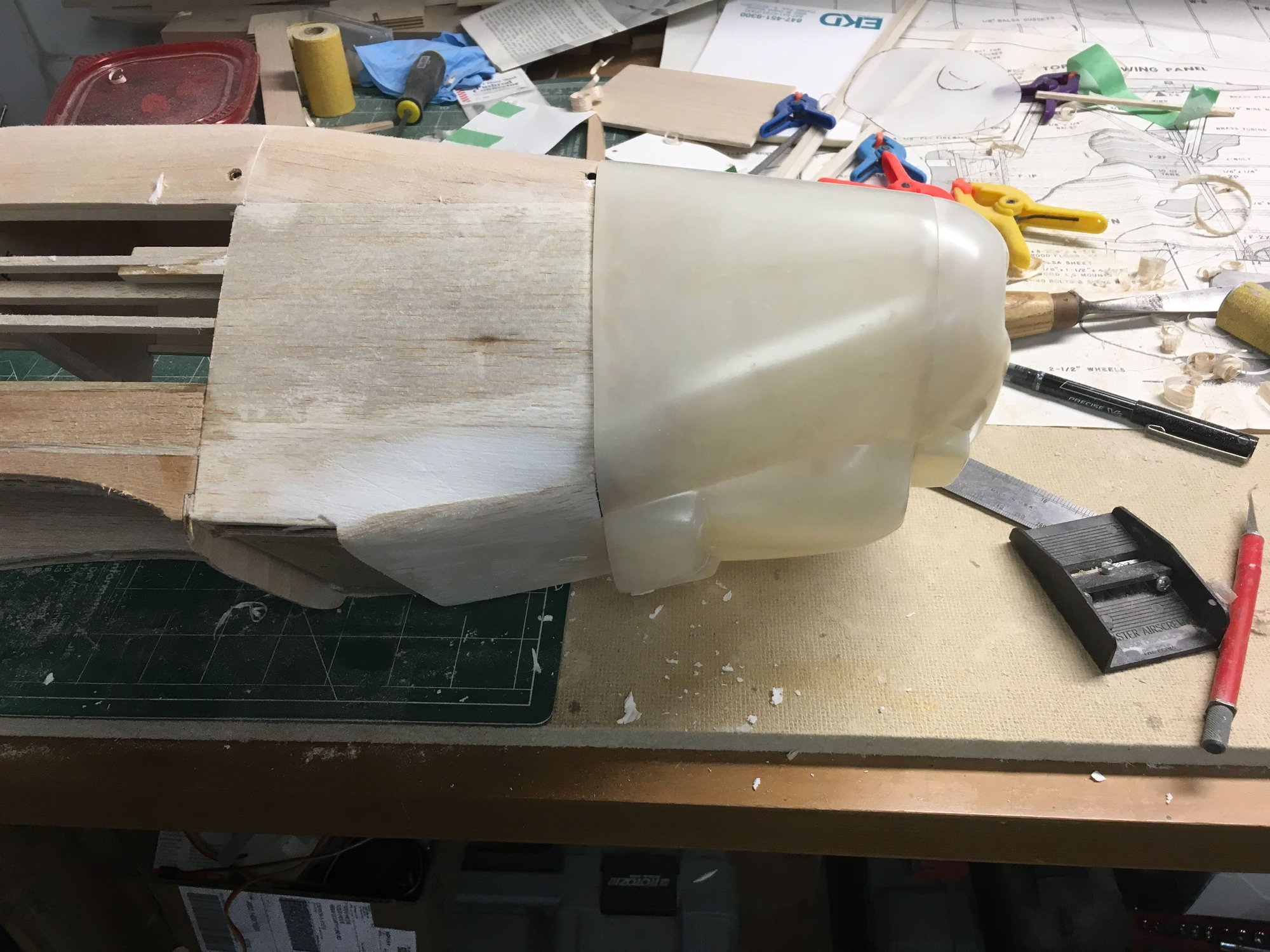

So far I have the fuse assembled, doing the sanding on it, and got the cowl assembled and glassed inside. I found that Polyester resin has a very short shelf life and will not cure unless a LOT of hardener is added, so had to strip out all I had applied and used epoxy resin instead. Only reason I went the poly route was it usually cures quickly, when it cures. I have some pics, but they keep coming up corrupted when I try to load them from FB, so have to find an alternate way to upload them without connecting the phone to the PC first.

I can't handle the fumes from the poly resins so all I use is epoxy. I have some PVA water based finishing resin from Deluxe but I haven't tried it yet.

Yeah, it does stink something awful, discovered my vent fan needs a cleaning, squealed and howled when I turned it on. I also have the Deluxe stuff and have used it. Works pretty good, but expensive. I use it to seal and apply the first layer of cloth, then switch to Minwax WB poly after that to fill the weave. The Sport will be fabric covered with Koverall and dope, old school style.

I did my Corsair with it, came out great. I painted it with latex paint and clear coated with automotive clear. Need to finish the wing, hell need to finish the whole plane, who am I kidding!

Small update, the fuse, and tail pieces are all assembled, but waiting on the lower wing before I can sand to shape and mount the tail. Need to align the stab to wing before I can put it all together to sand. I am cutting out new ribs using my laser, so it is taking time to draw out the parts on cimputer, cut out samples from heavy card stock to make proofs against the kit parts to make sure they are accurate, and then will build the wings. I will get some pics up in a few days.
The cowl came out OK after discovering the poly resin I had was bad. I recoated with Epoxy after wiping out the poly resin, and it is all done and solid. When I mount the engine I will halve the cowl to make an upper and lower section instead of trying to force the whole cowl over the engine.
