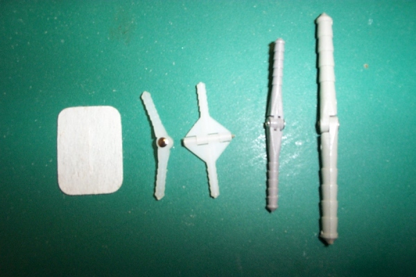

I am building the Goldberg Ultimate Bipe and I was going to use the "live" hinges that came with the kit. I have never used this type hinge in all my 30 years of building, I almost always use Klett of GP flat hinges but I was doing a pull test and to my surprise the hinge came out of the rudder trailing edge. I did clean the hinge with acetone to remove any mold release and scored the flats of the hinge with 60 grit sandpaper so the only thing I can think of is I did not get enough epoxy in the hinge slot. I have used the live paper/plastic hinges before but the range of movement was a lot less than I needed and the control surface was really hard to push on at it's max through. I have a bunch of Robart medium size pin type hinges but the hinge barbs sticks beyond the wood to a point where the barbs are no longer touching the wood.
I am open to any new or old ideas so let me know what type of hinging you have used in the past.

I always cover a plane then finish installing and glueing the hinges in so I am a bit confused as to the pinning of the hinges with tooth picks after it is covered, do you cover over the tooth picks with what ever color is to be used??
I did some experimenting with the live hinges that comes in the kit and on some pin/flat hinges I found in a junk box, I installed the hinges in some scrap balsa and used epoxy and both the small pin/flat and the Goldberg pin/live hinges stayed in the wood with me pulling as hard as I could.
The reason I am a bit concerned is the ones that pulled out on my W.M. Extra 1/4 sc.
I am going to be installing a Saito 180 iin the bipe(I know...major overkill) but my buddy had a Y.S 140 in his Goldberg bipe and it was a blast to fly so I says to myself...180 in CG bipe...why not.
Below is a pic of the hinges I have...I am starting to lean towards the medium Robarts. The one main reason I did not just go ahead and use the Robarts is I had already sheeted the hor. stab and vert. stab ...but a small amount of surgery on the under side of the horz. stab and vert stab is all thats needed so I can hen build up the stuff that is already sheeted.

I thought about is a lot and I have decided to do it like I think it Caffenman...which is sinking the hinge in the elevator leading edge and sanding the vert. stab trailing edge with some 60 grit wrapped around a 5/16 dowell rod. This is a more time cosuming task but the way the elevator works with the fulcrum recessed and a radius sanded on the elev. leading edge is like killing 2 birds with one stone. Doing it this way seals the gap because the leading edge of the elev. never comes out of the concave sanded in the horz. trailing edge.

Down in this part of the country those type hinges were called live hinges and I have used them on planes that did not need much surface throw. The nice thing about those type hinges is they want to go back to a flat shape which helps the servo but they also have just the opposite effect when the servo is asked to push or pull against the resistance of the live hinge.
I went ahead and did the hidden type hinge using the medium size Robart hinges and moved the fulcrum (pivot plane) 3/16" into the leading edge of the control surface. This meant that a concave was sanded into the trailing edge of the horizontal stab to accept the rounded leading edge of the elevator and now the elevator pivots inside of the concave portion of the horizontal stab which also seals the joint and no sealing of the joint is needed.
