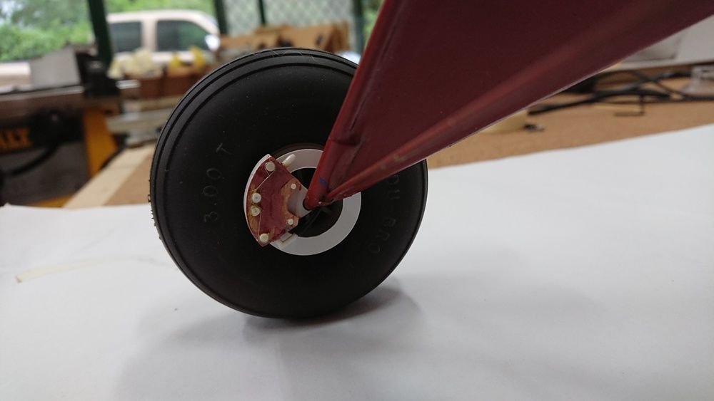

It appears that the brakes on the 1:1 are fairly prominent so work was started today on replicating those. I think I will add the caliper, disc and maybe a brake line. This may be the last detail that is added on this model.
The 1:1 attaches the disc to the wheel with a ring (of some sort). This is replicated with 1/32 balsa.
The disc was cut out of .010 styrene.
Middle part cut out and offered up to the wheel/axle. The disc will rotate with the wheel but don't think that will be a problem. Now to work on the caliper again.
tubig is offline

Did a little more work to the brakes. Caliper is just balsa glued to a styrene support that attaches to the axle. The styrene itself doesn't really provide enough attachment to the axle so a balsa or ply packing will be added behind the support which should be sufficiently hidden from view. After looking at the setup it appears that the rotor is a little to "wide" so the inner portion will be trimmed down a bit (if that makes sense).

The rotors were reduced in "thickness" and the calipers increased a bit to make a more balanced look. Also added caliper bolts from rod styrene. After gluing them onto the caliper, I tried to sand some facets around the edge to simulate a hex bolt. This was just eyeballed as it's really hard to see them at this scale and you can't even hardly see it in the photo.

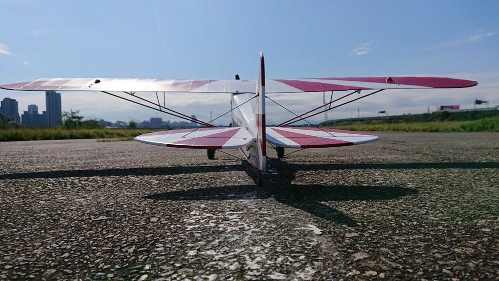

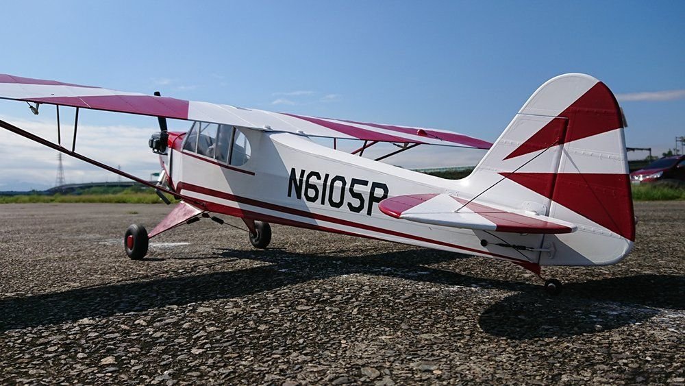

I don’t visit RCU much anymore so I have been remiss in posting updates to the Cub. Anyway, I wanted to post that the Cub was finished and has been maidened. I’m posting photos of the first trip to the field where she did not maiden due to engine problems. The video, however, is of the maiden.
[img]blob:http://www.rcuniverse.com/80dfa014-7...3-90c75b3c04e3
[img]blob:http://www.rcuniverse.com/154da490-5...f-e567172a9d01
[img]blob:http://www.rcuniverse.com/c341c70c-e...0-3ee4eb61dca0
[img]blob:http://www.rcuniverse.com/6e96f54e-f...4-44389d2d1eee
[img]blob:http://www.rcuniverse.com/782f0029-6...5-e38aefb17c41

I gave up trying to edit the last post to get the photos uploaded so I'll put them here.
