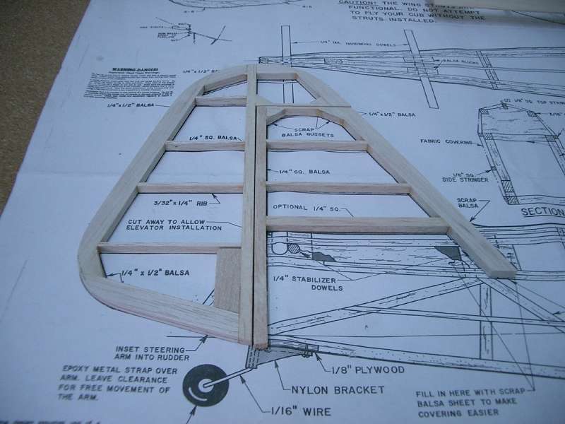

working on a 1/6th scale Sig Cub among other things. Sig calls this a "Craftsman kit" probably because it's about as close to scratchbuilding as you can get in kit form. very similar to the Marutaka kits in that you get a lot of sticks and sheets which you put together by trial and error fitting and shaping....which is fine with me. this kit takes a lot of time and patience and makes a good long winter build if you like that. to give you some idea how old this design is, the copyright date on the plans is 1975.
a pic of the fin and rudder. still needs shaping of leading and trailing edges and hinging.

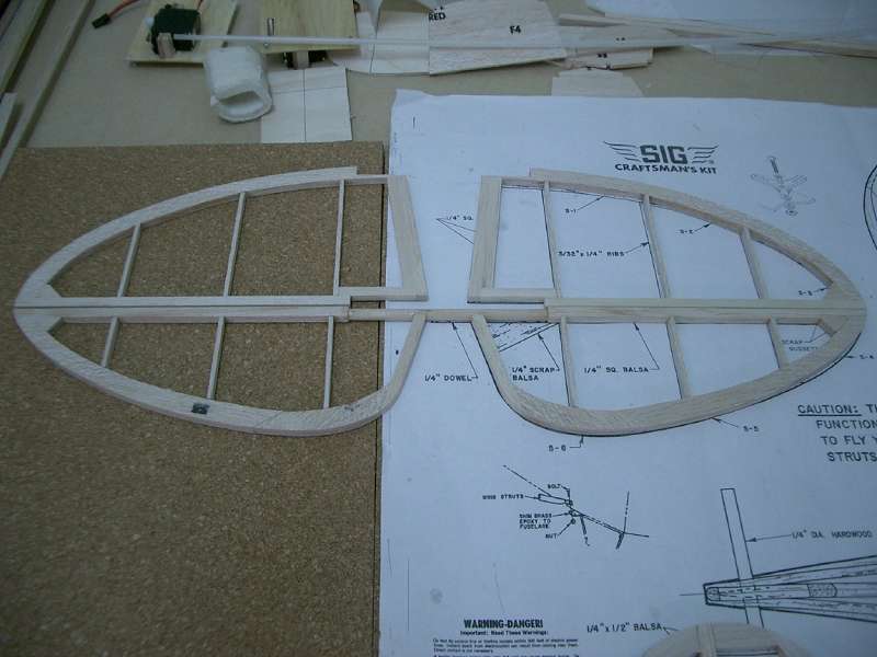

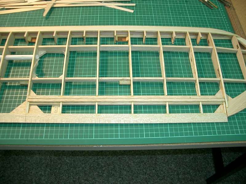

i've been able to work some on the wing. here is the right wing half. the kit called for a single servo with bellcranks to the ailerons. i chose to go with individual servos for each aileron. i've almost completed the compartment to hold the servo. you can see the triangular pieces i've used to hold the screws for the plywood servo cover. the piece of tape is just securing the string i'll use to run the servo leads to the center.

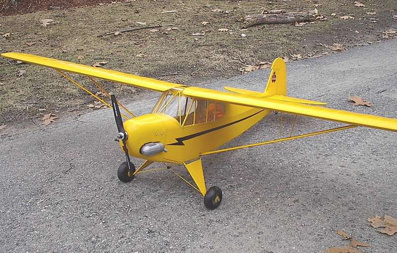

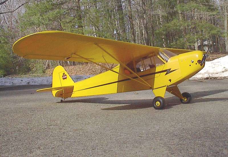

I finished building this kit, last Spring, for a friend in my club. He had started it circa 1980, and never had the motivation, skill or nerve to finish it. I got it with the wing framed up, and the fuselage just begun. It still took quite a while to finish up, but what a neat plane when it was done It's only been flown once during the Summer, and I wasn't even there
Do these pictures look familiar?

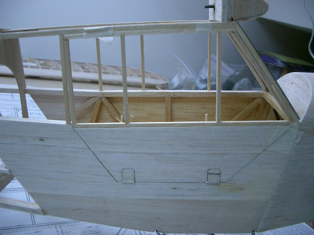

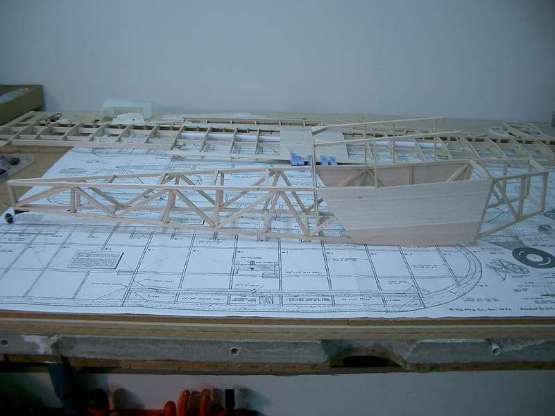

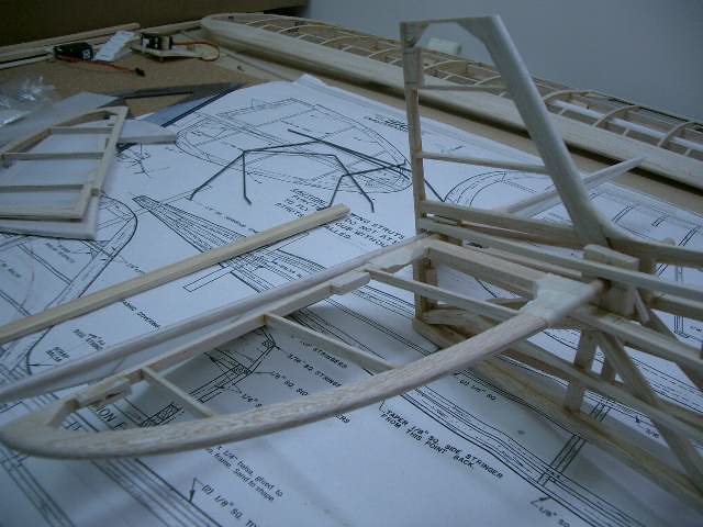

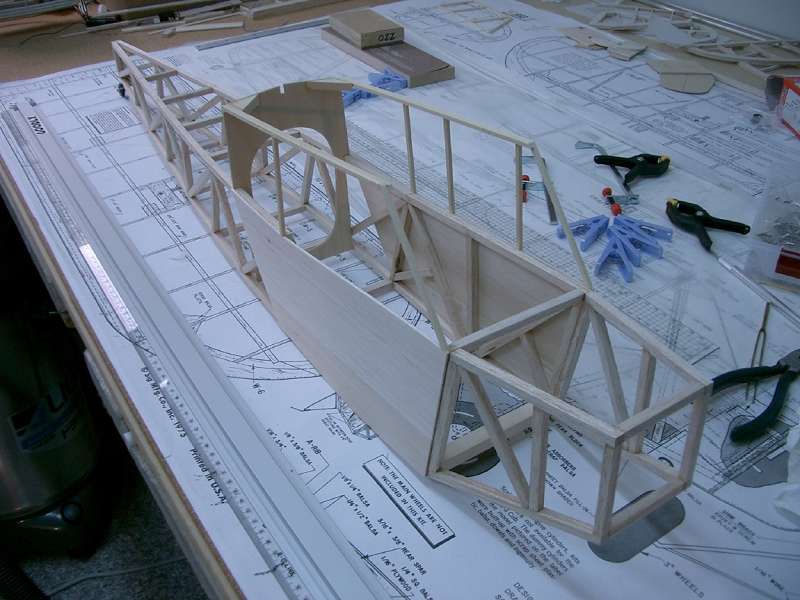

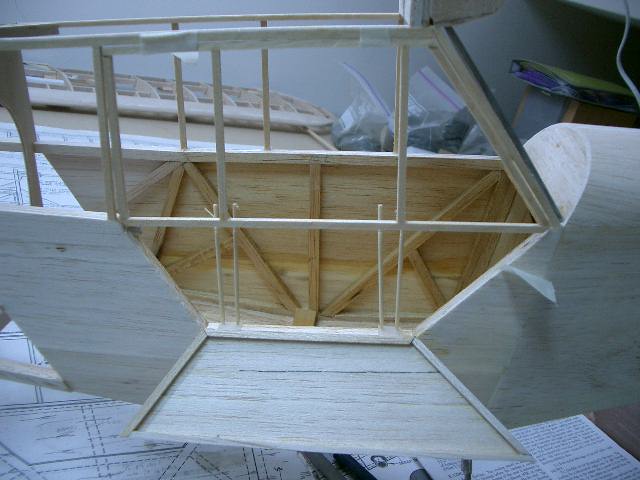

i've managed to work some on the fuse. it takes a while to build this as, you can see, it's stick built. the most frustrating part is keeping the spruce stringers that form the cabin outline from breaking off. they are just end joined to the balsa sides and that doesn't provide a good glue joint. still, it has been an enjoyable build so far.
Ah, yes I remember that frustration. It gets much sturdier when the plywood piece at the front top of the cabin is installed along with the music wire pieces. The music wire has to be wrapped and soldered, also. The landing gear is constructed the same way. That's a fun job. Hopefully, you've had some experience soldering.
Have you considered making the cabin door operable? It is a bit more work, but it adds even more scale-like realism.

phil, i think i have broken off each spruce stringer at least once now! the plywood piece and "rollcage" are next so hopefully that will help like you say. i have some limited experience at soldering and i have some friends who can help me if i goon that up.
as far as an operating door, i think i will give that a go. again, i don't think i'll be flying this one but an operating door will still look good.

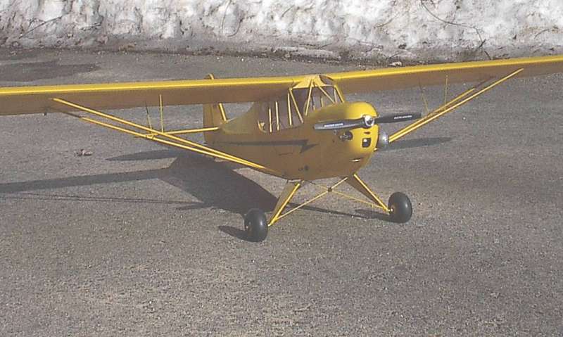

It's a shame not to fly this one! Mine is five years old now. Had a Fox 35 on it, but it was too loud. Has a Saito 30 now which is just right.
Covered in yellow Solartex. HS 81 micro servos all around with pull pull on rudder and elevator. Weighs a little over 4 pounds. Slow flybys and touch and goes are about as good as it gets. Doesn't like wind though.
I added 1/32" shear webs to the wing spars. The wing struts are functional and must be used for flight.
I think this plane won the 1959 Nationals in Scale. It's one of my favorite planes.

A yellow Cub would look great against that backround for sure. There is no sweeter looking Cub than this one.
Gotta make the boss happy though. Maybe if she changes the decor sometime you'll get to fly it. It does demand a calm day. No fun at all in the wind.
I fly mine sometimes at the local soccer field. With the Saito 30, it's quieter than a geared electric.

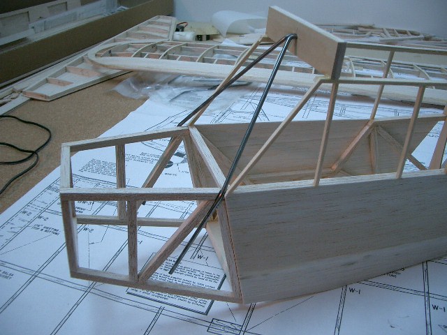

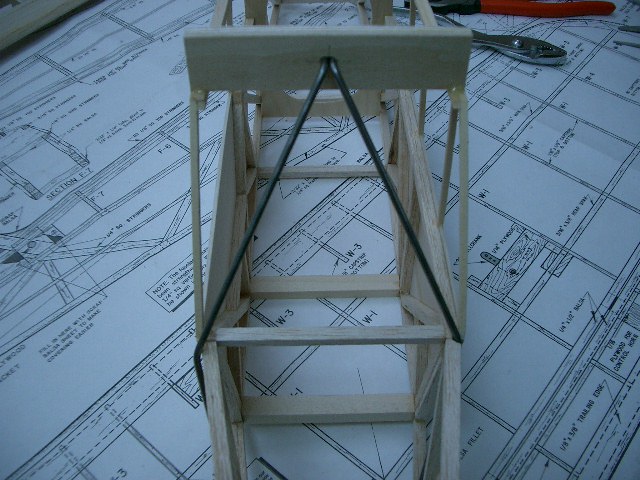

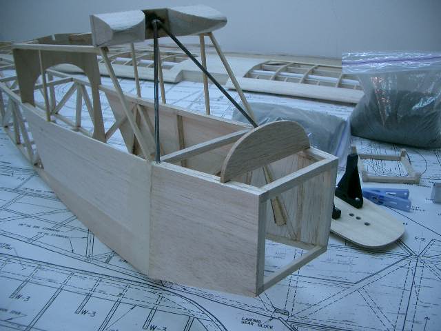

well, for anyone following this i'm sorry i haven't had much to post lately. i've been a little delayed by other things.
i'm up to adding the 1/8" music wire to the forward cabin area that supports the leading edge of the wing. this has caused more trouble for me than i expected. the wire is mostly prebent to fit; however, it still needs to be bent to follow the frame portion of the lower fuselage. it looks like i'm going to need some wire benders since i'm not having much luck with hammering it in a vise. i think you can see what i mean from the photos. you can also see how some of the fuselage frame is relieved to accept the wire. the wire on the right side of the photo is in place whereas the left side has yet to be done.

My instructions mention that the wires may need to be bent. My are not working either. You are on the right track, just bend them little by little until the wire mate properly with the structure.
ghenson is offline

after sitting back awhile i finally decided to just fill in the gap between the wire and fuse frame instead of trying to beat the wire into submission. it was much easier. here's what i have.

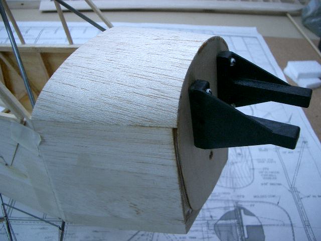

slowly back to work on the cubby after a long time off. i needed to shorten the nose by 5/8" to accomodate the OS30FS i plan on using. also, while i was at it, i incorporated the 3 degs. nose down thrust that is shown on the plans into the fuse structure vs. angling the engine bearer as the kit specifies. i also glued in the 1/4" balsa sheeting "fill" pieces into the nose. now time to apply the 3/32" skin to the forward fuse.

so i've added the sheeting to the forward fuse top and sides.
also, i've been working on the cockpit door. i cut the outline out of the sheeting and then reinforced around the edges with 1/8" hard balsa. i'm using regular pinned hinges for the door hinges. not too scale but it was what i had on hand. door top is just taped in position now.
ID:	135100   Click image for larger version
ID:	135101   Click image for larger version

i've added the fin and stab dowels. that was a real pain to get the dowels in place at the correct incidence and square to the fuse. the way this kit is set up, i'll have to cover the stab and fuse separately and then install the stab to the mounting dowels since there is a gap between the fuse and stab as per the full size. since the elevator is captured by the fin post i went ahead and covered it before putting it into position and then permanently installed the fin. the real potential problem here is getting the elevator hinges in neatly since the elevator is already in such close quarters with the stab. i've done a trial fitting of the hinges and it can be done even though it's not easy.
ID:	135109   Click image for larger version
