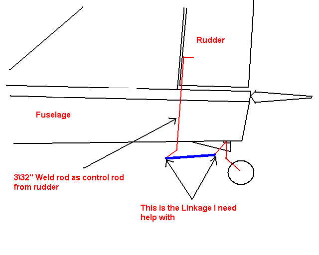

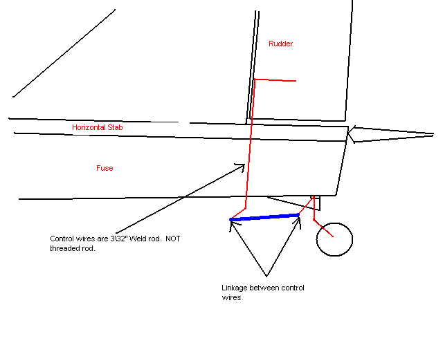

I am building a Kadet LT-40 and I am making it into a tail dragger. I wanted a linkage that went to the rudder to make it steerable but I didnt want it to be a solid shaft from the wheel to the rudder as I saw that as putting a lot of strain on the rudder. The picture shows what I am envisioning however I cannot think of how the linkage between the rudder control rod and the tail wheel arm should be. Is there an easier way to do this? Do I solder some kind of end to the rods to put a type of ball joint on? Any help is greatly appreciated!

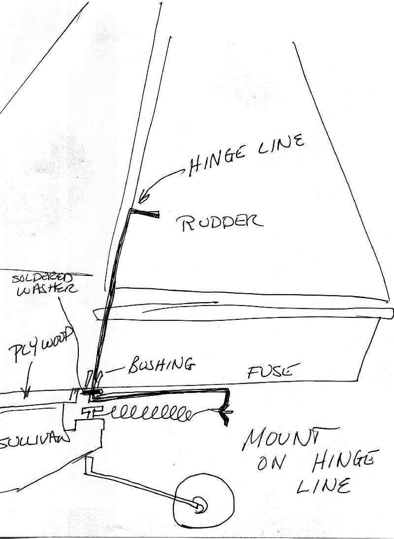

The tail wheel doesn't have to be at the edge of the fuse as you've shown it. Move the tail wheel until you are 1/2" ahead of the rudder pivot point. The red line in your drawing and connect it with fuel tubing to the tail wheel.
Hope this makes some kind of sense, I'm at work at lunch and do not have access to a scanner.
Edit -> Or use a spring for your connection as shown. Turn the base around!!

You just stated what I was thinking about all day after my initial post. I had new mains made up and they will be mounted at the leading edge of the wing. I will have a second control rod that comes off the rudder servo and it will exit the opposite side of the rudder and on the bottom. My tail wheel assembly uses a 3\32" rod that I can bend to a 90. Now how do I connect the tail wheel control rod to the 90 that I just bent in the tail wheel rod? Another idea i had was to not bend a 90 but put on a bell crank type of arm on the top of the tail wheel rod. Do they make something like that for 3\32 inch rod? Something like a wheel collar but with a plastic arm that has holes in it like a servo arm. This is my last hurdle... to find out how to connect the control rod from the servo to the 3\32 rod of the tail wheel. Thanks all

If you wanted to use your original idea of a torsion rod, you can do it as long as you use a bushing (brass eyelet or tubing) and a soldered washer for a positive stop. The key is to have the pivot point of the tail wheel match the pivot point of the torsion bar as shown. Using a Sullivan tail wheel is the easiest because it comes with the spring.

"My tail wheel assembly uses a 3\32" rod that I can bend to a 90. Now how do I connect the tail wheel control rod to the 90 that I just bent in the tail wheel rod? "
To connect a wire to a wire. http://www2.towerhobbies.com/cgi-bin...?&I=LXD919&P=0 Use a strip aileron horn on the 90 degree arm that was bent at the tail wheel. Then use a solder on clevis on the pushrod wire from the servo to connect the two.
