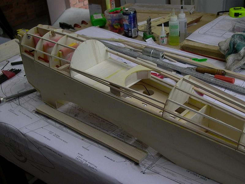

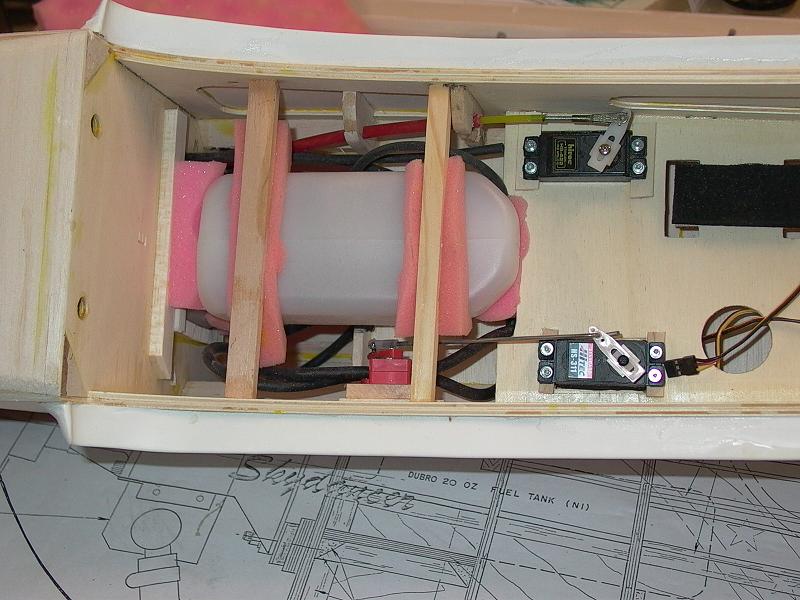

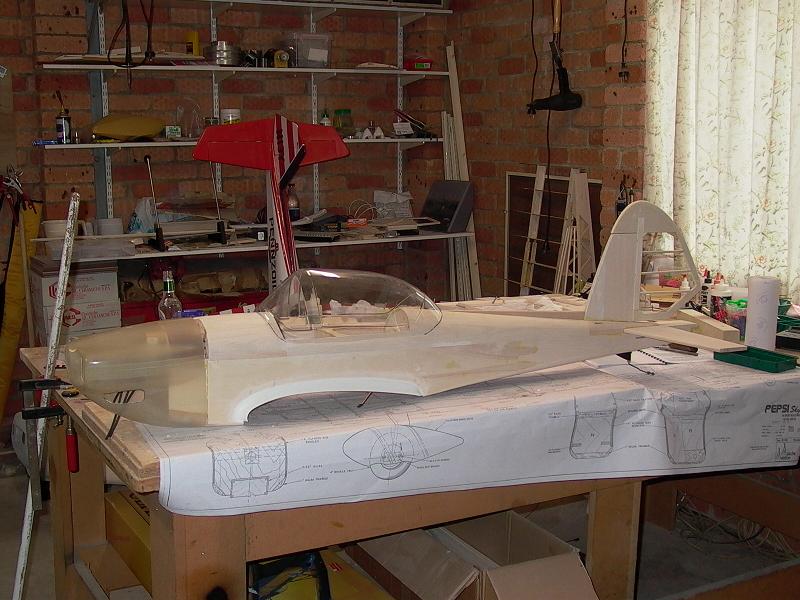

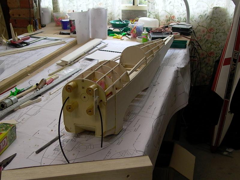

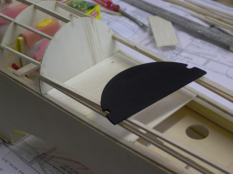

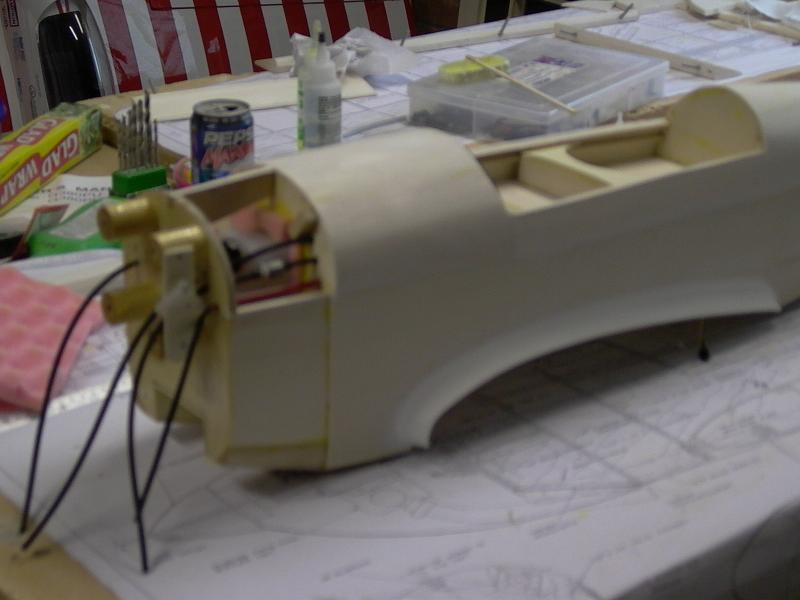

This weekend, I figured it wasn't flying weather, so I spent it building the Pepsi Chipmunk.
Since the last posting, a lot has been done and she is now starting to look like a plane. (well, remotely, at least)
Top of the fuse has been sheeted and the fuel tank is fitted. Since I'm using a gas engine, a 16oz tank should suffice.
I also fitted a second 16oz tank for smoke fuel and ran the plumbing out through the firewall. There is a one-way valve in the pressure line to prevent back pressure from the muffler driving the smoke fuel back into the tank.

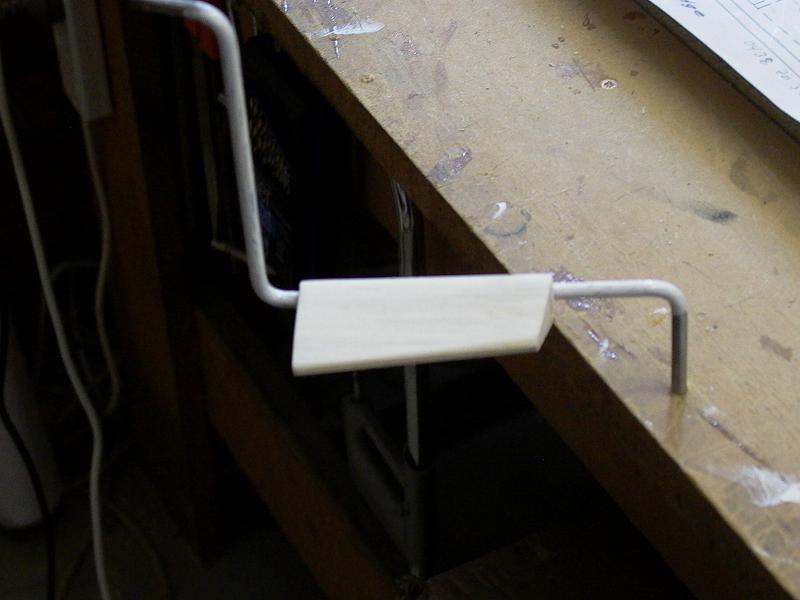

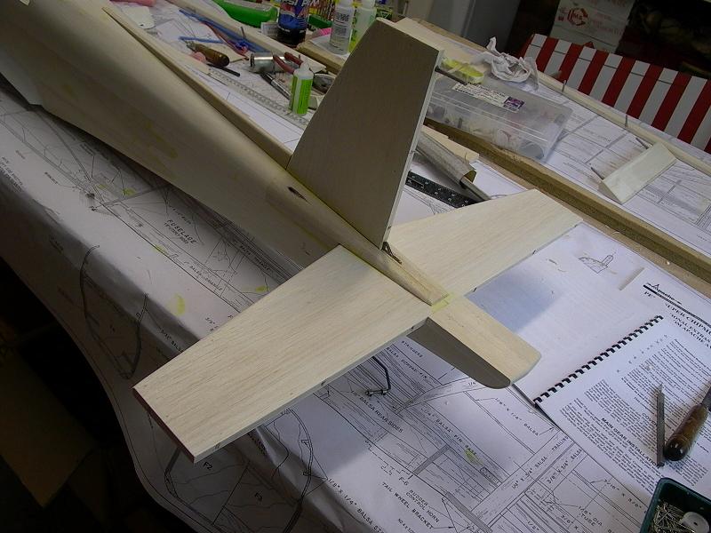

Early on in the piece, I decided not to fit the elevator and rudder servos exposed in the tail but inside the fuselage. The servo tray has a couple of cutouts which I decided to use. Therefore, I glued on the horizontal stabiliser, the elevator spanning platform and the vertical stab.
I then shaped and glued in the filler pieces that continue the turtle deck past the rudder and drilled holes for rudder pull-pull cables.
Because the rudder is fully above the horizontal stab, these cables will have to be visible above the stab. This should not look too bad though if I use thin kevlar cables or one of the Dubro pull-pull kits. I ran some ny-rod outer tube as guides for the pull-pull cables into the servo compartment. I don't like having the cables un-guides, as it's not a straight run.
I then cut slots for elevator pushrods and made up the pushrod. I made it from a hardwood dowel with 4-40 wires in a fork configuration for the elevators and a single rod for the servo.
I rough shaped the lower corner of the aft fuselage. This will need further sanding.
Initially, I had been planning to make up my own wing fairings from 1/32 ply and some balsa scrap but when I had played with the ABS fairings a bit, I decided to fit them now. Once they were glued on, I used some light filler and filled in along them to blend them into the fuselage sides. It will be hard to cover the fairings, due to the curve but we will cross that bridge when we come to it.
I also rough cut the cowl for the G38 and was pleasantly surprised with how little will protrude. The G38 looks like an excellent choice for this plane.
I have not weighed the plane with the engine but I suspect it will come close to 13 or 14 pounds.
I am posting a few photos of the progress so far.

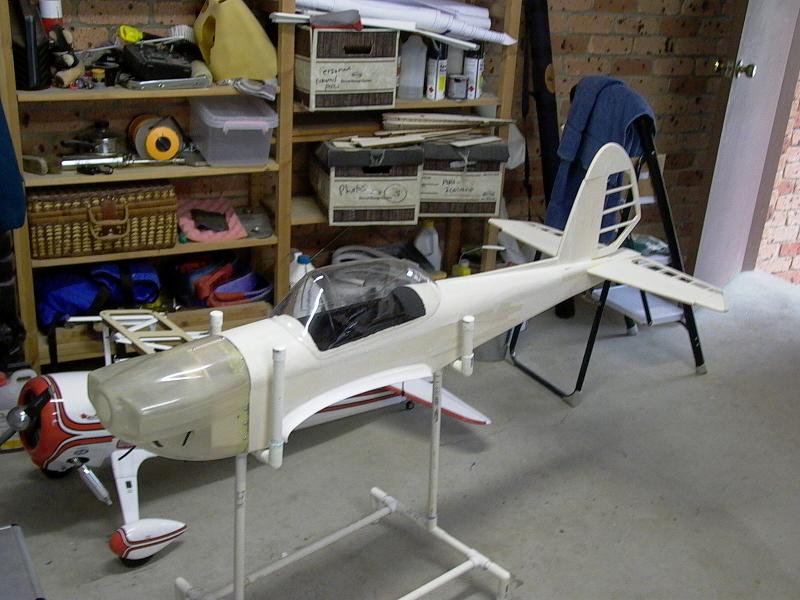

I haven't done much on my Pepsi Chipmunk for a while, work has been getting in the way of my building.
I have the fuse fully framed up now and have painted the cockpit interior. I am working on an instrument panel made from a JTEC 1/5 kit and hope to have that done by next week or so.
The wing is more or less ready. I still need to glue in the reinforcement plates for the aileron control horns and will probably modify that somewhat.
Apart from that, some final sanding and I will start thinking about covering.
I will be changing the landing gear fairings. I didn't like the way Mike designed them from 1/16" balsa sheets wrapped around a 1/2" dowel, so I will be shaping them out of some pre-cut aileron stock.
Will post a few more photos when I get a chance.

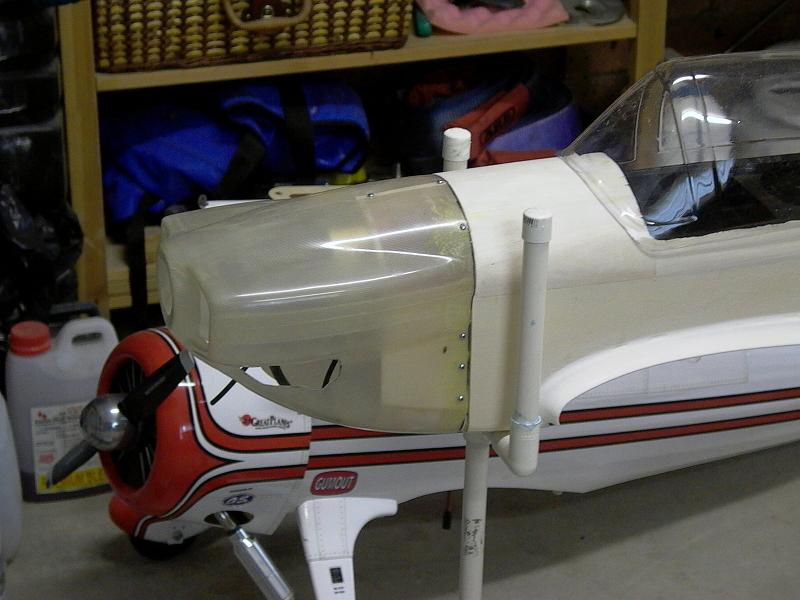

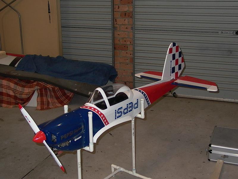

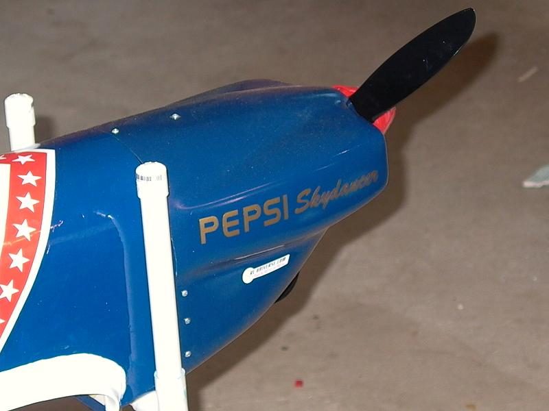

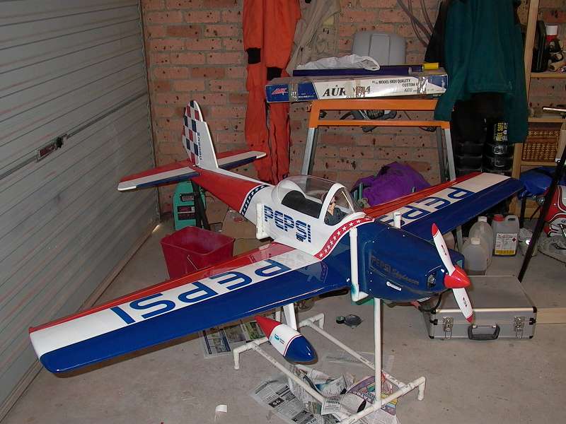

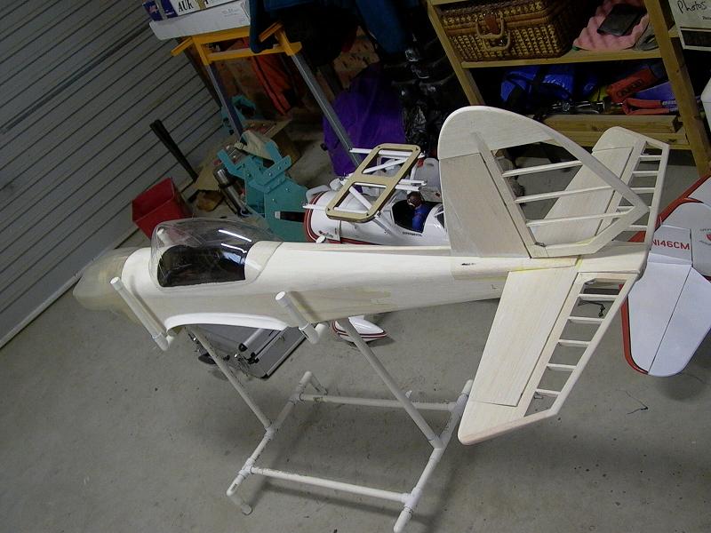

I haven't had much time to spend on the Chipmunk but been doing bits and pieces, a few minutes at a time. I guess it all adds up, as everything is not fully framed up and some final sanding to be done.

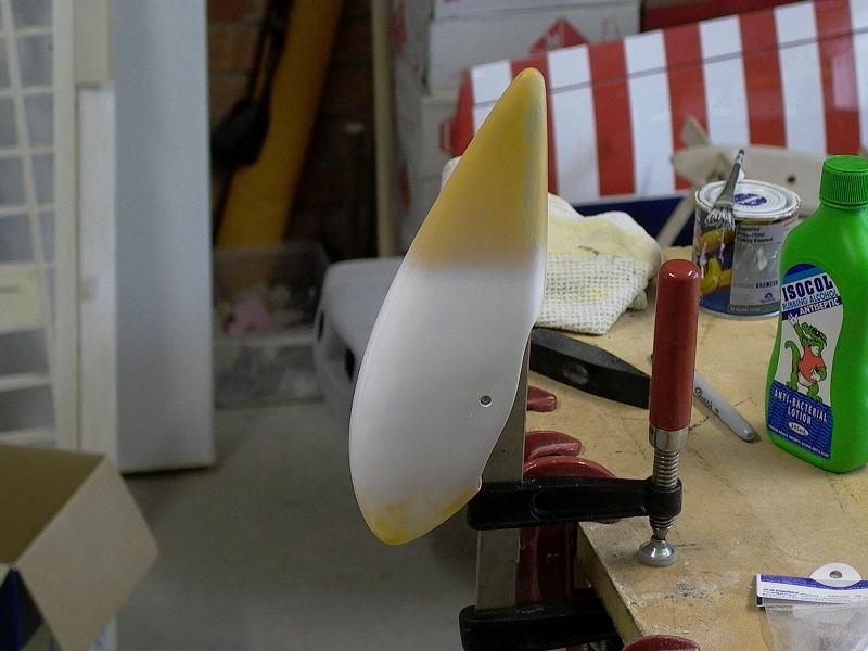

I have also been working on the spats and the strut covers. I decided to discard the materials that came with the kit for the strut covers but make my own out of something a bit more solid.
The other deviation from the instructions is that all the servos are now inside the plane and pull-pull cables to link up the rudder.

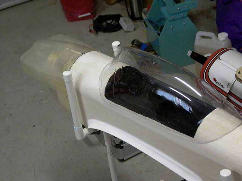

I have temporarily fitted the cowl, the canopy is roughly cut aned I have painted the cockpit flat back.

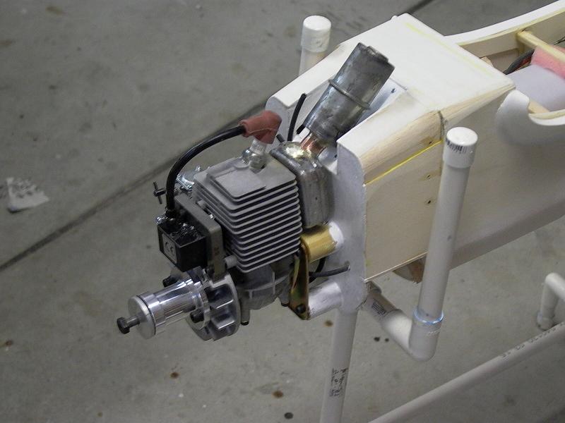

I tried to modify the stock muffler that came with the G38 but didn't have much luck. I admit that I'm not much good with metal work but I have made a deal with a friend to braze a piece of a 5/8 pipe to the lower end of the muffler and a small Brigg and Stratton lawn mower muffler on the end to form a secondary muffler. The B&S is fairly open and I am convinced that I am providing a better exhaust path through this than the small louvres on the stock muffler did. Therefore, there should be little or no power loss but a quieter and better sounding engine.
Not far off covering now!
As a summary:
The only areas where I have devoiated from the design is the strut covers, the servo placement and some minor changes around the fuel tank floor. I also reinforced somewhat the wing trailing edges where the Robart hinge points are mounted. This was more of a peace of mind thing than out of necessity because I think with everything assembled, it would have been plenty strong.
The build has been relatively easy. The kit is exceptionally well thought out and so far, I haven't had to replace a single wood item that was included. The only thing I replaced (strut covers) was out of preference. All have been of top quality.
Ari

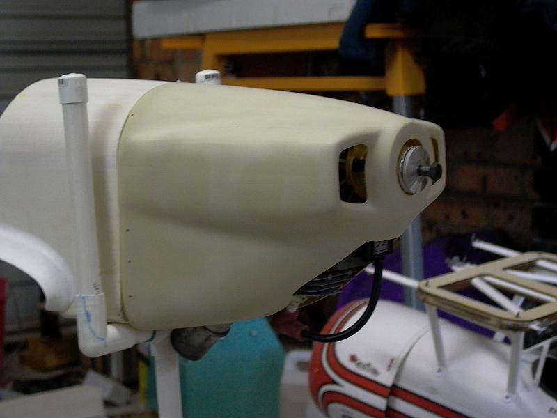

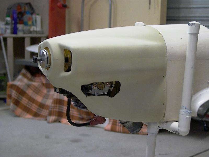

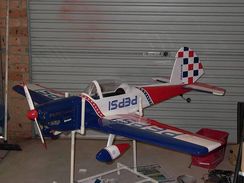

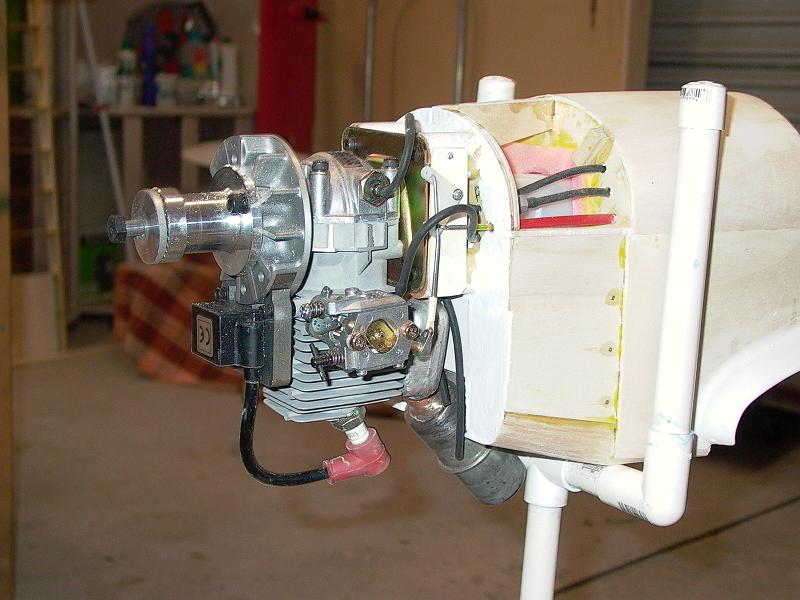

I have been working on mountng the motor and doing other pre-covering work.
A friend at work modified the muffler for me by brazing a 5/8" brass pipe to it and then adding a secondary cannister muffler to the end. The secondary is a Briggs and Stratton lawn mower muffler which I hope won't restrict the engine much and give that nice "deep throaty" sound I'm after.
The cowl is cut and primed. The engine fits nicely with limited cutting or extruding parts visible except from below.
I had to deepen the cooling duct underneath the fuse to make room for the muffler. Apart from that, it all went in rather easy.

How did you finish the canopy on your Pennzoil chipmunk? Paint or film from the inside or outside?
Experimenting with profilm at low temperature I find that you can iron on the film to simulate the panel frames on the canopy material (lexan?). It bonds into the canopy material and is permanent. I haven't tried it on the original yet though.

I painted the canopy frames (outside) with Lustrekote. I have never used film to do it and painting seemed easier. It came out quite well.

As of late, I have been slack posting on building progress.
I have now completed most of the tail and fuselage. The rudder and elevator servos are Hitec 645MG and other servos are standard HD servos. Still haven't decided on aileron or flaps servos.
The elevator is driven by a fork-type pushrod made out of a hardwood dowel (3/8"??) and 4-40 threaded rods.
Rudder is a pull-pull arrangement because I didn't like the setup in the Pennzoil which was a control arm on the tail wheel bracket grabbing a wire that joined into the rudder, tightened with a grub screw.
I still haven't completed the fairings. They are primed white but I need to get some matching missile red and insignia blue paint to extend the stripes all the way down.

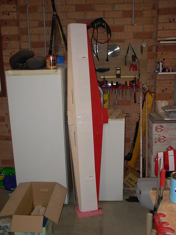

The underside of the wing is covered except the blue front because I need to align that with the blue front of the fuselage. The underside white will be covered with the same type of checkerboard as the rudder.
That's actually quite easy with the Windex method.
I sent a template of the instrument panel and a few photos of the full sized one to Joe from Diamond Panels to make me a panel for the plane. I have bought panels from him before and the workmanship has been nothing short of excellent.
I will be fitting a 1/5 pilot figure as well. May go for a toy though as I often find the pilot figures unrealistic.
Ari

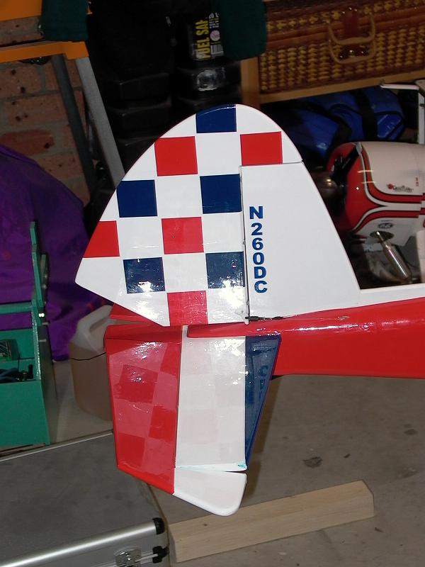

We are close now.
The Pepsi is fully covered and painting is done.
All that's left to do now is to fit some servos and engine kill switch and adjust throws.
Balance is correct, but I had to hide quite a bit of lead in the tail to offset the heavier engine and the servos I moved up front.
Look forward to flying the plane. Maybe another 2 - 3 weeks now
