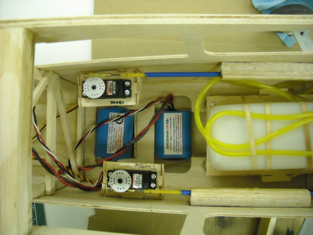

RE: Building a Dynaflite Super Decathlon

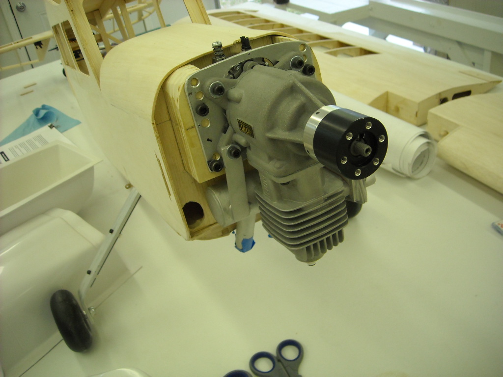

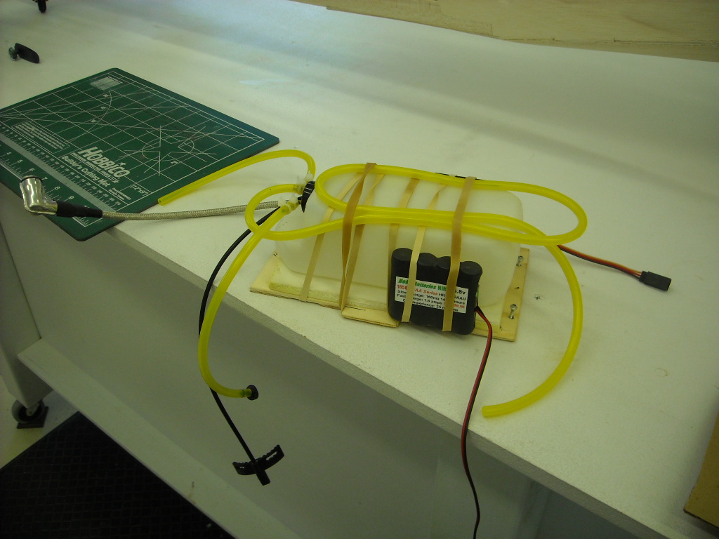

Have a few pics of the combo fuel/ignition module/ig-bat set up. that I installed yesterday eve. The fuse is currently nose heavy but I have not installed the rx or the rx batteries yet The rx batteries will be resonably close to the CG so I'm not sure how they are going to effect it. the rx will be in the rear close to the tail servos, actually about 4 or five inches to the front of them so I don't think this will change the CG much either. I have not installed the control rods to the tail yet other than to do some size checking so this may help.

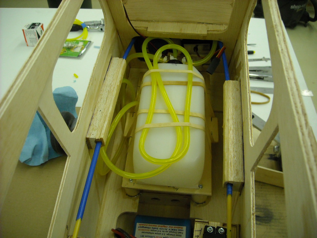

i know you are pressed for space, but i probably would not put the ignition box right next to gas tank like that.
i am not trying to be negative or anything like that, however, if, for whatever reason your plane did have a nose dive, and tank cracked open and next to spark or whatever, heaven knows what, then it might look like turbine plane crashed IYKWIM.
Orthobird,
Great point! I'll revisit that but, I may be limited as the ignition system had a spark plug wire and a sensor wire both about three inches shorter than I would have liked to use in my original planed location in the cockpit area. I'll put some more thought in it though as I should. On another topic, I do keep a fully charged ABC fire extinguisher in my trailer at the back door entrance, mounted on the wall for just such emergencies. That being said, I hope I never need it.[&:]
darrolair,
Very good idea. That may be what I do since I don't plan to scale the interior anyway. I had thought about mounting a tray and a Go Pro at the CG however, the fuse is so large I can still mount the tank on the CG and the Go Pro tray and servo above it should I decide on the camera.

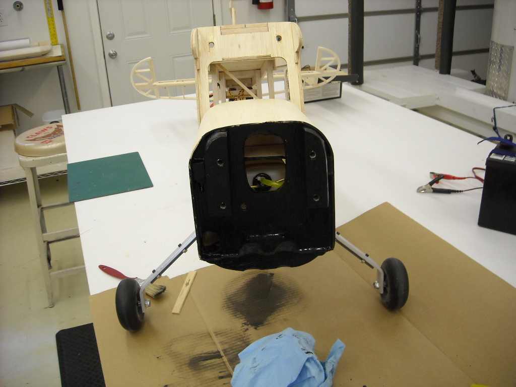

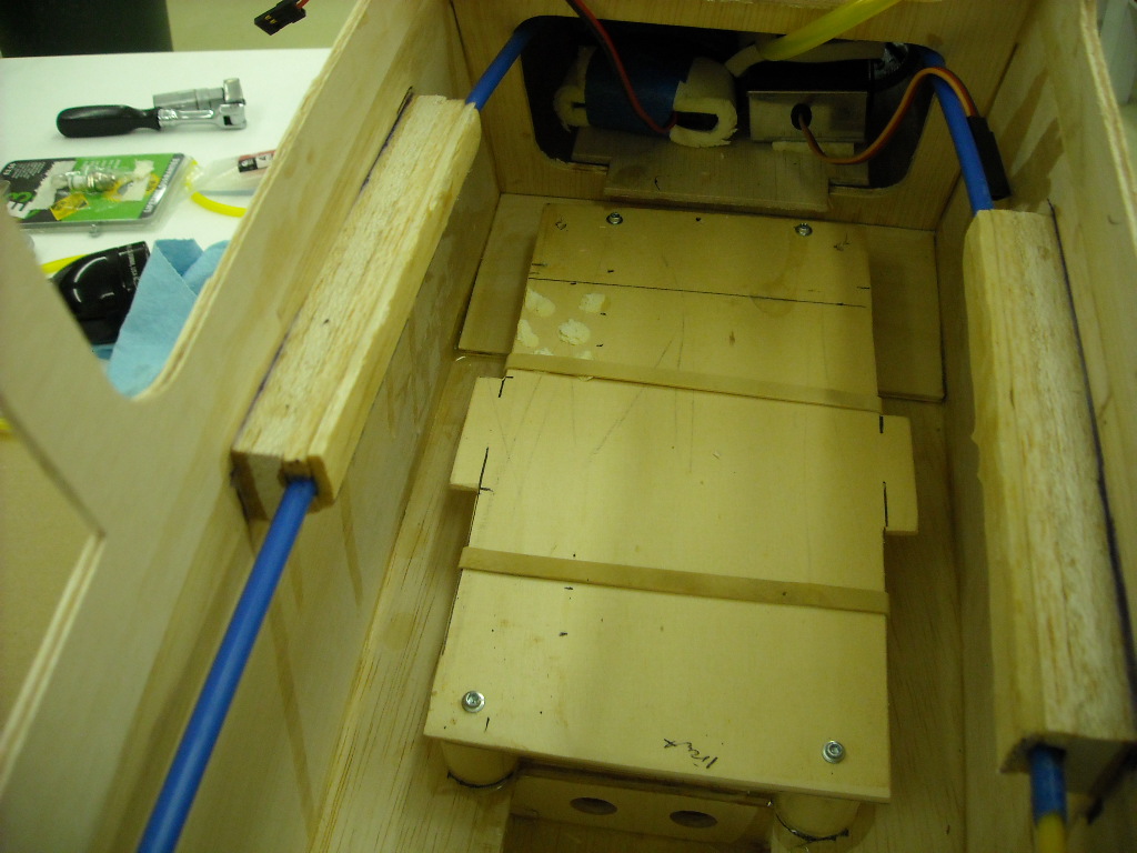

Moved the tank to the CG and things are much better. Also the fuse seems to be balanced better at this point. The last pic is where I plan to mount the rx. I epoxied a tray in there which is currently weighted with a piece of steel until the epoxy cures.
Thanks Guys for pointing that out to me and thanks to you darrolair for the tank move suggestion. I like this much better than what I had.

#1598

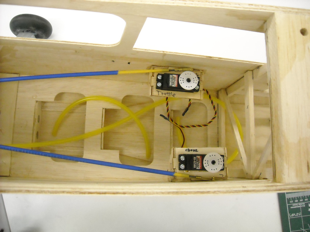

Forgot one of the pics prior to installing the fuel tank this time.
Don't know why I initially put the tank up front as I didn't plan to detail the interior. This is going to be something to knock around with. I guess I was in the glow fuel mindset where tank placement is more of an issue. The gas is more forgiving in that department.
orthobird,
I'm a little concerned about what the overall weight will be with the ZDZ40. I made some marks on the fuse where the balance point would be when the plane is complete. After adding the additional trays, the fuse balanced with the ZDZ and servos mounted. When I finish the cowl and install the spinner, propeller along with the control rods and wires from the servos to the elevator and rudder I may not be so lucky. I initially weighed the engine but, that was back in the fall and I forgot what it weighed. I knew I should have written that down[]. I'm guessing the plane will come in at 20 lbs dry but time will tell. I'm running dual A123 2300 mah batteries on the rx but, the extra bat and switch is only 6.6 oz. If it's too bad, I can drop one of the bats but , I like the redundancy of secondary switch and wiring/connectors. Not to mention having 4600 mah avail for long flight times and numerous flights between charges is a nice +.
