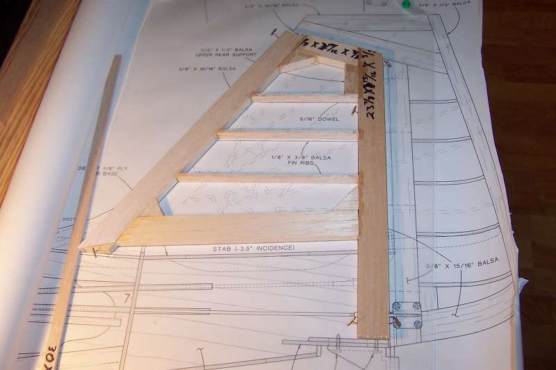

I did some work last night and I completed the entire horizontal stabilizer. Getting the T-pins in the exact place to create the laminated 1/16 X 3/8 strips was not too bad. did however have my fingers glued to it several times while I was holding it down. The construction of the Horizontal stabilizer is straight forward and pretty easy. Before I glued the trailing edge of the stabilizer and the leading edge of the elevator, I pre cut slots for the dubro hinges I'm using. It's easier to work with than handling the whole stabilizer itself.

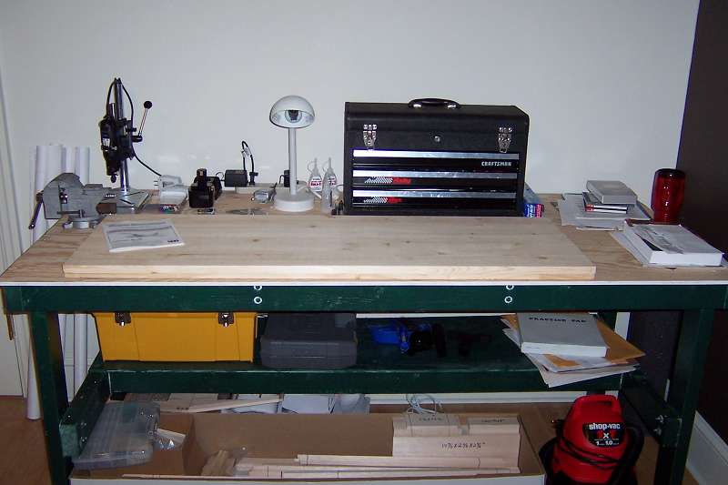

Here's the photo of my work area that I have set up in a corner in my apartment. The dimensions are 70in. long, 30in wide, 30in high. I built it with the help of my dad back in October.

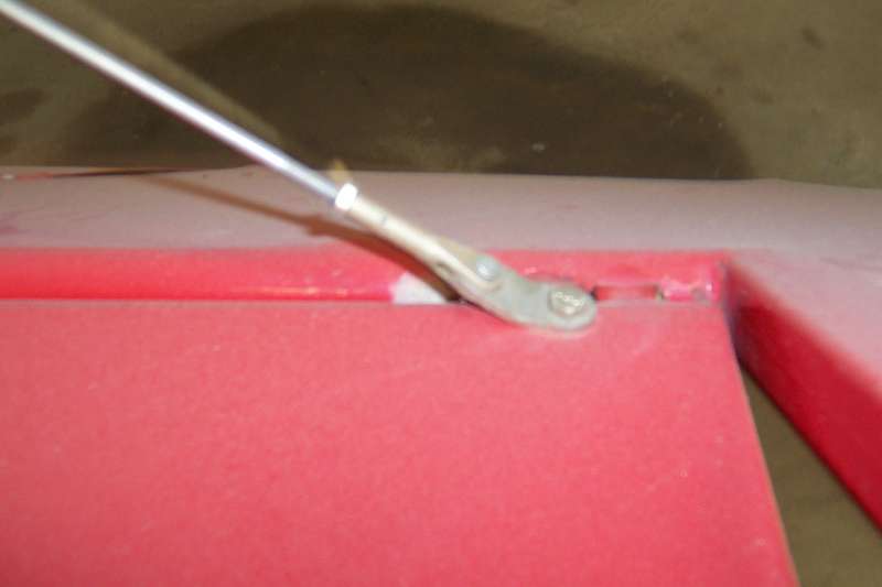

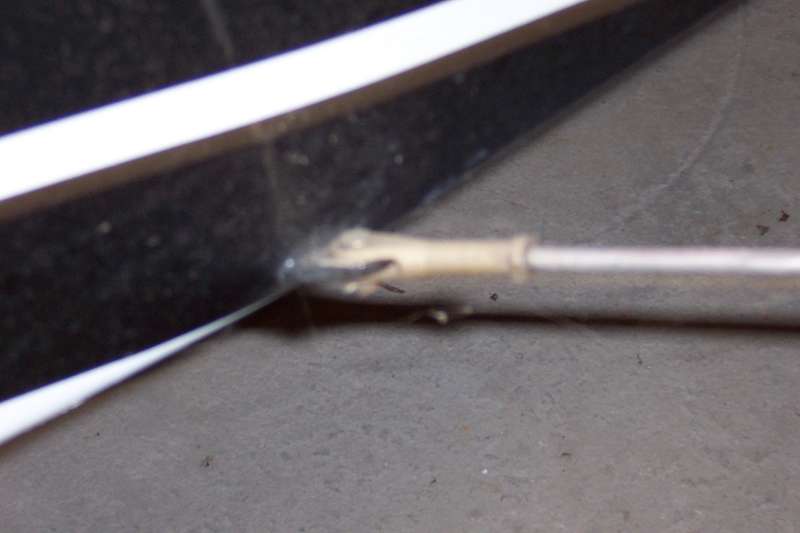

To respond to my own question about the fyling wire braces and such, I took some photos of original hardware from one of the decats that was in the hanger at my dad's work. It's really quiet simple how it's constructed and some of the pieces of excess hardware I have will be used to construct them. Here's some photos. Sorry the photos are kind of fuzzy, It was somewhat dark in the hanger and the focus wasn't able to function as well.

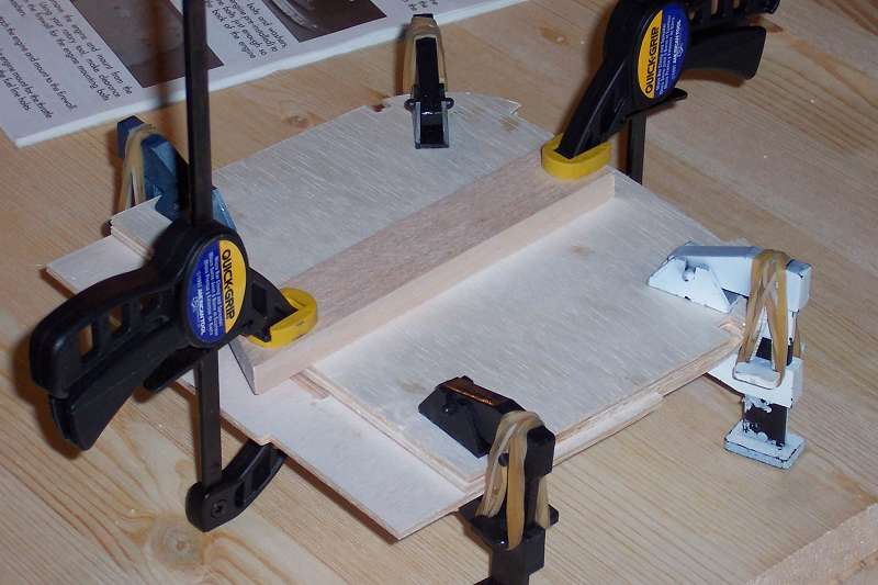

did some more work today on the rudder and I've got the firewall clamped and glued with 30min epoxy. Here are some of the photos.
Since the wing is going to be constructed a little different to allow for a sky light, i'm going to construct the wing last. The next thing I'm going to do is build the fuselage. I also might do some sanding to the empianage later.
