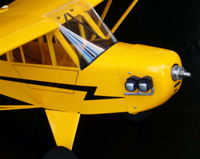

I just completed this model the day before yesterday. This is a really fun kit to build. I recommend it for first time builders, but not for first time pilots. It's not exactly a trainer, but it is easy to build.
The only problem was defective fuselage sides. Sig replaced them but the new sides had the same problem. I managed to work around it, but they never called me back and I doubt they've corrected it. If you buy the kit and have the same problem, please contact them so maybe they will get the message.
Other than that, the kit went together quickly and I really enjoyed the project. It was a nice break from some of my more complicated stuff.
It's designed for a throttled 1/2A engine such as the Norvel, but the person I built it for wanted it to be electric and supplied a way over-kill PJS 1000 out-runner motor. It's too much motor and he'll break the wings if he's not careful.

It was a strange problem. The way the top keys to the bottom there is no way I was doing something wrong. In fact, I had somebody else come over and look at it and he had the same problem. I asked Sig if it's possible for a sheet to slip as it goes through the laser, and they said no.
More detail: If any of the notches were matched up, then the notches in front of the matching notch were off in one direction and the notches behind were off in the other. Don't know if that makes sense or not.
Said another way. Let's say I matched a notch at mid-length. The notches in front of that notch were behind the matching notches and the notches behind the notch that matched were ahead of their matches.
Another guy in our club has built the Cub too and with the Norvel it flew way too fast. That's why I knew the power I was provided for this model was too much. I replaced an OS .15 CV-A with the same electric motor and the electric is MORE powerful than the CV-A.
So in essence he's put the power of a racing .15 on this airplane. The wings won't be able to handle it if he pulls back the stick too abruptly. But it's his plane and I did want he wants. All I can say is I've warned him and it's his responsibility. As long as he flies the plane as intended it will be fine. Use the power to go straight up and then pull back to no more than 1/3 throttle for level flight.

I built two of these. The first basically to plan and the second with a 36" no dihedral wing with spruce spars and ailerons. The three channel flew on an .049 big mig but was switched to a .061. It sits in the hangar most of the time now but has over 15 air hours on her. The four channel is a blast to fly. With a .061 it knife edges across the field performs indefinite inverted flight and outside loops easily.
I've built Herr's Starcruiser (2) Cubs (2) Pitts and P51. My son built their AT6 when he was 14. We have had zero problems with their kits. Are you sure that you got the right front and right rear fuse side together and the left front and rear fuse side together?

Did you install the wing struts and if so, did you fly with them? I'm most concerned that if the wing flexes, it will rip the sockets off the fuselage or wing. The struts are non-functional so the plane can be flown without them, but it will look so much better if they're on (and stay on) in the air.

The standard wing mounting has withstood vertical dives to sharp pullouts and full throw loops from a steep dive. As long as you don't get crazy with the power and controls at the same time you won't have to worry. My high speed model had to have a different mount because of the ailerons. I lowered the threaded plate into the fuse and used longer mount bolts. No I don't use the struts on mine. I don't like nonfunctional struts and reinforced the wing slightly to make it unnessary. The struts being balsa were going to take some time to airfoil and would not be very durable.
