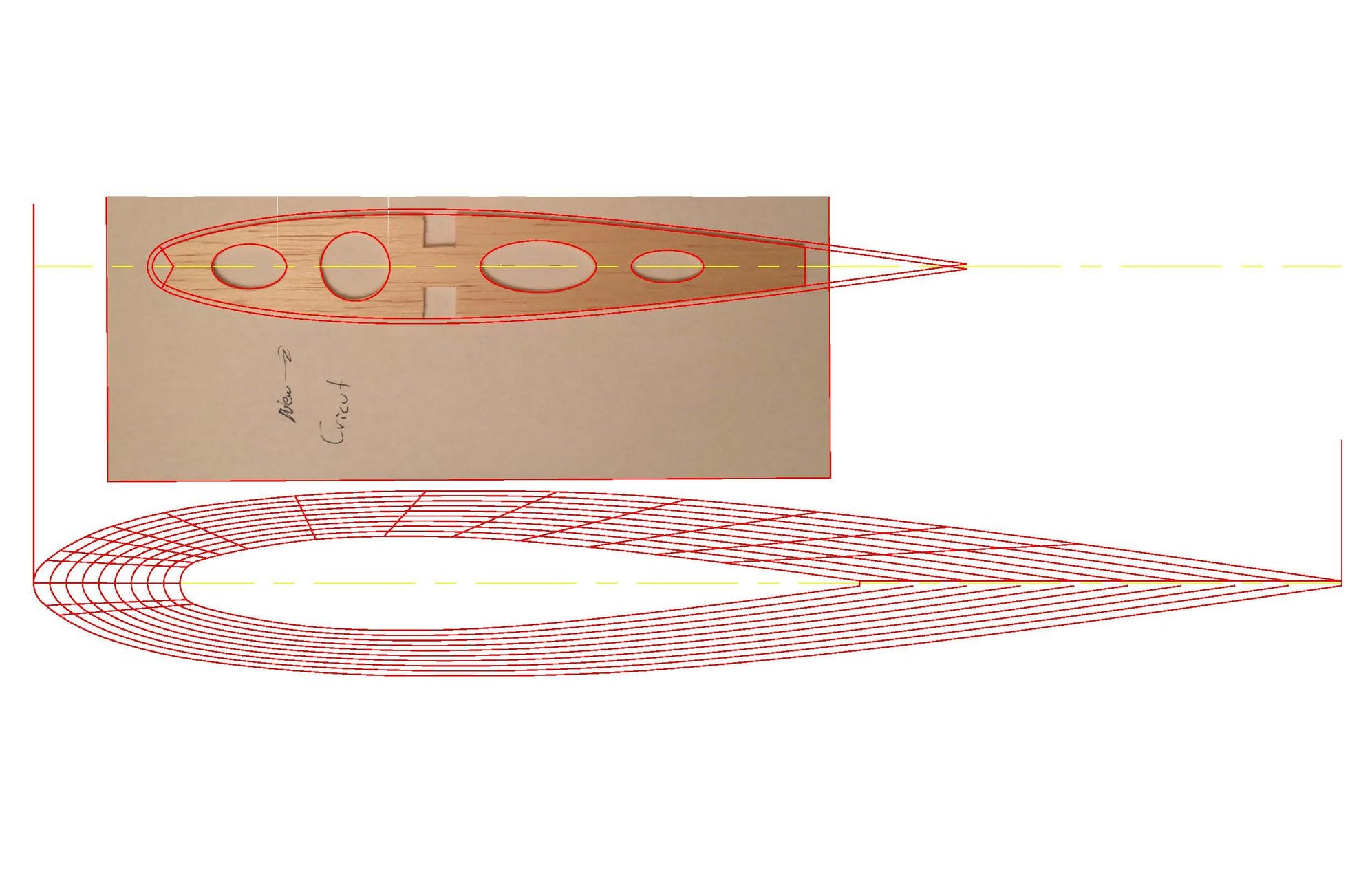

Inspired by Wizard..... (and the others whom recommended that we need templates, etc for this particular bird),
I decided to scan rib #8, and traced that scan in PowerPoint. I then imported that image into the software that comes with our Cricut Maker. Threw in the knife blade (for balsa). I popped out a perfect copy of rib #8 in about 3 minutes! Came out nearly perfect (and better than the original die-cut version. Next step - digitizing the rest of the ribs!

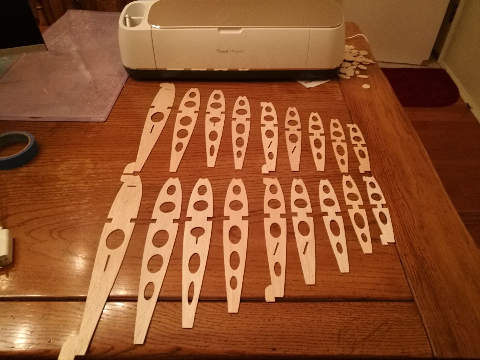

Yes - the latest model (the Maker) can cut balsa with the "knife blade" attachment (essentially a commercial x-acto blade) with ease. This model came out last year.

ExtraCGScott I just did a comparison of your rib #8 with what I extrapolated from the fuse side view. and I am pretty happy with the results.
Thank you for posting this, I'll have to try this with the cutting blade for my Silhouette.

Hi Alan,
Wow - looks like you matched nearly perfectly! Sheet 2 will be dropped in the mail tomorrow. Also, I would be happy to send you scans of all ribs, with dimensions so that you can recreate more efficiently accurate digital drawings with your software. What I am doing is rather archaic (basically tracing scans in power point - which is a pain in the butt, and likely not as accurate)!!!!
Here is my reproduction of rib #2, with the wing-jig knockoffs. Best, Scott

I finally got the full set of ribs for the GB Extra 300 setup in the Cricut program. I can now make identical copies of the originals - and quite quickly. In the spirit of Alan's efforts to contribute to this model - I would be happy to cut ribs out for people at cost of balsa (and a few bucks to partially cover price of replacement blades. Just send me a PM if you are in need!
