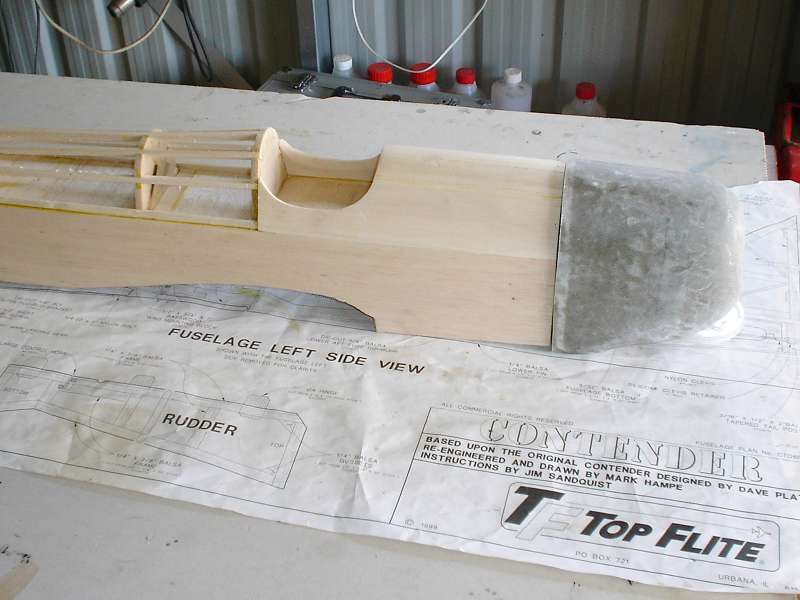

how did you glue in the forward deck sheeting?
I dry fit today and it looks like it curves around to fit onto the F-2D former.
It's also a little too large.

The forward and turtle deck sheeting were ca'd in. Little medium CA on the formers, and press hard for a few seconds! Then, I went back and brushed in some five minute epoxy around the joints for good measure. All of the fuse is glued with 30 min epoxy, formers and all. Just the top decks are ca'd on the fuse. Got everything hinged tonight, and balanced it. I will put the battery on top of the hatch, and that will balance it perfectly. All in all the thing weighs 6 pounds and 1 ounce. I think the .56 four stroke will do just fine on that! Here are some pics. Tomorrow I will install the battery and receiver, and hook the control surfaces up to the servos. Other than that, just a few decals and she's ready to fly! This was definitely a building bonanza, and I will never do it like this again. From now on, it's a little at a time! Believe me boys, the building is the easiest part! After that comes the fun. Covering, installing the radio gear, control surfaces, so on!

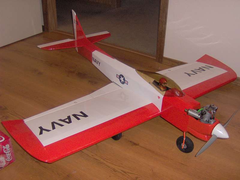

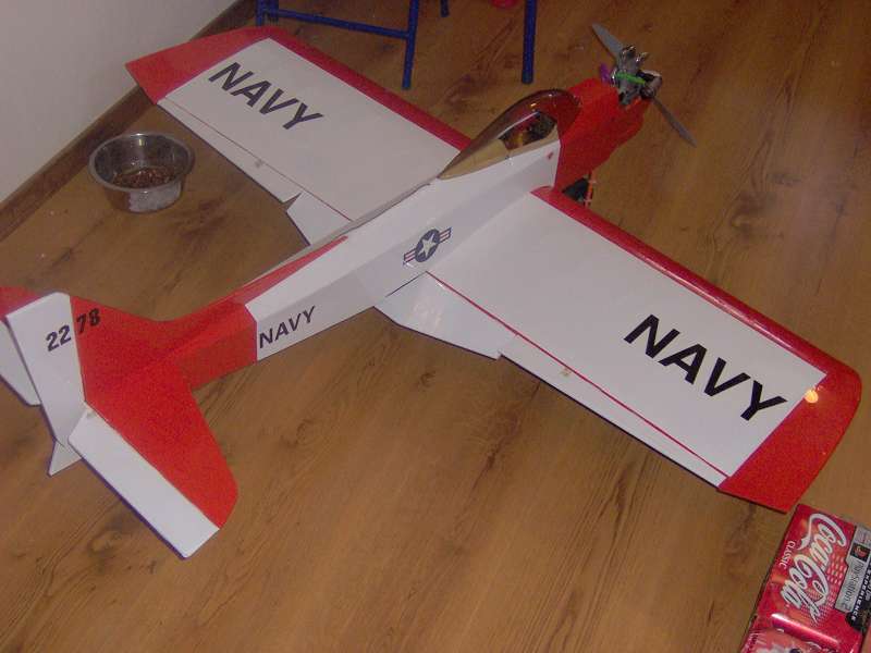

It's finally finished! I'd guess in the neighborhood of 45-60 hours. Not really sure, but we worked hard all week to get this thing finished up. Finally got all of the radio gear installed today, and lined up and working properly. Decals are on, and it looks like this:

It looks great. Congratulations. I've just got my covering scheme figured out on some 2 views. Now I'll have to warm up the irons!
What is that fuel tube you have along the front landing gear? Is it the breather/vent from the 4-stroke crankcase? Great idea.

Robert, yes, that is the crankcase breather line. I like to extend it as low as possible to keep all of that oil off of the covering! Makes for some oily tires, but those can be taken off and washed easily. I hate oily covering!
Jim, I used monocote. Ultracote might have been easier for this plane, considering all of the compound angles and curves. I think it shrinks better, but that's just what I've heard.

Well, I maidened the contender on new years eve. You guys will be so pleased with the way this thing flies. I just glides through the air effortlessly. The saito .56 is plenty of power on this bird. Gotta get used to the flap (have never flown a plane with flaps before). It will knife edge like a champ, lands great and predictible. The take off roll is long, though. Probably because I'm at the lower end on the engine, but add the flap in on take off and the roll is cut in half. Once flying, it has no bad tendencies that I saw. I flew it three or four times. Had only one incident. Deployed the flap into a 17 mph wind--not a good idea. it ballooned, I pulled the flap, and it started to stall at about 10 to 15 feet. I was able to catch it just enough to keep it from going in nose first. hard touch down, bent the nose gear just a little, but nothing two pairs of pliers couldn't fix! Other than that, it was a great first day!! No trim at all was needed. Set your control surfaces up at neutral, and go fly it!

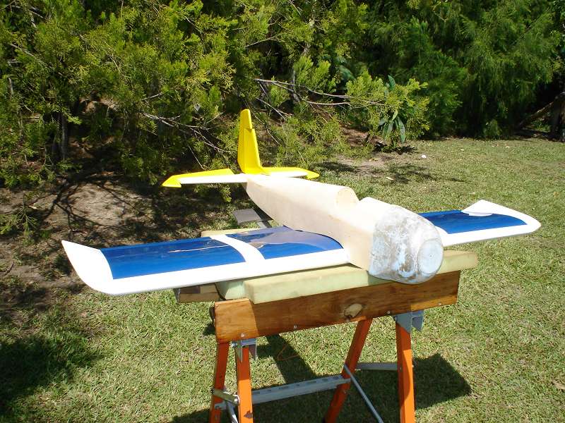

I have hopefully (after many problems) posted some images of the much modified Contender fuselage under construction. The moments are the same but I have made the fuse deeper and added the empenage from a Super Chipmunk with the aim of improving low speed knife edge performance.
Having visited Cafeen Man's incredible site I used his tips to build a cowl moulded on florist foam to enclose the engine.
