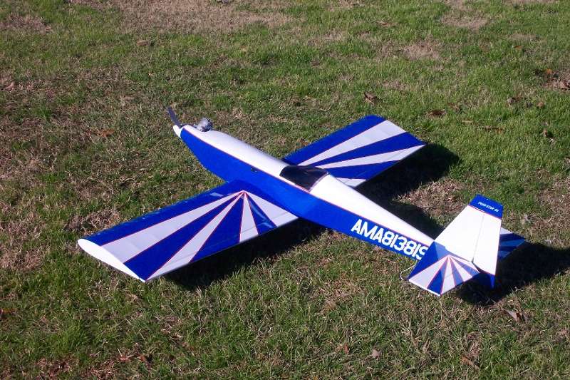

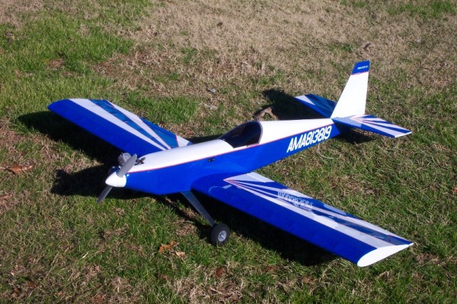

Join Date: May 2003
Location: Charlestown, IN
Posts: 585
RE: First kit mistake!!!!
Great job on that plane. I like the covering lay out.
I build as good as your planes look. LOL
I just dont take the time to cover one that nice.
