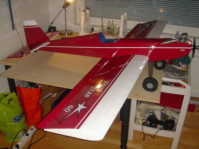

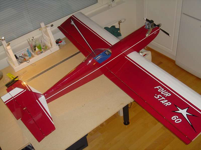

Well I finished my first kit tonight.
The build was pretty straight forward and it took only a few nights to have everything framed up.
Yesterday night I started to cover (First time I cover) and what I thought would be a time consuming ordeal turned out to be pretty fun.
I listened to many good advice here on RCU and got a good iron, a heat gun and plenty of razors and #11 blades (very much a must have.)
The covering took me two full nights of work and here's how it came out:
(The color is actually maroon, but it looks a bit brighter from the camera flash)
Now I only have radio install to complete and some general tinkering and completing tasks.

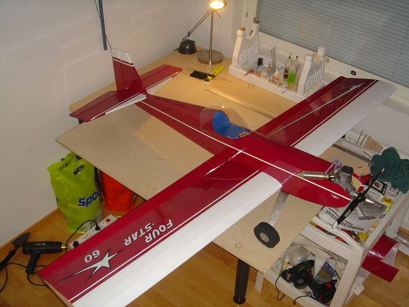

(It's Ultracote/Oracover, color is Maroon and it's like dark red (similair color to red wine), the pictures were taken in bad light though and the camera flash makes it look pink )
This is the color in natural light:
/Edit: One great advantage to Ultracote vs. Monocote is that the backing is paper.
This makes it easy to sketch patterns with a normal pencil, but the #1 advantage is that it's easy to separate the backing from the covering film!
I have a sheet of Monocote and it's litteraly taking me minutes to claw away that thin plastic backing!
After seeing and testing them both, I'm Ultracote all the way and I'm thinking for my next kit: Sig Lt-40 with an os.52 fs, covered in transparent blue and white, that would be pretty nice huh?

I cut the White to overlap the Red by 10mm (That's about 1/3 of an inch) and did the overlaps ontop of spanwise spars.
Two things:
-When covering open areas such as wing, turtle deck etc... tack the covering down around the edges and finally shrink with heat gun.
-When covering a flat surface such a balsa sheeting or ontop of covering, start in the middle and slide the iron towards the edges, pushing the air outwards to the edge (trapped air become bubbles). Try to keep the film-on-film to a minimum sice it's very difficult to get it smooth (I haven't tried solvent though)
Turtledeck was easy.
-Measure and cut a tapered piece that overlap down on the body by 10mm from the turtledeck to the last former. If measured properly, no final trimming is necessary after covering.
-Tack it on each side of the turtledeck, the at each side on F6 former (former closest to tail)
-Keep tacking spots on both sides of the turtledeck until everything is tacked down.
-Shrink the covering ontop of the deck with a heatgun and your done.
