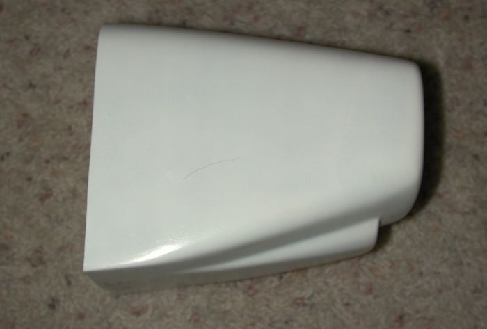

Sig Smith Mini Plane?
Scott,
On the left is a fiberglass specialities cowl for the smith miniplane. On the right is a fiberglass specialities cowl for the hog bipe. The dimensions on the hog bipe cowl are 4 1/4" width by 5 5/8" height.
Jim

Cowl for Hog Bipe
Hi Folks,
Thanks for all of the great information. I really like the looks of the Smith Mini Plane cowl verses the hog cowl by fiberglass specialties so that is why I was inquiring if the Mini Plane cowl could be utilized on a Hog.
I am going to try to use the mini plane cowl. I will let everyone know how it turns out.
Scott

Re: Cowl for Hog Bipe
Originally posted by scott hayden
Hi Folks,
Scott
Hi Folks,
Scott
I have received my Smith Mini Plane cowl and it will fit the Hog Bipe with modifications. I will post pictures within the next month.
Scott

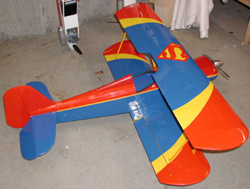

Join Date: Oct 2002
Location: Lehi,
UT
Posts: 35
Scott,
I am just finishing my Smith, I am covering it in a "Superman" scheme with the red S and everything
As far as engines go, I put a YS63 Four Stroke in it mounted upside down. I don't know of any others that would run well this way but a Surp' might. The YS pressurized system just seems to run well at any angle. I only hade to make a small cutout through the lower air intake vent on the stock Smith ABS cowell to accomodate the engine. I rigged a "pitts" style muffler in there sideways and the exhaust comes out almost right where it should according to the full size machine.
MODS:
I too, added dual ailerons on the main wing.
I also doweled the wing bolt lugs to the side of the fuse with hardwood dowells, I just didn't like a surface glue only there.
I also fiberglassed the lading gear strips and Z bracket stips acrossed both sides of the wire rather than just using epoxy to fill the gap. It allowed me to make it much stonger and easier to finish.
I used the Du-Bro pinned hinges rather than the Sig ones it comes with.
I beefed up the areas where the hinges go through on the vertical stab and rudder. I also made the rudder about 3/4 inch longer than the plans indicate.
I did add shear webbing to the main wings. And I added to 1/4 inch hardwood spares one in front of and one behind the servo bucket area on the bottom wing, they go out to the end of the full wing sheeting.
I made a fuel tank saddle for a Hayes 10 oz. tank so I don' t have to pad it so much in there.
I used a scale tail wheel steering assembly instead of the supplied one.
I am very excited about putting this little guy in the air. I think I will be able to transport it without taking it apart, cool. It should climb very well with that engine and an 11x8 prop.
Good Luck!
Adam

Pictures as promised...
Well, here are a couple of pictures of the completed Smith Mini I just finished.... And then some post-maiden-flight pictures as well :-)
First: An overall view from the side.
