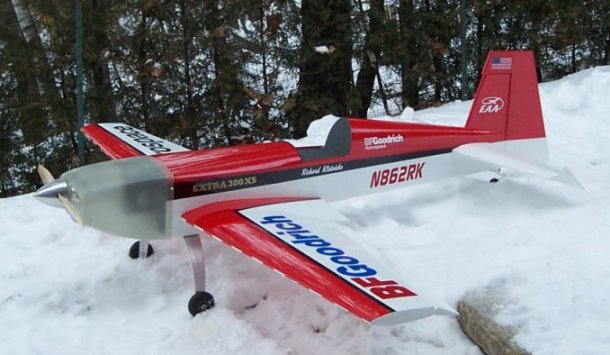

Check it out guys, I'm almost there...

Old 01-23-2002, 02:36 AM
tailskid
My Feedback: (34)
tailskid's Avatar
Join Date: Nov 2001
Location: Tolleson, AZ
Posts: 9,552
Received 7 Likes on 7 Posts
Default Snow???
What the heck is that white stuff around the plane? Is it already in Plane Heaven????
Jerry
Running and ducking for cover....
Old 01-23-2002, 02:53 AM
Mendes
Mendes's Avatar
Join Date: Jan 2002
Location: Ottawa, ON, CANADA
Posts: 476
Default Midwest 27%EXTRA300
It's not in plane heaven just yet, won't be long though...just after the first turn away from the pits. Uh oh shouldn't have used that Super Tigre 3000.
