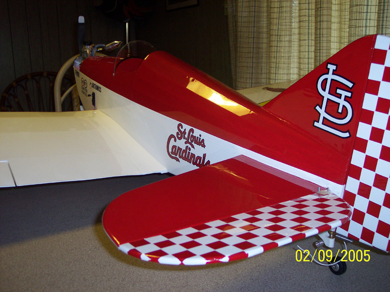

I built a Slow Poke 40 earlier this year. I picked up the kit when I bought out somebody getting out of the hobby. Originally I hadn't planned on building it. But after talking to a few here on RCU I went ahead and built. After getting this bird in the air I knew it was well worth the effort. I love flying this plane. I power it with a OS 52 4-stroke. It will take off on 1/3 throttle and I can fly for 22-24 minutes on a tank of fuel!!
You are correct when say that it builds tail heavy. I had heard of people that had put in 8+ oz of weight in the nose to balance it. I cut some more lightening holes in the tail and kept the weight as low as I could get it. The receiver and battery are located under the fuel tank. To balance mine I only needed 2 oz of weight in the nose.
When you fly you notice a bit of adverse yaw when you use your ailerons, but with fuselage as short as this is it should be expected. I mix in rudder with my ailerons and it does just fine. It will float forever when it comes time to land it!! My favorite move with this plane is a stall turn. With a rudder as big as this had the rudder really just swaps ends with the nose when you throw the rudder over!!!
You are in for a great treat when you build this plane. Here are a few pics of mine.
