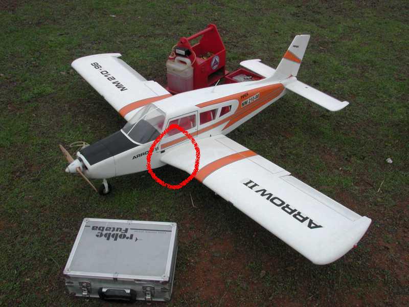

I've enclosed a picture of an Arrow II that shows the wing area that I'm talking about.
From what I can gather and from how it looks in the photo, this part is built onto the wing and not the fuselage.
When you say that you're probably going to fit the wings to the fuselage when you build them, do you mean that you intend to permanently attach the wings?

Lego man, is that your model, it looks good? im not going to permenantly attach the wings. but they will be attached when i build the inner leading edge just to keep the gap to a minimum. i know it should be attached to the wings but the instructions are only a guideline in my opinion.
I have half of the planking done, it didnt go too bad so far. i just tapered the ends and its working out grand.

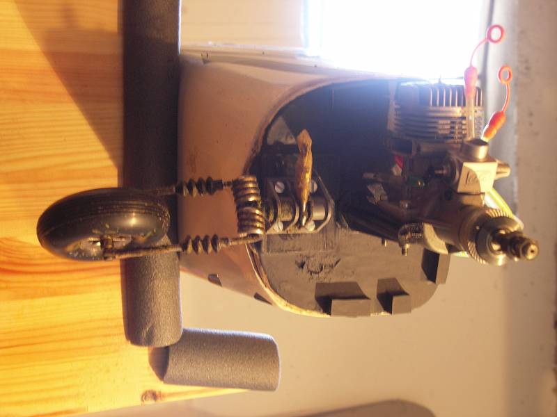

3.) Mounting of the nose-wheel:
Just throw the nose wheel, which is provided in the kit into the trash-box! I used an additional part with double-suspension. It is not that hard and it`s not a good solution to fix the nylon hinge of the wheel with a metal srew. I think the nylon material is to weak.

Nose wheel:
I have to clarify that my model has not a retractible gear. I have attached some pictures of my construction. Picture 1 shows you the first nose wheel I used, picture 2 is the newest version (only the changed position of the mount for the nose wheel, the new landing gear isn`t ready so far). I had to change it because I want to use another muffler. Therefore version no. 2 is still under construction. For version no. 1 I used the nylon mount (grey part that is screwed at the fire wall) but I bought an additional nose wheel which has two shanks (I`m not shure if "shanks" has the correct meaning but have a look at picture 1) I solded a metal hinge to the wire and then I covered the hinge with ABS-plastic and a thin coat of epoxy. When I connected the nose wheel with the servo of the steering rudder I realized that the servo had real problems! That`s why I installed a seperate servo for the nose wheel.

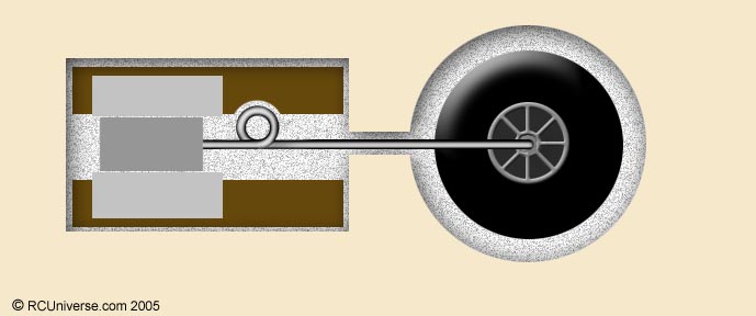

Nose wheel:
If you are still interested in using a retractible gear: visit the homepage of Top Flite (www.top-flite.com) They have released a kit of the Piper Arrow II. You can download the manual as a .pdf-file. The manual shows the mounting of Robart retracts. Maybe you will be inspired by these pictures!
British Airways livery is nice. I firstly decided to paint my model in colours of Lufthansa or LTU but than I`ve chosen the marks of a zebra. Looks like a safari-plane.
Cheers,
Michael
P.S.:
I`ve seen that I could not upload the drawings of the plan and of the nose wheel because they are .tif-documents. I hope you`ll see everything about the nose wheel on the pictures!

I don`t think that it is that hard to build the Aviomodelli Piper. I started my Arrow in October 2003 and finished it in February 2004. I only worked in the evenings 2-3 times a week. So far I`ve already built ARF`s
The wing is made of styro an abachi, you only have to cut out the ailerons and flaps. The fuselage is real work but the wooden parts fit very, very good!
For detail works you will need some experience e.g. mounting the front wheel or fitting the horizontal stabilizer but if you have already built a J-3 Cub in 1:5 I think it could work!
Are you really shure that your friends are talking about the Aviomedelli Piper? Top Flite also offers a Piper Arrow. I`ve seen the kit and I think for that kit you must be an expert.
Just have a look at www.fmv-leingarten.de in "Pictures" you can see my Arrow II in its "safari outfit"
Regards Michael [8D]
