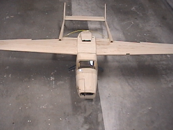

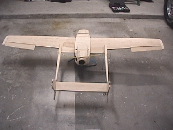

Hi gents,
I am currently building an old Marutaka / Royal Cessna Skymaster kit. I will soon need to install the windshield and side windows. I was hoping that some of you may have some suggestions on how to install these pieces in general so it looks nice. I've spent many hours building this kit and don't want to ruin the look by simply gluing the windows to the outer fuse side. There's got to be a better, cleaner way. I must note that this airplane will have a fiberglass and paint finish, if that makes a difference.
I've attached some pics. Any suggestions are much appreciated.

RE: Installing windshield and windows - Marutaka Skymaster
I used RC56 glue to put mine in. The side window were cut from flat stock slightly over size and sanded until they fit tightly in the window cut outs. Put them in and then push them from the inside until they are flush with the fuselage sides. This leaves a little edge on the inside to glue to. I put a few drops in at first and allowed those to dry before glueing the rest of the window. I did one side at a time so the glue would flow and pool around the edges with the fuselage layed on its side with the window being glued, down on the workbench. Glue from the inside of the model. I used the same technique for the windscreen. Taping and glued a few small dots on the top and bottom letting them dry, and then glue each side and allowing that to dry. If I try and do it all at once I will make a mess of it every time. My Skymaster is an old Royal kit and it is also fiberglassed and painted. I put the windows in after I painted the model.. I used tinted plastic for the side windows so the glue doesnt show up unless you get right up on the model. RC56 drys crystal clear and is somewhat flexable after it drys. There are a few pic of mine in my gallery. If this doesn't make sense let me know what doesn't and I'll try to be more detailed in an email
