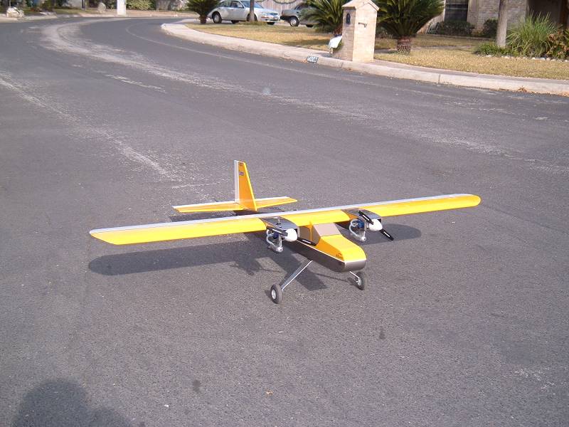

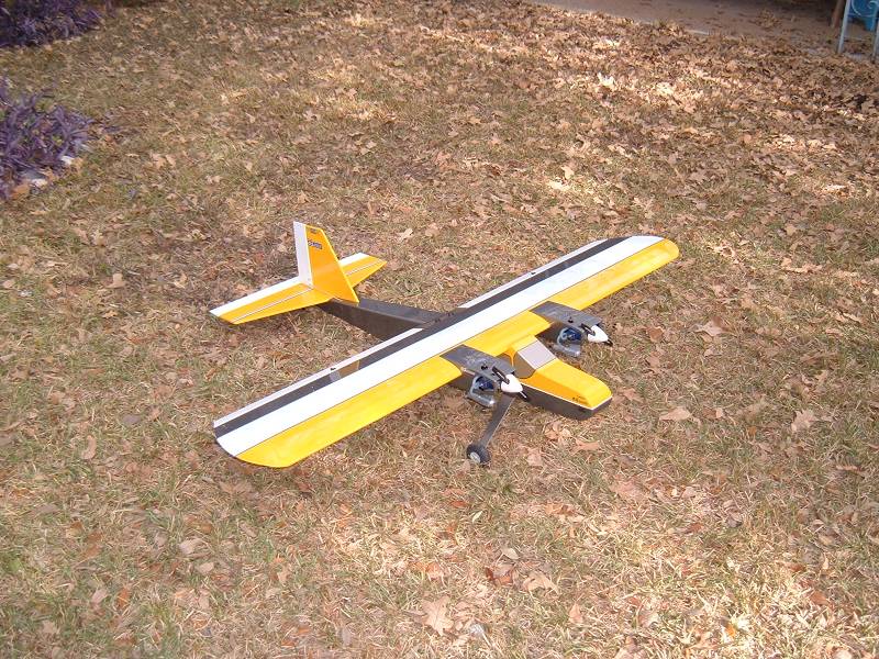

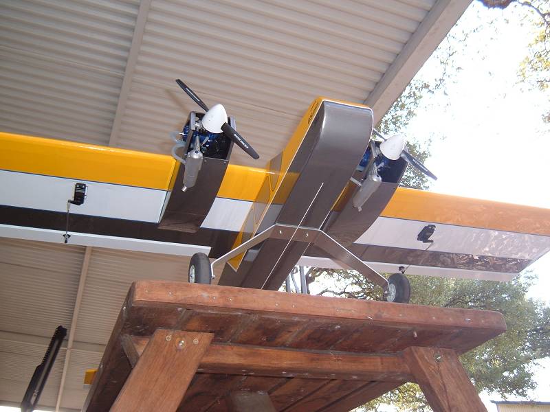

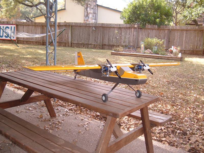

Here is my latest creation...
It is a Sig LT-25 kit that I modified into a twin. I removed all dihedral, so the wing is flat. I installed one servo for each aileron, and converted the wing to attach with bolts instead of rubber bands. I am using two O.S. LA-.15's, with Master Airscrew 8 X 4 props, and two 6 oz. tanks as well as two mini servos for throttles. It balances perfectly with an 1100 mah NiCd Rx battery all the forward in the nose. All up dry weight is 5 lbs., 2 oz.
It flies like a trainer with two engines...duh? I have 7 flights on it without any engine out situations yet. It will easily take off at half throttle.
Thanks for looking.
Thanks for looking.

RE: SIG LT-25 kit bashed into twin engine
diegoconsafos, beautiful!!!!
I am having some wings without fuselage and have been considering using them for a twin, so if you have some pics from the building it would be very much appreciated.

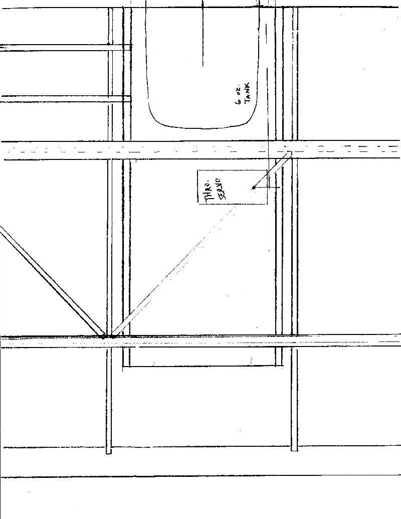

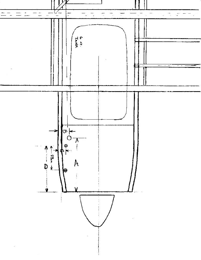

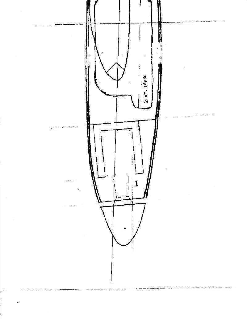

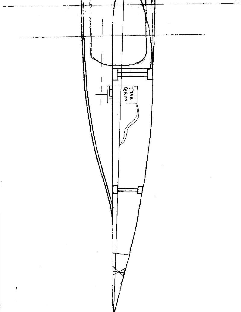

Here are my very crude hand-drawn "plans" for the nacelles. There are two views: side view and top view. Each view has two parts that need to be printed and joined together. Also a few more pics. Let me know if you have any questions.
Jay
Jay
w8ye,
Out thrust: 4 degrees each engine. (Right engine has right thrust & left has left thrust)
Down thrust: 4 degrees each engine. Original plans show 6 degrees of down thrust with one engine.
I believe mine should have more down thrust. If I trim it for level flight at half throttle, then go to 3/4 throttle, it wants to climb quite a bit. As I understand it, this is characteristic of a flat bottom airfoil and can be somewhat corrected by using more down thrust. Anyone disagree with this?
Also, next time I fly I intend on partially filling one tank only, so I can see how it will fly with one engine. I will let you know what happens...
Yikes!
Jay
Yikes!
Jay

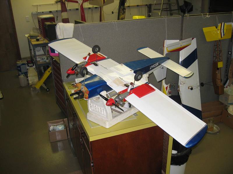

Jay,
The beat up, banged up and broken Cherokee seemed like a candidate for another twin experiment. Had two 25’s that were previously on the Kadet Senior but inadequate to fly with any reserve power (10.5 pounds). The Cherokee center engine mount was left in place just in case more oomph is needed. The engines are snug against the wing. Stability is better if the engines are further forward but alas a lack of building skills interfered with construction of nacelles. Your nacelles look good and a ideas will be borrowed next time. Four-ounce oval tanks (glue bottles) fit inside the tank covers behind the spar. The plain bearing engines are reasonably thrifty but I should make a timed full throttle run.
Looks like it is going to balance OK.
The Kadet is being flown with 45’s and the center engine has not been cranked in 30 flights.
Bill
Bill
Bill,
Awesome projects. Is that red and white wing on the bottom right from the Kadet? And do you have two tanks for each engine? Or are the two tanks in the center for the center engine in the fuselage? What engines do you have on the Cherokee? The Kadet? Have you test flown the Cherokee yet? Do I ask too many questions?
Later.
Jay
Later.
Jay
Jay,
I have not flown the Cherokee. Someone else crashed it while single engine. I started making it a twin. Your inspiration helped finish building the firewalls, tank covers and repairing crash damage. The Cherokee has OS 25 plain bearing engines. Now that I know it will balance without center engine I am looking for a cowl to cover the front end. Didn’t weight it but it feels light.
The red wing is from the Kadet with three engines. The tanks service the outboard engines. Started with 25 size outboard engines and now have 45’s. It will barely fly on 25 outboards only and is a beast with one 25 outboard only. Flies well with one 45 outboard. Took off the driveway once with 45’s and a switch set to simulated engine shutdown by mistake. Have asphalt rash on the right wing and almost got a driveway light. Will get more pictures soon.
Bill
Bill
