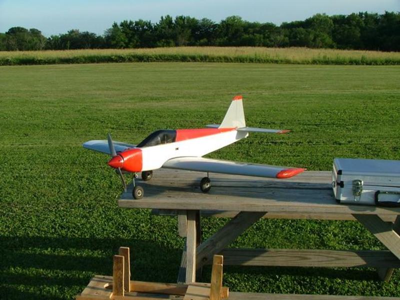

For what its worth my old Kougar has a GMS 47 in it with the
Tower tuned muffler. It swings an APC 10 X 7 at around 13800
rpm and hauls the old Kougar around with authority.
The only other plane as fast in our club is a Direct Connection
F-20 with a YS45 on it. And I can usually keep up with him.
Here is a pic of mine. Its not too pretty but flies good.
Mike Hammer

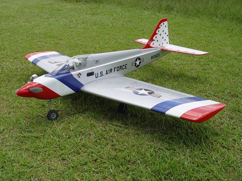

I agree with everything said about the Kougar. It’s one great design. It looks good, flies great, it’s great in the wind, can come in slow or it can come in just about as hot as you can handle it, and when it touches down, it’s as if the wheels have Velcro. I get more complements about how great my landings are with this plane than with all my other planes combined. But it’s not really me, it’s the plane.
Sense everyone else is posting photos of their Kougars, here’s a recent shot of mine. I won this kit in a raffle back in ’83. The engine is also the same vintage being an O.S 50FSR. Perfect engine/plane combination.

Nice model, Jim.
How'd you balance it? I put a 50 FSR in a 40 size Super Kaos and had to get a special battery pack made (two cells end-to-end and side by side, IOW, narrow) to fit in the tail.
The 50 FSR is a heavy sucker. But, gawd, the power...

Steve,
Thanks for the complement. I balanced it as called out in the documentation. I believe that it was 1/2 inch back from the leading edge as measured at the wing tip. The difference could be that the Kougar is not a light bird. I believe that mine weighs in at around 6 pounds. But that 50FSR has more than enough power for that heavy of a plane.

6 pounds???
Wow; mine weighs just under 5. You must have some heavy wood back in your tail...
BTW, you do know that Sig has discontinued this puppy? Once the available supply is gone, we'll be paying scalper's prices. I almost picked a NIB kit up at a hobby shop the other day; until I saw he had it marked at list price.

Steve,
I just checked and yes, my Kougar weighs in at exactly 6 pounds. As I remember, most Kougars were a bit on the heave side. I amazes me that you were able to bring in your Kougar under 5 pounds. My hat is off to you and your building skills.
To get back to the original question, my only recommendation for the ailerons is to make sure that you use enough hinges. Use as least four if not five hinges per aileron. I had problems with flutter with mine because the wood used in the ailerons was a little too soft for the number of hinges that I was using. I had to remove the first set of ailerons and replace them with ailerons made from harder wood and add more hinges (aileron augmentation, larger and firmer).

Thanks; but I imagine it had more to do with the excellent, light wood in my kit than anything else. This one had the best wood I've ever seen in a kit. Also, I have a tongue muffler than weighs next to nothing, as opposed to the usual "can" muffler. Nice and light, but obnoxiously loud, and messy.
Dennis, while I agree with the extra hinges deal, sealing the gap will do more to prevent flutter than anything else on a plane this size. Assuming, of course, your ailerons are sufficiently sturdy, as Jim mentioned.
