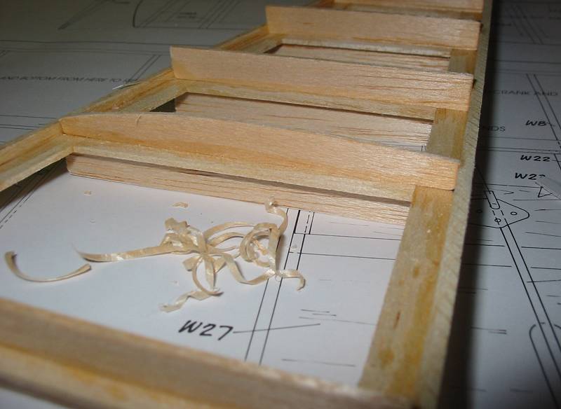

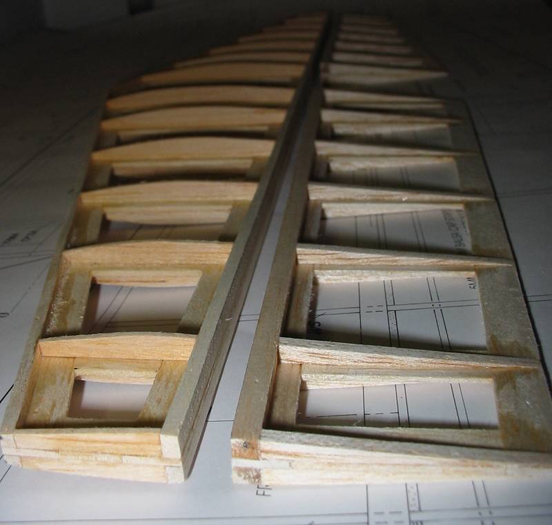

I measured the tip of the horizontal stabilizer at just a little under 1/2" thick; the root of the horizontal stabilizer (where the stab connects to the fuselage) is about 3/4" thick. I remember that the "ribs" of the stab (and vertical stab as well) were rather tricky to do. They are not tradictional ribs; they are rectangular pieces which are glued into place and then sanded/carved to an airfoil shape - with a taper! A good sanding block is a must, and a razor plane certainly helps. Do not put too strong a side-force or the ribs shatter (I had to re-glue a few of them as I sanded).

Wow that's a pretty thick cross-section for those stabs. Or at least, it seems to be to me.

The Airsail Chipmunk is actually pretty big, 69" wingspan. Mine came out at 8.5 lbs. As for the stab thickness, it sounds bigger than it looks, that thickness is at the thickess point of the airfoil.
