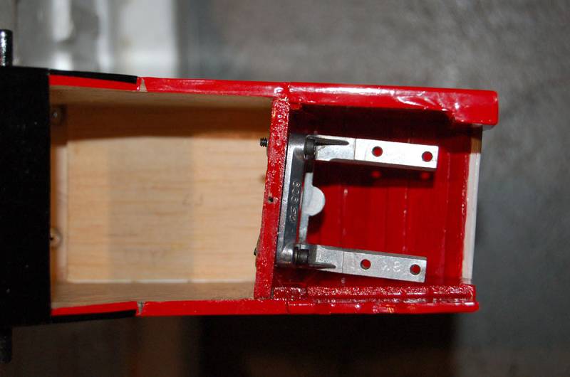

I am building a little House of Balsa Super Decathlon which has an astounding 3/16" offset in the firewall. After some internal debate I went with the design.
