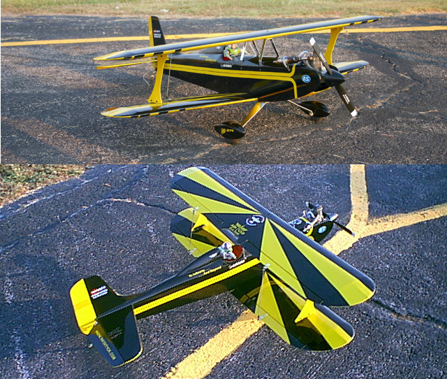

I don't know why the rumors are running rampant about Monkote's quality is in the toilet. To be honest with you, I think it's a scapegoat. It's easy to blame the quality of the covering when you get a bad covering job, instead of somebody saying they can't cover well. I have seen this in a lot of people. They will swear to the end of the earth that they hate Monokote and will never use it again, when they had one bad covering job with it. I used to have horrible covering jobs too, but I got better at it with practice. It's like anything else in this hobby, the more you practice the better you get. So what I really want to put out is that I challange anybody that is going to trash Monokote to be honest with themself and the rest of us and decide if it's the Monokote that caused the problem, of if it's the fact that they need get better at covering.
Here are a few pictures of recent planes covered in Monokote, no problems at all to report with it.
