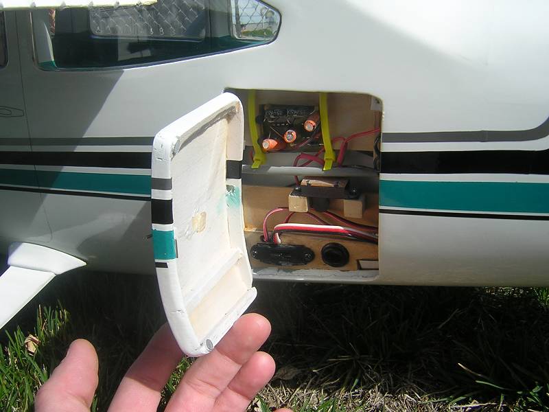

Nice build thread. Here's how I did my luggage door, it hides my switches, light controls, and fueler. I hinged it with a nylon hinge, and it's held shut by rare earth magnets. I also made a magnetic hatch for acces to the tail controls. The last two pics show how I made my front wheel pant removable for strut service. I fly my 182 with a Magnum 91 inverted, the exhaust comes out of the right cowl flap using a Dubro silicone extension. I put it around at 1/3 throttle most of the time. More than enough power. Full meal deal on lights, including NAV, rotating beacon, and landing lights all controlled with TX switches. I also imbedded a voltwatch into the dash, so the dash also has its own lights. I spent over 300 hours on this build, but it was worth it.

That's how I plan on doing my door Deadeye.

Deadeye that is a great job on the door! thanks for posting pics so when I build mine I can use them for reference. Tookie just stick with it I am making a ton of mistakes on my 51 build, it is what makes each of our planes unique.
