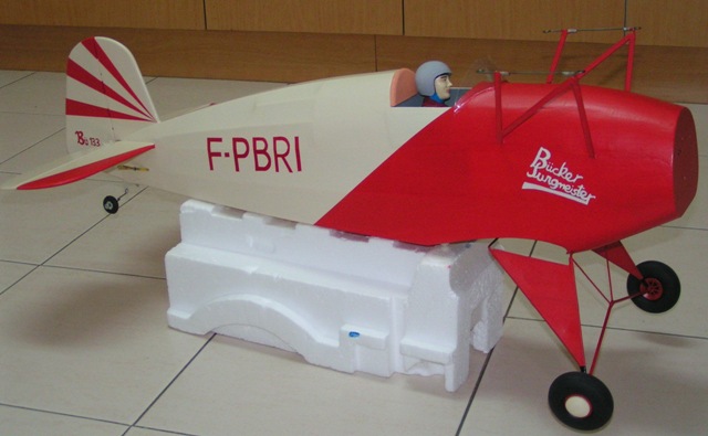

Beautiful Whitehead Jungmeister, EF. From all the magazines I've read over the years, Gordon Whitehead's scale model construction articles are my absolute favorites. They do not have tons of laborious detail, but they have good outlines with just enough scale touches, and he writes so well about all the fun he has with them. But I have yet to build one! Yours is a real inspiration, EF, thanks for the pics. Jim

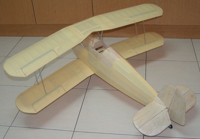

Thanks for the warm words!
I can honestly say a small Gordon Whitehead sport-scale design is an excellent way to go.
I've built to date, his Tiger Moth (48" span, OS 20FP engine) and his Hawker Hind (48" span, OS 26 FS) both of which would easily take a 30 FS.
Both were a joy to build and fly.
BTW I plan to build second versions of both – I fancy a yellow-with-aluminum-nose Hawker, and another Tiger Moth in red-and-silver (just can't have enough Moths…), not to mention his slightly larger D-VII and even larger Gamecock plans waiting.
I also built Gordon's little Avro 504K, flew well but a little too sensitive to winds, but this may have been just an impression, or a wing loading just too low...
My only major modification from the J' plan was to have both the wings attached with nylon bolts in place of the rubber bands.
The satisfaction from a good plan-build is something that has to be experienced!

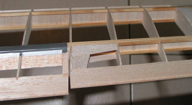

RE: Small Bipe kit
With regards to the wing bolt modification – it's quite simple really and I hope the pics clarify it, however basically what I did was the following
(I've gone into a lot of detail in an effort to help, and it is really easier than it may seem from reading all this):
For the bottom wing – I installed a hardwood cross-piece in the fuselage above the T.E. and tapped two 10-32 holes.
At the front it is a little tricky – although the idea is to simply install a dowel in the wing L.E. center and make a corresponding hole in the ply fuselage former, the design is such that there is very little material left under the hole if you are not careful, but if you are then it is OK and also the bottom balsa block adds a lot and the whole area then becomes very strong.
So that's what I did and I'll give you a little tip:
When building, don't build the wing, then the fuselage, and then try mating them, rather - finish the wing first, including the L.E. dowel, and then prepare the hole in the ply former at the correct position according to the plan and your wing (put the dowel about 2 mm higher than on the wing section cord, to "gain" a little material under the hole in the ply fuse former).
Next, wrap the wing center section with nylon film, install the ply former on it with the dowel engaged in the hole, and continue positioning the fuse sides on the wing and assemble the basic fuselage structure on the bottom wing. You'll be amazed how accurate a wing-fuse fit you'll get and how the whole wing-fuse alignment will be accurate and easy to achieve. Remember these small bipes have zero tolerance to inaccuracies in construction and alignment (and that's why I practice building them once in a while – then my larger models really come out good).
At the bottom of the T.E. I put two 1/32" ply pieces to take the pressure of the bolts. You can put one piece, but "think light" on such a model, all along the construction.
Finally, I built using some balsa T.E. section and a bit of 1/32" ply, a small "receptacle" or "raised slot" for accepting the aft l/g wire. The gear engages in that when you assemble everything. Use epoxy here, and the ply with grain perpendicular to the direction of the wire/slot. Do use very soft wheels since that would be the only means of shock absorbing.
Now for that top wing: I added four hardwood blocks in the wing (actually made of sandwiched 1/4" ply pieces) which then accepted four 10-32 tapped holes.
The cabanes – I simply took their edges that are supposed to remain straight and accept the rubber bands, and rolled them into horizontal circles such that a 10-32 nylon bolt would just go through. The aft set is easy, the front is tight because it is very close to the wing L.E. and at that area the section bottom starts to curve up a bit. Tight, but can be done. See pics.
So now you have a model assembled with six bolts but it assembles quickly and also, you need not take it apart often, it is small. The benefit of all this is not just looks, it's also the fact that every time you assemble the model, it is exactly the same, and we mentioned these little bipes don't tolerate mis-alignments...
Use nylon bolts that have the slot recessed, or otherwise there's the risk of the screw driver perforating your wing...
One more mod, if anyone is still reading all this, I added shear webs between top and bottom, fore and aft spars, from 1/16" balsa, vertical grain (see pic).
This I did for about 75% of the span (from wing root to one rib bay after the aileron break). Not sure it is necessary, I trust Gordon that if it isn't on the plan it is not mandatory, but I prefer it, even though I fly rather basic aerobatics. Maybe it gives more resistance to wing warping over time...
Hope it all made sense, if not, don't hesitate to ask.

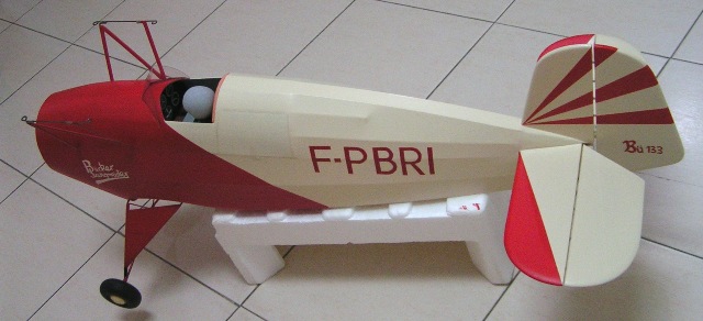

Well, now I have to wait for this hot summer to cool off a bit before test flying, and also to run the engine on a bench as it hasn't flown quite some time.
If tests are successful, a dummy engine will follow, to complete this little sport scaler.
BTW, came out balanced "as built".

Congratulations on a very nice GW Bücker Jungmeister EF!
Gordon's plans are excellent and I have a number of them. So far I have only built the AVRO 504, but hope to complete a Krier Kraft of his design during the coming year. Many of his plans are available from the [link=http://www.rcmmagazine.com/store/store-plans.html?sid=0001oR0FPZ7JoG0U8g0r2J3]RCM Plans Service[/link] or [link=https://sslrelay.com/s119033911.oneandoneshop.co.uk/sess/utn;jsessionid=1546b18c87257f2/shopdata/index.shopscript]Traplet[/link] in the U.K.
As for wing attachment, in one of the pictures below the arrangement that Gordon used for all sport scale cabanes from the Avro 504 onwards is shown. Nice and simple! If you have an interest in Gordon Whitehead's designs you relly should try to obtian a copy of his book, "Radio Control Scale Models for Everyday Flying". It contains a lot of information on how to build smaller scale models and I consider the book my model aircraft building bible. It is long out of print, but fortunately it has to a large extent been republished as a series of articles in the British [link=http://www.modelactivitypress.com/fs_framesetbi.htm]Flying Scale Models[/link] magazine.
